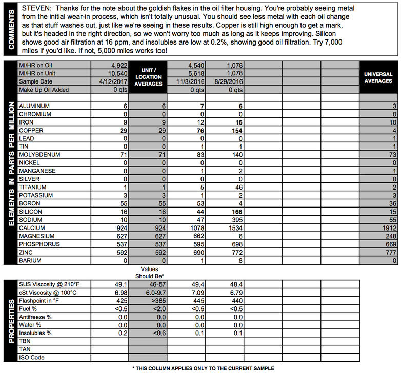

Here is my UOA from Blackstone (my 3rd oil change since purchasing my '16 TE in August, 2016). Blackstone doesn't seem to be too concerned about the flakes in the oil filter housing -- at least not yet.
Like someone mentioned, I have the receipts for every oil/filter used to date, along with a UOA at every oil change so far. I'm feeling a little better now.
My next concern, Blackstone comments about going to a 7,000-mile OCI next... when Toyota states 10,000-mile OCI. I'm hoping the Mobil 1 0W-20 AFE in there now can handle a 10,000-mile OCI.
