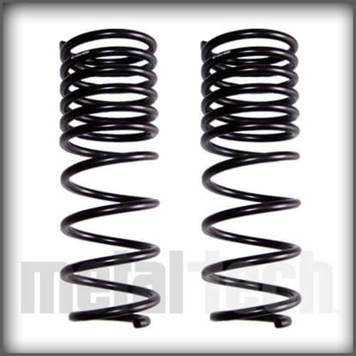

Did you buy the kit from them and was it the right one? Only other thing I would think of...any chance you can take a picture of the rear springs to show if they installed them upside down? I am pretty sure the pre-loaded portion of coil has to go on top.
It isn't due to being installed upside-down. That is the result of running HD springs with stock rear weight... it is a dual rate spring designed for a base rate of an extra 125lbs at least in addition to a 3" rear lift. No rear bumper or some really heavy storage solution... you are going to stink bug it!

Ok. I have their first gen dual rate HD rear springs and they came with all sorts of warnings about running without constant load and they were a bear to install due to being 4" of lift. The ones on their site now seem to be a new version that says they have improved the spring to allow for the same travel and loading as the old HD springs in a 3" lift spring. Hope you get it sorted out!
