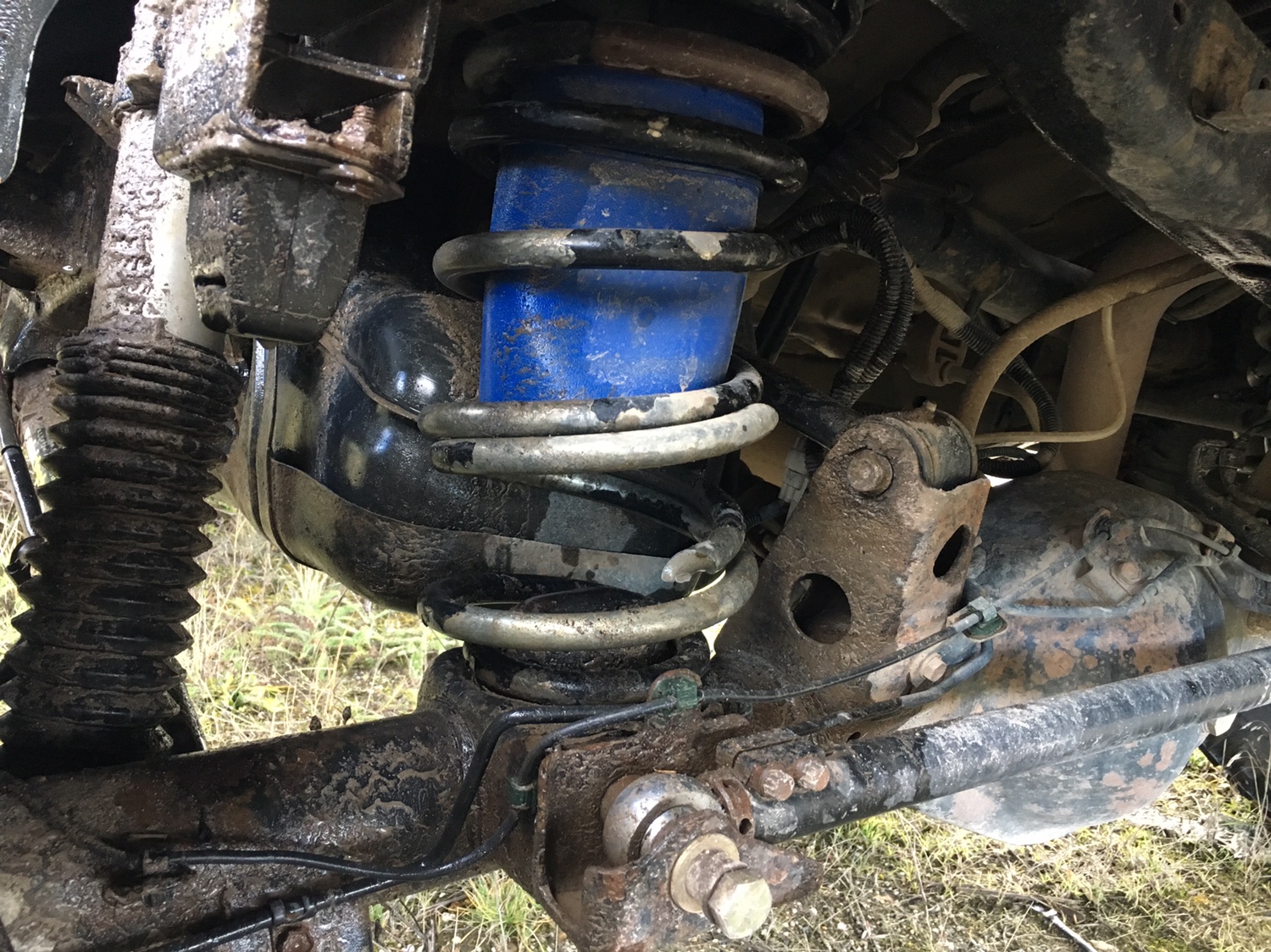

Metaltech coil defective powder coating.
dereky
Anyone had this issue literally days after install?
Only 1 coil did it. The other if I recall correctly is totally fine.
Waiting to see what they will do. Coatings aren’t covered. Steel integrity is. But this is not normal even if the coating isn’t covered.
I had a closer look at passenger one. It’s the same.

Update to this thread. Metaltech 4x4 would not do anything about the powder coat having come off in such short time. But now 1 coil looks like this!!!
First time I've ever seen a coil break....

looks like they are gonna replace your coil now. let us know if they replace it. I was gonna say that they might of used a compressor and chipped the first pic. but, after the failure of the whole coil and break it looks like a bad pc job or just bad metal to begin with.
