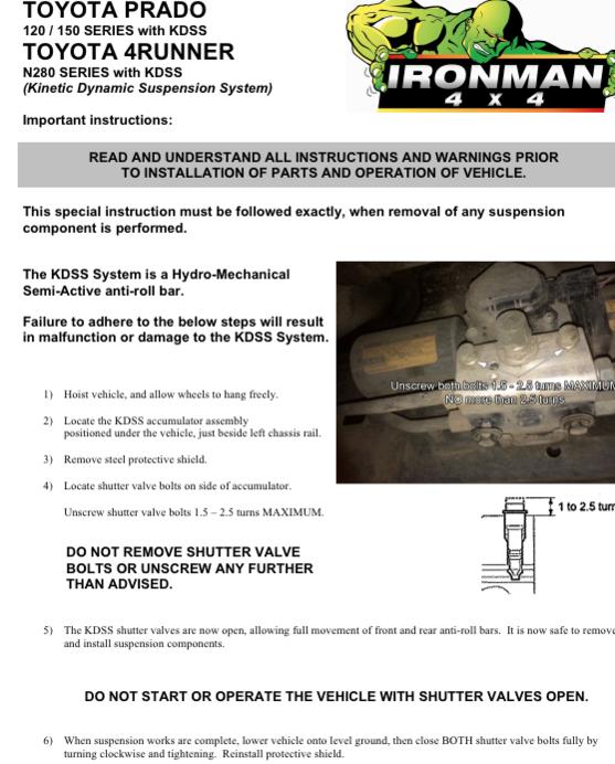

Hello all I'm finishing up my studying of lifting a 4runner and metaltech just posted on their website on how to disable the KDSS on our 4runners so that we can install our parts.
KDSS%20Instructions%20Prado_4Runner.pdf
My question is how many of you disabled your KDSS by opening the valves when you installed your lifts? I have access to a vehicle lift when I install so opening the valves might be easier than trying to hold everything in place. I've read of people using ratchet straps or a jackstand to keep kdss components from moving during install but how many of you have disabled the kdss by opening the valves?
On the land cruiser forums this seems to be the common method to lift a kdss equiped vehicle.
My biggest concern is screwing up the KDSS system by over loosening those screws.
Seems like opening the KDSS valves and shaking the vehicle back and forth allowing the kdss to reset then tightening the valves

Yea I've taken my kings out a few times and never released the KDSS. You can leave the sway bar attached too. Just disconnect your outer tie rods to allow you to get the coilover in. Use a jack to push up on the KDSS piston on the opposite side you are working on. That will force the sway bar down on the side you are working on, and push the LCA further downward. Its actually pretty easy on the ground with stands and a floor jack.

I've obviously seen many people use the floor jack / stands method with what seems to be success, but there's something intuitively correct about releasing pressure on a hydraulic system before working on components connected to it.
I wonder if any toyota mechanics / dealership types here can confirm or deny what the OEM company line is?

This, no need to disconnect or open any part of the kdss system.

The pistons are always pressurized and push down. The reason is that they use accumulators - which is a fancy term for pressurized overflow reservoirs - very similar to how a remote reservoir on a shock works. When the piston compresses the shaft of the piston takes up some of the volume inside the cylinder. The oil volume has to go somewhere. Where it goes is into a reservoir called an accumulator. The accumulator has a bladder inside that separates compressed air from the oil. This is the same function that the floating piston does in a shock - if you ever see the term IFP.
The result of this system is that the KDSS cylinders are always under pressure from that gas charge in the accumulator. IIRC the charge is about 500psi. I think the calculation results in something like 300lb of force down on the bottom of the piston. Exactly like a pressurized shock. The primary difference here is that the piston diameter on the KDSS cylinder is a lot larger. The cross sectional area of the piston shaft multiplied by the oil pressure gives you the force. Since the KDSS cylinder is under more pressure (shocks are typically 2-300psi) and has a larger piston, the force is higher. But in concept it's exactly the same thing.
It should not be bled for almost any reason or have the pressure relieved. Just like you would not remove the pressure from your shocks for work other than opening it up to work on the insides, you should not need to do anything with KDSS system for work other than internal work on the pressurized system. It's completely fine to let them extend to the max point and bottom out while you're doing other stuff. Then compress back to get your sway bar attached. It's no different from what you do when you install a rear shock. Just more force.
Hope that helps.
Also FWIW you could relieve the pressure - but it'll be a big PITA to get it back. Where shocks use a reservoir with an external schrader valve for pressurizing with nitrogen, the KDSS accumulators have no such external gas pressurization option. They have an air chamber that is fixed in volume and the oil is pressurized into the system. Most of us don't have a high pressure oil pump.
Hope that helps.
So don't mess with the KDSS valves is your recommendation
Yep. That's the short answer. And you don't have to hold the piston compressed. You can just push it back when you're done. Or you can use a strap to keep it compressed. Either way works just fine.
