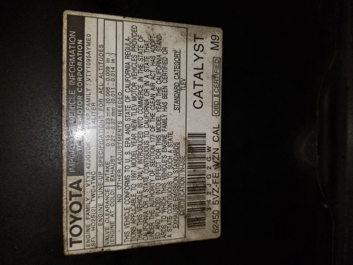

MF Cat. Any luck with NYS inspection? Getting conflicting information. Primarily for those who have to pass NYS insp. Thanks.
If it has a CARB number on it, and is certified for your specific engine family it should pass. Is your rig CA or 49 state emissions?

I think it says on a sticker on the hood but also if you get underneath and check if you have 2 catalytic converters (CA spec) or one (fed spec)
I'll have another look under the hood then. Like i said i was told that by someone who knows more than me.. I'll have a look for the sticker. I'll report back with my findings.

Put your VIN into Toyota's official vehicle spec website, Vehicle Specification | Toyota Owners, and see if it tells you anything.
When I put in my VIN, I can see "RE 48 STATE EMISSIONS" under the "PORT OR FACTORY INSTALLED EQUIPMENT" section.
Bad News for me eh?
AI PREFERRED EQUIPMENT #1 Factory
C7 CONVENIENCE PACKAGE INCLUDES Port
CA CALIF. EMISSIONS REQUIREMENT Factory
Looks like you have CA spec. I have a 49 state vehicle registered in CA with no issues smogging, but that still has the OEM cat.

The CA emissions vs Federal emissions labelling is inconsistent. You can put a CARB (California smog approved) cat on a Federal emissions 4Runner, and a Federal emissions cat on a California emissions 4Runner. I live in California but drive and own a Federal emissions 4Runner which passes smog with a CARB approved Magnaflow cat with no issues whatsoever. Confused yet?
Just buy what's cheapest and allowed by your state. Last I looked, NY has adopted the CARB standards so I believe that means you would need a 50-state catalytic converter.

I crawled around under there and i swear i saw only one CC and a rusted sensor. Lets say i did have 2 CC'S would they both follow down the passenger side? I had the MF Overland installed in August
so if i did need a CC i would go with the MF.
Thanks.
Thanks... I only just got back from the driveway. I can only find one CC...

Given how sensitive the system is, use the dual cat magnaflow since it’s a Cali rig. I’m in the same boat. I just haven’t done it yet since my county doesn’t require it…..yet.
