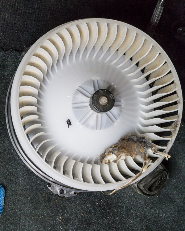

I posted this photo in 2017 when it happened to my 2-month-old 4Runner:
