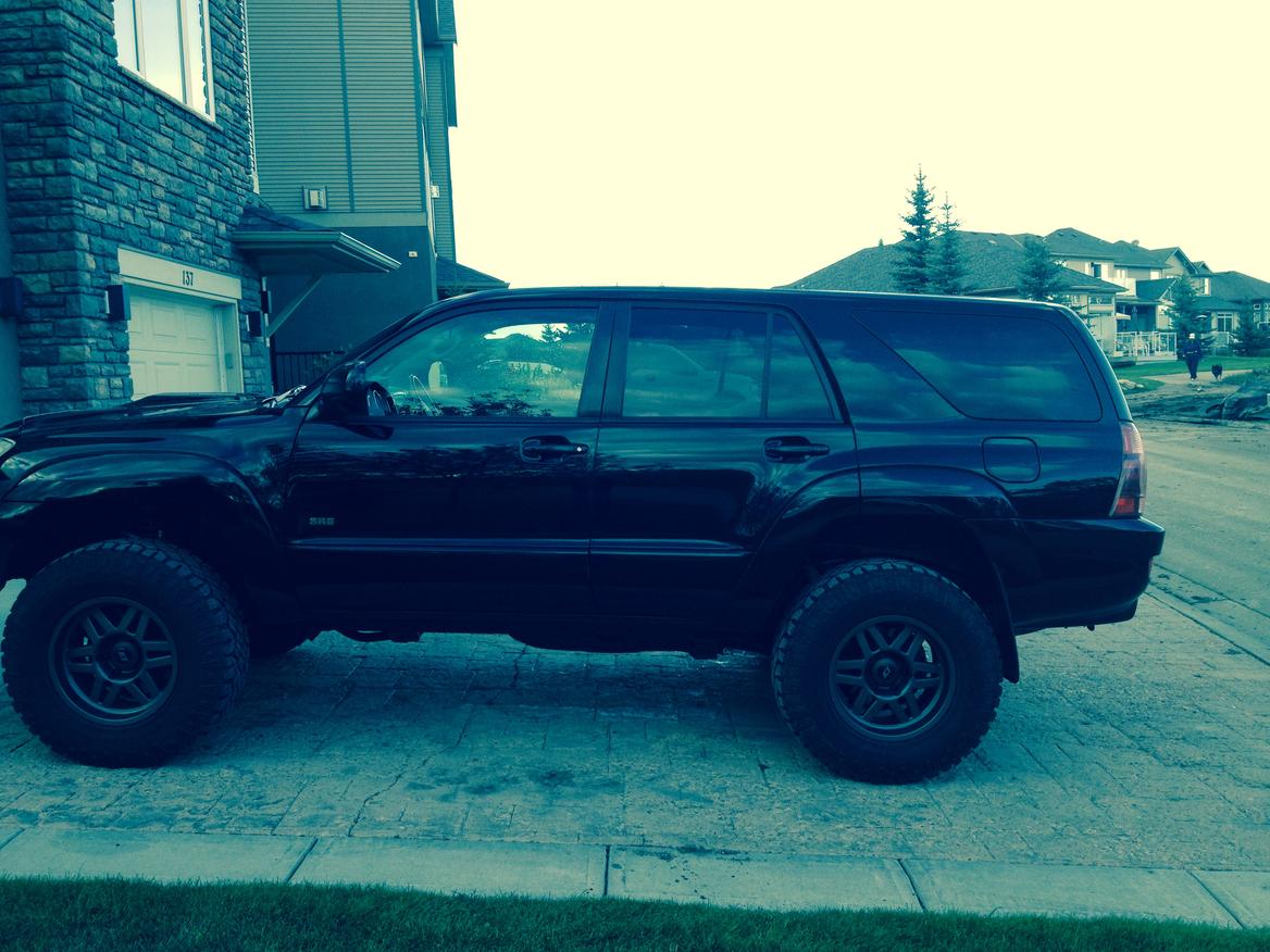

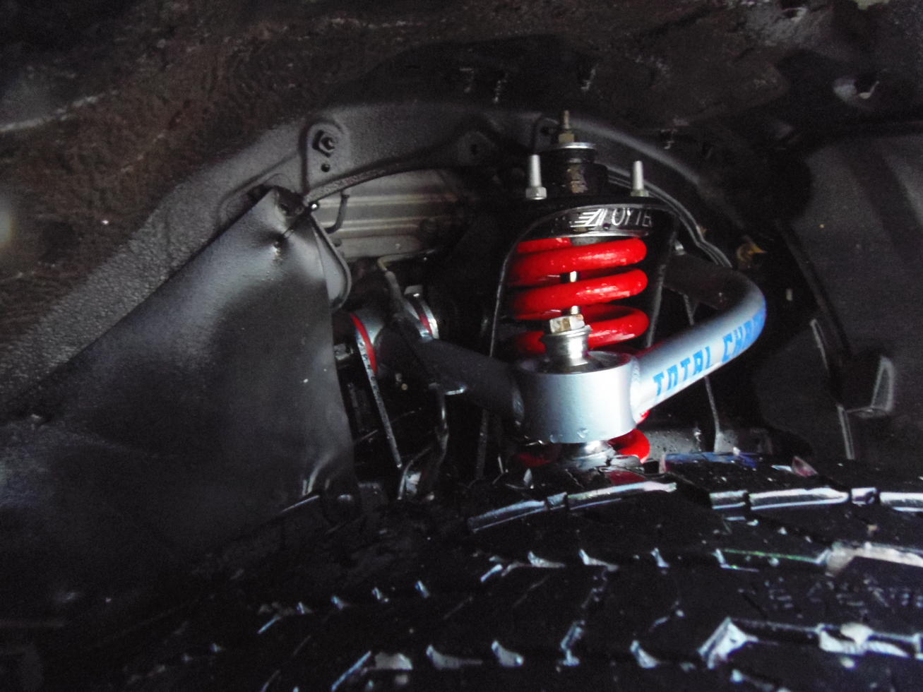

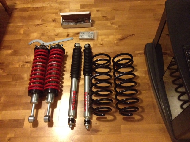

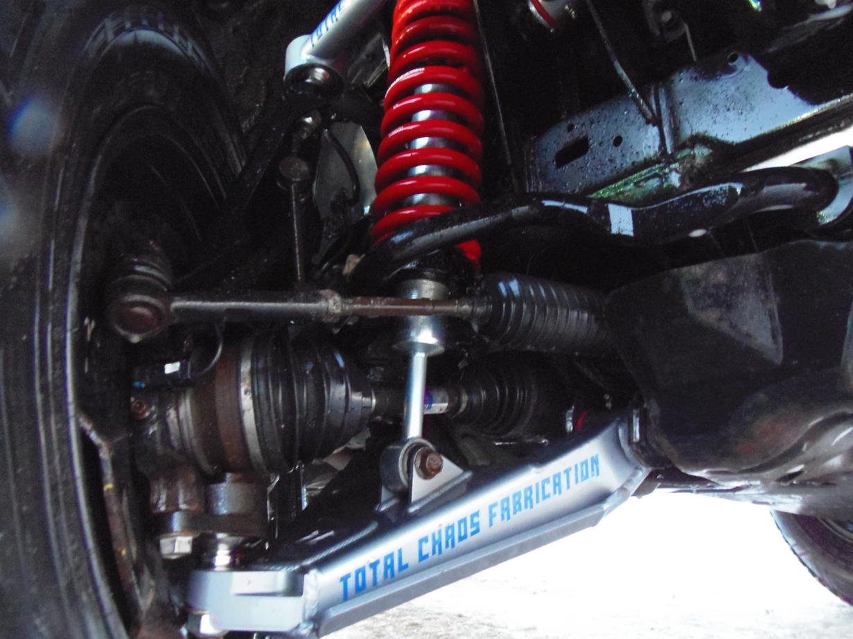

This will be my first build thread. I started with a 04 V8 Sport with 95K miles. My intent is to end up with an Overland truck designed for back country travel. So far I have added the following:
Total Chaos
UCAs
Boxed Stock length LCAs
Full rear link set and skids
Adjustment cam gussets
Shock tower gussets
Spindle gussets
Toytec Boss lift
SCS Stealth 6 wheels
The truck spent a week at The Gear Shop in Calgary for welding and installation. They did a great job and they will do all of the future work that requires welding and fabrication or crawling around under a truck.
The next phase will be Budbuilt skids and beefy sliders. The Nokian Rotivas have been great winter tires in the previous years but they are nearly gone so they will be replaced with 285 Duratracs for summer and true winter tires. That's all for now stay tuned.

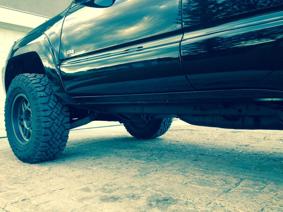

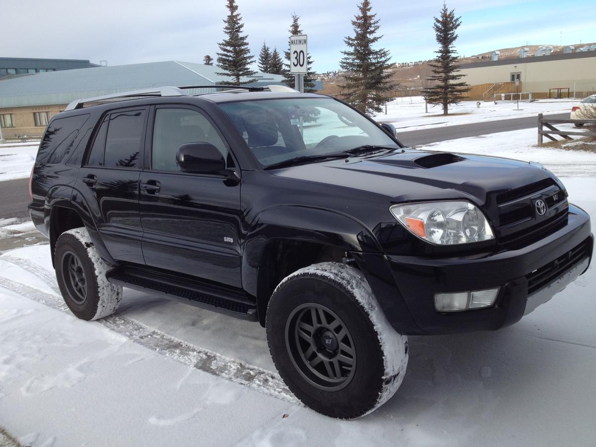

MickT 04 V8 update
Build is going slow with lack of time and money. I had the CV joints replaced with stock Toyota units along with a drive shaft balance and new Ujoints. Also installed ARB differential breathers. The latest install has been the 285/70R/17 Duratracs. Some rubbing issues, I had to remove the front mud flaps and trimmed the hell out my fender liners and lower face of front bumper. Looks great but MPG has suffered.

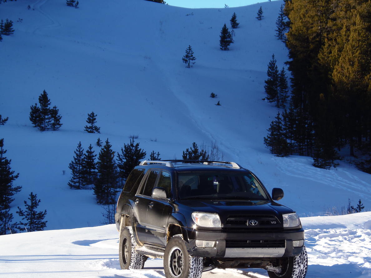

Thanks I will give them a call, anytime I can avoid the 30 cent penalty on the dollar that is cool. I took the 4runner fishing tonight and did a closed road "bypass" that involved a really steep ditch access the new tires and lift made a huge difference, I am not sure I would have tried it stock. All the wheels stayed on the ground and it was cleared with no drama. I am really looking forward to the winter. I picked up a TJM compressor and ARB tire repair kit so airing down will be a new advantage this winter. With a winch and the maxxtracs should be much less exciting this winter.

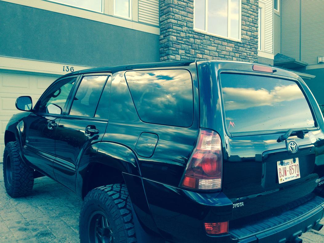

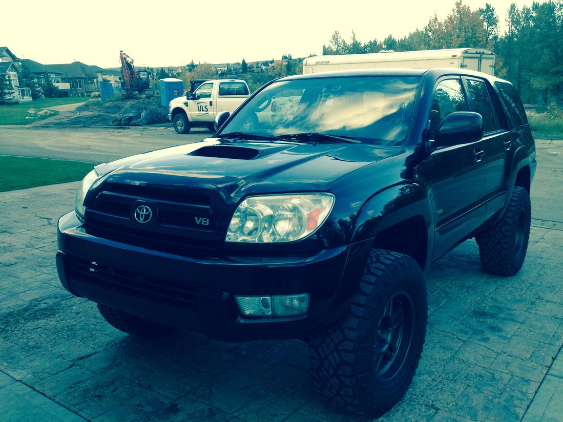

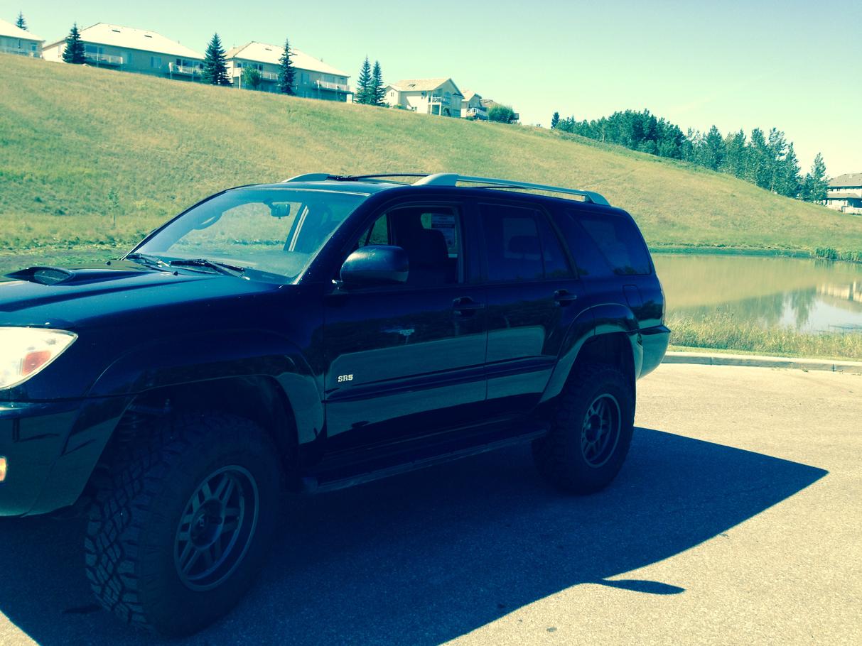

Spent the weekend working on the Runner.
This is a list of my latest Mods and maintenance:
-I ended up jacking up the front end another 1.5 inches to reduce the rubbing.
-Painted the entire under carriage after sanding and a Rust Check primer.
-Plastidip on flaking chrome front and rear bumper inserts.
-Removed my rattling running boards.
-Removed the roof rack with factory rack delete kit.
-Changed the plugs at 190K they still looked great but replaced them with NGK Irridians.
-Replaced airfilter.
I am really happy with the look and I am hoping the plugs will help with the lost fuel mileage(caused by tires). Although it is better after I checked my speedo with 2 GPS and found out my usual 120-130k speed was closer to 135-145KPH.:lookout:
