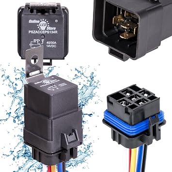

These things are available everywhere... just google "waterproof relay"
I think its worth mentioning that there are generally 2 parts to a waterproof / weather proof relay setup.
The base with the wires, and the relay itself are both waterproof.
Example:
https://www.summitracing.com/parts/...MI8a--hc2C2QIVj4jICh2SVg8sEAQYBSABEgKUPPD_BwE
They can also be purchase individually.
The relay you choose simply needs to be able to handle the max current of that circuit...
The only other decision you MIGHT have to make is if you want that relay NO or NC. (normally open, or normally closed) but most can be wired either way.

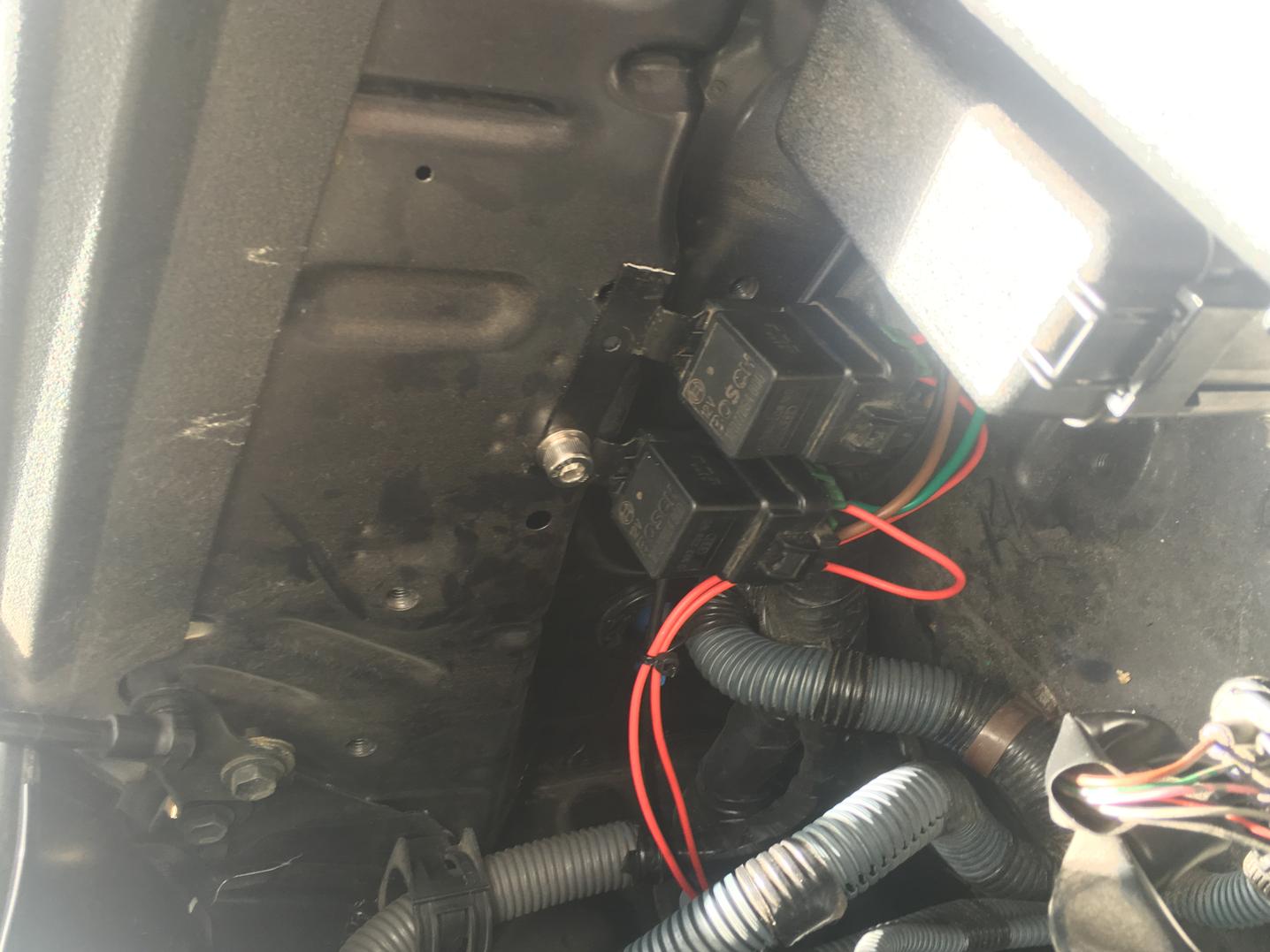

I'm familiar with waterproof relays in general, but I was asking specifically about where to look the next time I'm cruising a scrapyard.
depends on the car. either along the firewall at the top or on the driver/passenger fenders. hard to miss, as they are typically all mounted with each other on a long bracket.
