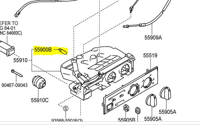

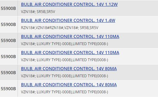

Which bulb? 2000 4R Climate control panel
Looking for replacement bulb for climate control panels. Diagram of the assembly lists part number but parts list shows multiple type (diff wattage?): Which one??
Thanks in advance,
jgf

Anybody look into maybe going to Radio Shack with one of those bulbs and looking for a replacement? I'm wondering. I have two out (rear window switch and fan control) and I'm looking to replace them. I refuse to give the stealer the 700% markup or whatever it is that they're getting. Maybe that's a project that I'll look into this weekend.
