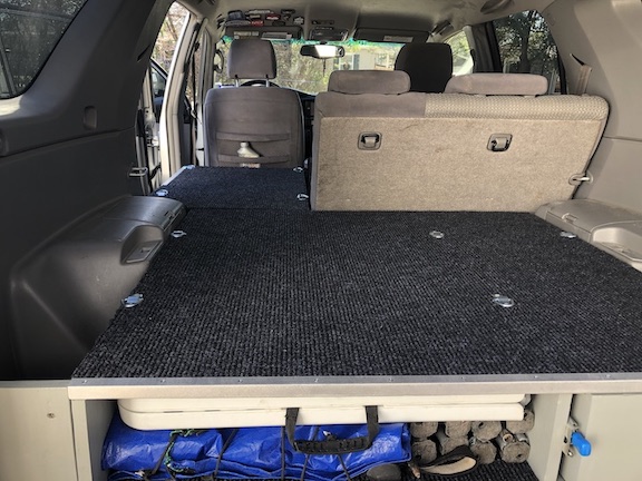

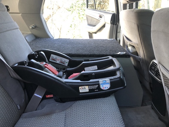

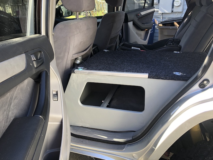

I did the same thing you're talking about, but removed the 40 (single seat) section and kept the 60 portion. Made an extension of my drawer system/cargo platform that extends all the way to behind the rear drivers seat, replaces the 40 seat structure, and creates some extra storage cubbies underneath.
I drove around with the seat removed for 6 months before I made the platform, just to make completely sure the remaining portion of the seat didn't loosen or something over time. Its perfectly fine. Everything's solid. In fact, my 4runner with 205K miles is ALMOST squeak and noise free, while my wife's fiat with less than 40K miles sounds like its falling apart going down the road. I think that might have more to do with how crappy her car is though ;):

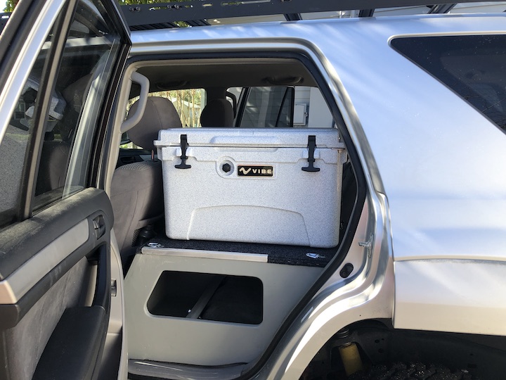

looks great. what material did you use? any reason you didn't go above the wheel wells to get full-width use of the rear area?
My drawer system goes above the wheel wells. Great for storing what I needed in the drawers but the trade off is you lose about 2-3" of head room if you want to sleep back there.
This makes it difficult to open coolers with a hinged top. I need to carefully position my Sportsman 70 cooler to open it in the rear seat location f250ben pictures his. It needs to be inboard about 4" to avoid the curve of the roof, but not so far in as to hit the dome light.
Thanks! all 3/4" plywood, gray deck sealer, and leftover marine grade carpet from another project.
My reasoning for keeping the platform low was similar to what [MENTION=210827]Boort[/MENTION] said. Main reason was our rear platform needs to allow for 2 medium size plano lockers stacked, up to 6 total in the rear platform. That's the size of plastic tote we use, and I didn't want to be limited to only 1 high. That platform height is the max hight that will still allow 2 totes to be stacked, with the top one easily removable. I never thought about being able to open the coolers too, but that's also a thing. I'm not sure we could open a cooler easily in place if the platform was any higher.
