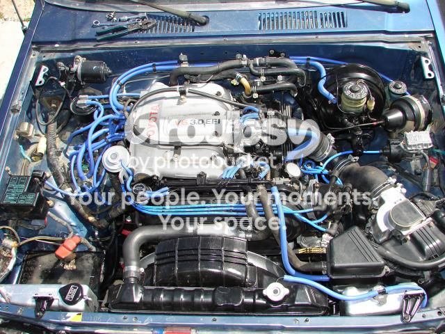

Why is it that everyone gives the 3.0 such a bad rap? I love mine it's very reliable i can beat the shit out of it and it keeps on ticking. I can get up to 70 mph with 35's no problem sure its sluggish but so it anything with 125hp stock gears and 35's. It has more power than a 22re. My guess is a 3.4 is probably a punched out 3.0 with dohc's. All the 3.4 has on it is dual cams and what 40-50hp. Sure thats a good chunk but thats not enough of a reason to totally hate an engine. So can someone give me a real reason why everyone hates this engine or did i just end up with a good one?

The engine gets a bad rep because...... it is prone to blowing headgaskets and its slow. Now not all of them blow one, but the majority do, I personally have had one that the hg went on me. It's still a Toyota engine, but its not Toyota's best.

mostly because they are crap. underpowered, prone to bad HG's, and not great fuel economy. they only have the slightest bit more power than the 22re, and aren't nearly as dependable.

The 3 blow gets a bad rap and is considered the worst toyota engine ever because of the wonky yamaha heads that are very inefficient and tend to produce heat, not to mention the exhaust crossover that causes excessive heat and is the major cause of many a blown head gasket. A valve train that is a pain to work on and adjust. Even the bottom ends aren't that strong in them. It is also the only SOHC V6 toyota ever had. Yes I have seen them last for 300k miles, but most of those were old guy driven and very well taken care. As my Toyota master tech buddy says "As long as you rebuild the head every 100-150k miles and take great care of it and pray the bottom end lasts, they'll live a while".

So basically mine is an exception to the rule? HG problem can be fixed with headers or heat wrap and a heat shield. My 3.0 doesn't feel much different than my buddies 3.4. Don't think im saying that all of you are wrong or anything thats not what im getting at. Im just trying to see why there are so many 3.0 haters and i dont have a bad thing to say about mine. It leaks oil like a sob but it also has 250000 so it can be expected. Mine must just be a beast Long live my 2nd gen lol:guitar2:
