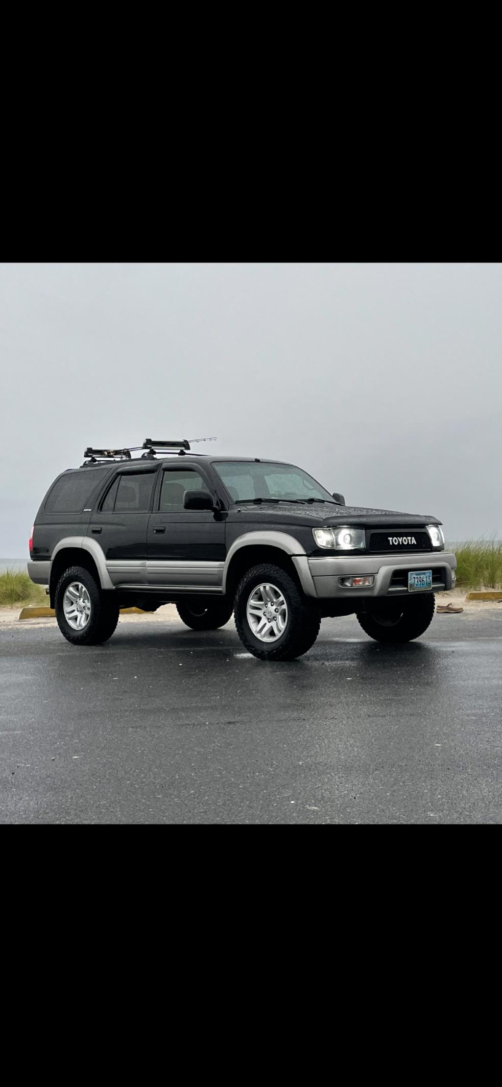

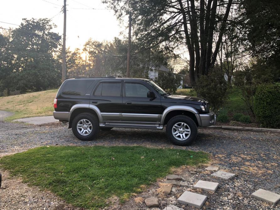

I want to share what I ended up with after looking at many different options for a mild/2" inch lift.
2002 Limited
170k miles
17" Tundra wheels w/ 265/70/17 Wildpeak ATs
Front Suspension
Fox 2.0 Coilovers
Rear Suspension
Icon VS 2.0 w/ OME 906 & 10mm spacer.
I have never seen anyone with this combo but it has worked out great for me, obviously it is more firm than stock, but not overly so, feels more planted.
If you are looking for a mild lift, something a little different, consider this.
