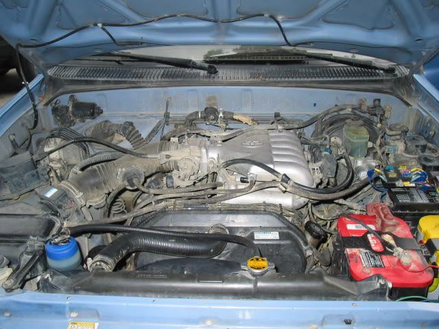

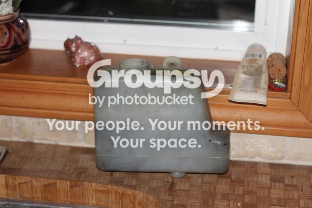

if you don't know already, i'm mid dual battery build and am using the tank out of a 1989 mitsu galant or at least i think so, found it in a pull apart...anyways, fits perfectly between the airbox and the front grill...but am concerned with capacity ...is there a minimum size on these things? just to be clear it doesn't from there does it?
IMG_9972.jpg~original
look at your old overflow bottle, and figure out how much it holds, there should be a line on it saying full or hot/cold -something like that, anyhow fill the stock one to that, then dump that into the new mitsu overflow bottle, and mark where the level comes up to. theres your new tank.

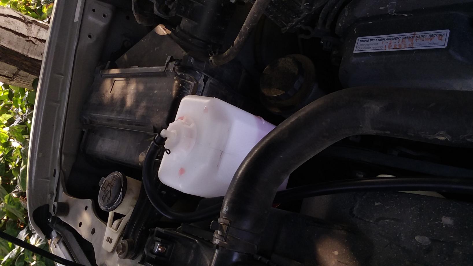

I had the same problem when going dual battery. I went to the parts store and asked for the smallest overflow bottle they had. They gave me this one. It's about 2/3 the capacity of the stock bottle, maybe a bit less. Has not been an issue at all though. Good luck with the dual battery, they are a pain to fit in there.
