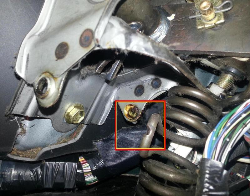

I don't think the quality of the pedal assembly is very good because mine also has issues. Not with ignition, but my pedal was squeaky as hell so I checked it out and the pedal spring was broken in half and grinding on one of the bolts. Little bit of chassis grease fixed it, but it made my car smell like shit
The torsion spring was broken in half?
I realize this is an old thread, but I'm scouring the forum for how people solved the squeaky pedal problem, so that's why I came here to ask what folks found out in the time since this thread was opened.
Your post is the first one I've seen where anyone said that the double-coil torsion spring literally broke in half.
Certainly, mine was eaten about 1/4 of the way through, so it's possible to break, but this is the only mention I've seen so far that says it actually broke.

Anyway, all of us initially greased away the squeak when we didn't realize what the underlying problem was, but now that we know the root cause, grease is the wrong answer.
The right answer is here, where it would be wonderful if the participants of this thread, if they're still around, can add your experience and knowledge to.
