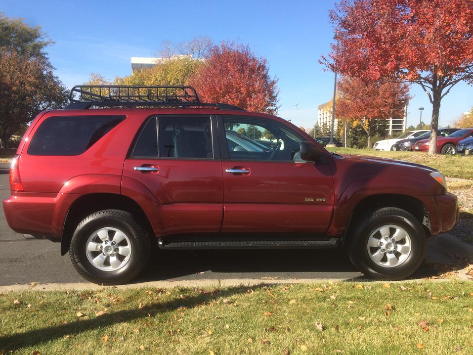

This is mine. 2.5" up front, and 1.5" in the back. Stock springs, stock 16s. I think it looks fine.
Hey Erkelbot,
Yes your lift does look good with the stock 16" tires. I may up the front from 1.75 to the max 2.5 and see how it goes.
Right now I'm at 2" of rake. Any idea what your rake is--almost looks level?
I assume it still rides pretty well with the max and no problems with alignment at the max setting?
thanks!
I'm about level. As I understand, the rear rake is about 1" from the factory. So, I added 2.5" up front and had to offset that lift in back with a 1.5" spacer. I'd imagine that if you lifted the front to 1.75", and added the 1.5" spacers in the rear you'd still maintain a .75" rake with the stock springs.
It rides MUCH better with the Bilsteins than the stock shocks -- no issues whatsoever. Less roll, and still smooth.
You'll want an alignment. Any adjustments to the suspension will affect the alignment. You could wait and see, but you do run the risk of cupping the heck out of your tires or wearing them out...fast. I think it's worth the $100 to get the truck aligned.
