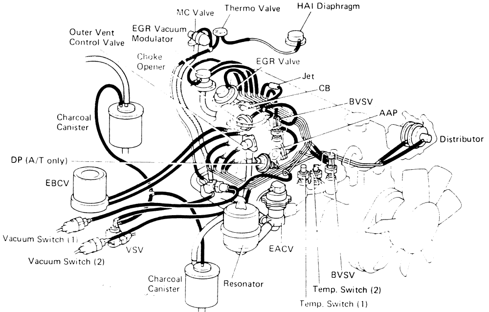

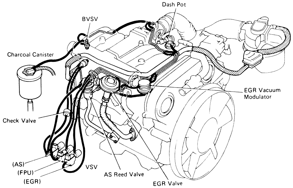

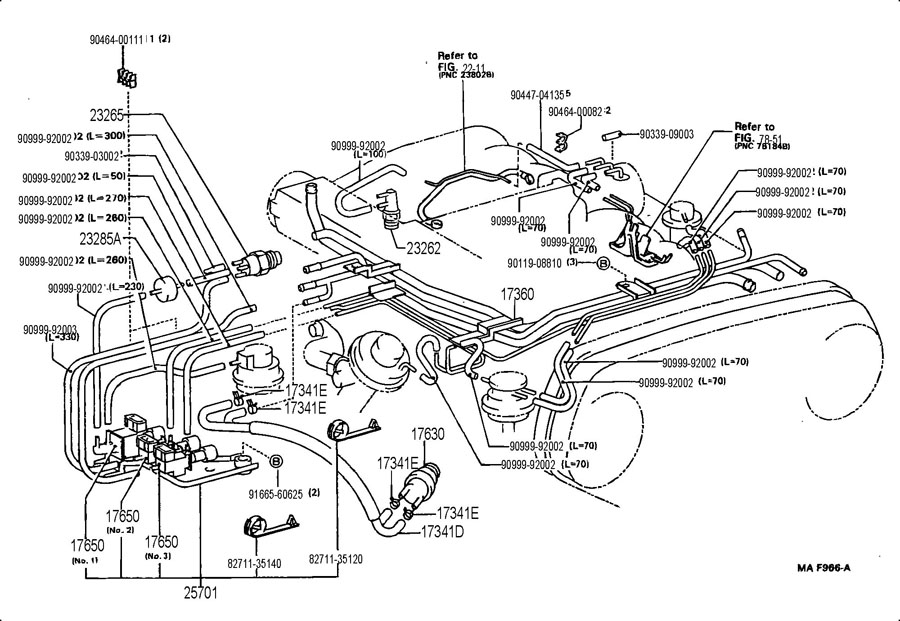

Here's a few vacuum scenarios for you to confirm what's what. Hope it helps
Thanks Mikekfr...while I was verifying the vacuum connections found the problem. Massive vacuum leak- line from manifold to PCV valve was un-plugged. No more mis-fire. Will see if it passes smog now.
