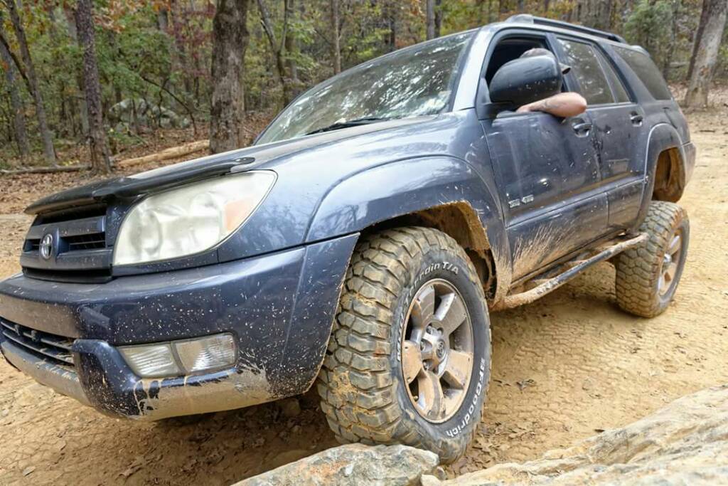

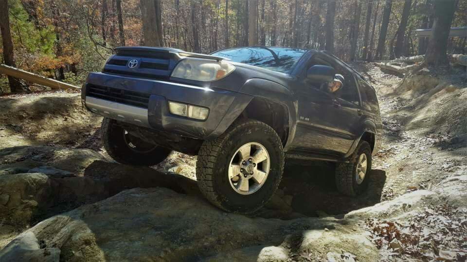

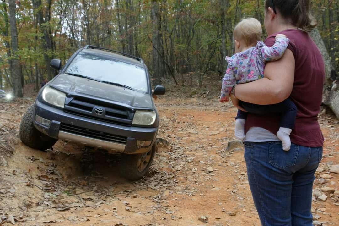

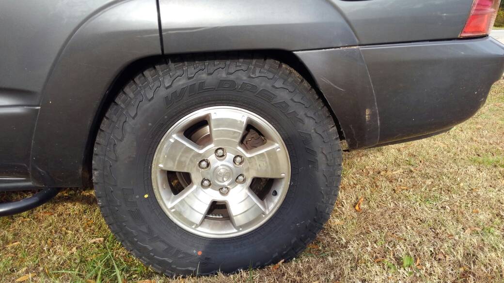

So I gashed the BFG sidewalls one of the last trips out so wife told me I could get her new tires. So naturally 255/80r17 was not big enough anymore so 285/75r17s replaced them.
As anyone with the minimum lift and biggest tires possible mindset knows I was gonna have to trim.
Some pictures from my last trip to Uwharrie with the old tires.
Even got a picture of my favorite spotter making sure I don't mess her soccer mom mobile up to badly.FB_IMG_1509979637618.jpgFB_IMG_1510674985056.jpgFB_IMG_1510674991908.jpg

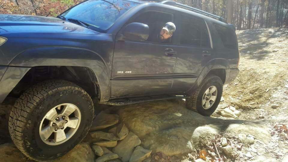

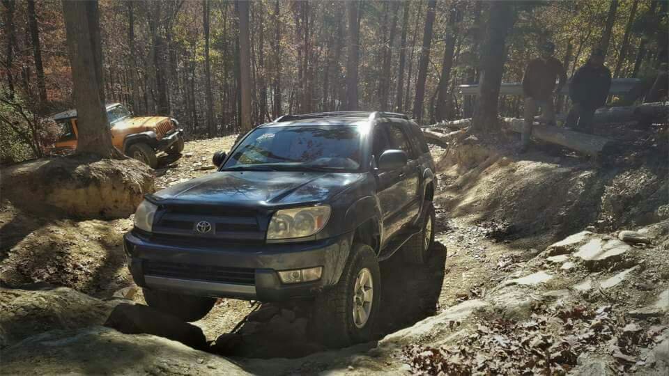

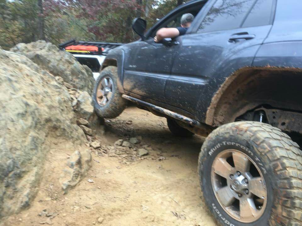

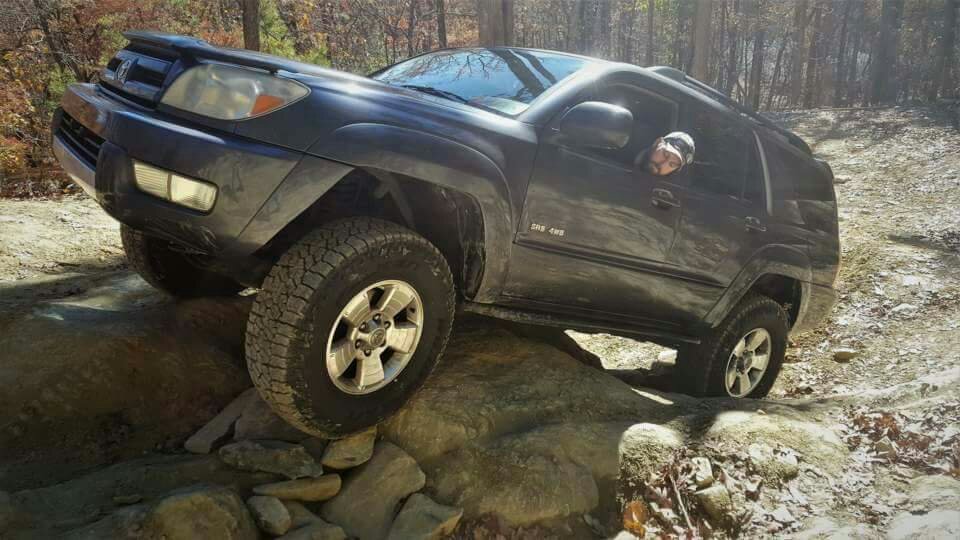

Took it to Uwharrie and tested out the new tires and as of right now I am loving them.
This I climbing the 1st ledge on the front side of Daniel for anyone that knows uwharrie.FB_IMG_1511221361663.jpgFB_IMG_1511221369006.jpgFB_IMG_1511221376016.jpgFB_IMG_1511221382094.jpg

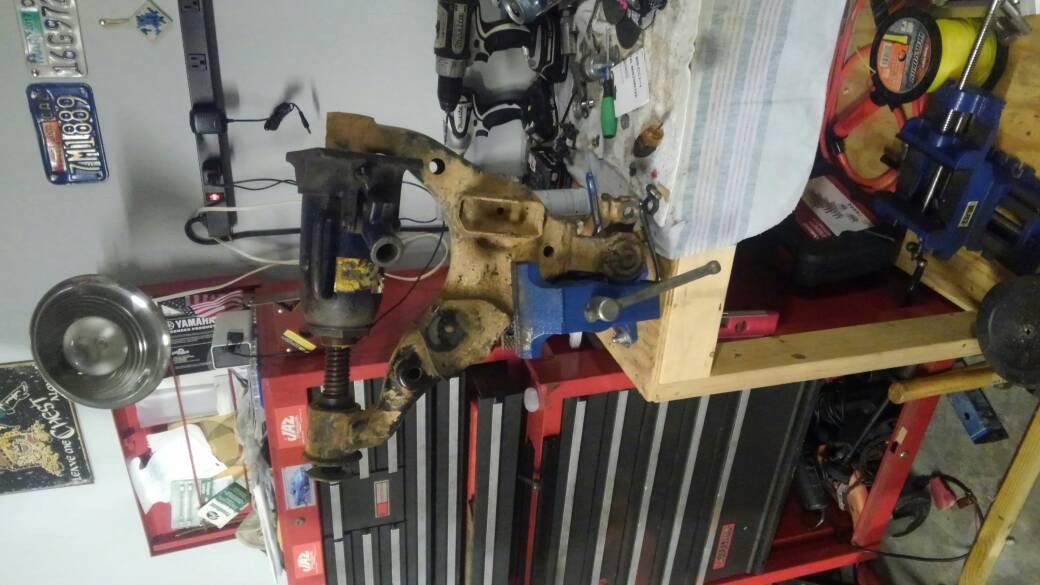

Recently did new brakes and new bushings for the LCA and bilsteins. Oh and also replaced the fj coils with a set of Dobinson springs.
The new springs claim 2.95" lift so I set the bilsteins at the 1/2" setting aiming for around 3.5" of lift.
For anyone interested the Napa replacement bushing for stock shocks fits the bilstein 5100 perfectly.

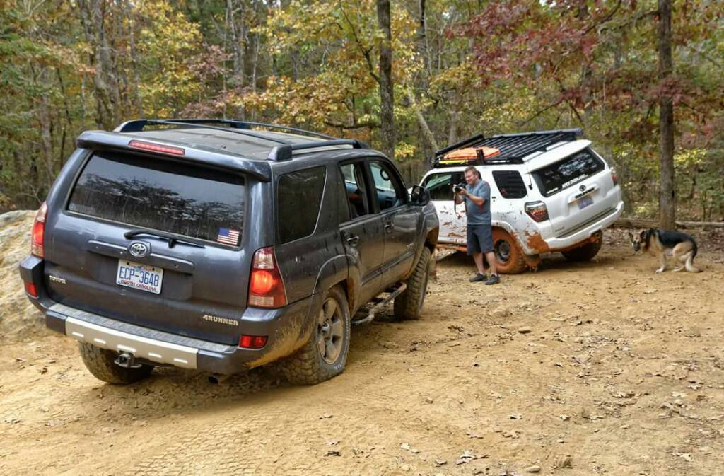

Finally got back on the trail after a year off of wheeling.
Quick Uwharrie trip to run up Daniel and Dickey Bell.
