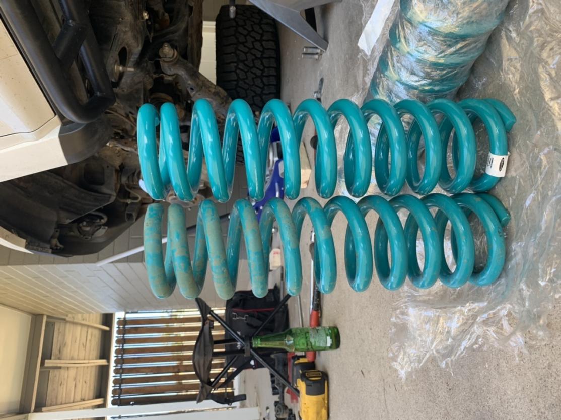

Replacement coils came in from dobinsons. This weekend I'll rip the drivers side apart and measure the coil off the truck. If it's in "spec" i'll have to weigh if I want to bother replacing them or not. Especially if I might have the same problem again.
I'm really hoping they mislabeled them and they are just 1" coils. That way I can button it back up and try to recoup some of my losses.
Shouda stuck with my OG plan and went eibach from the get go.
Alright so what I feared is true. They are the same length as the Warrantee set unloaded.

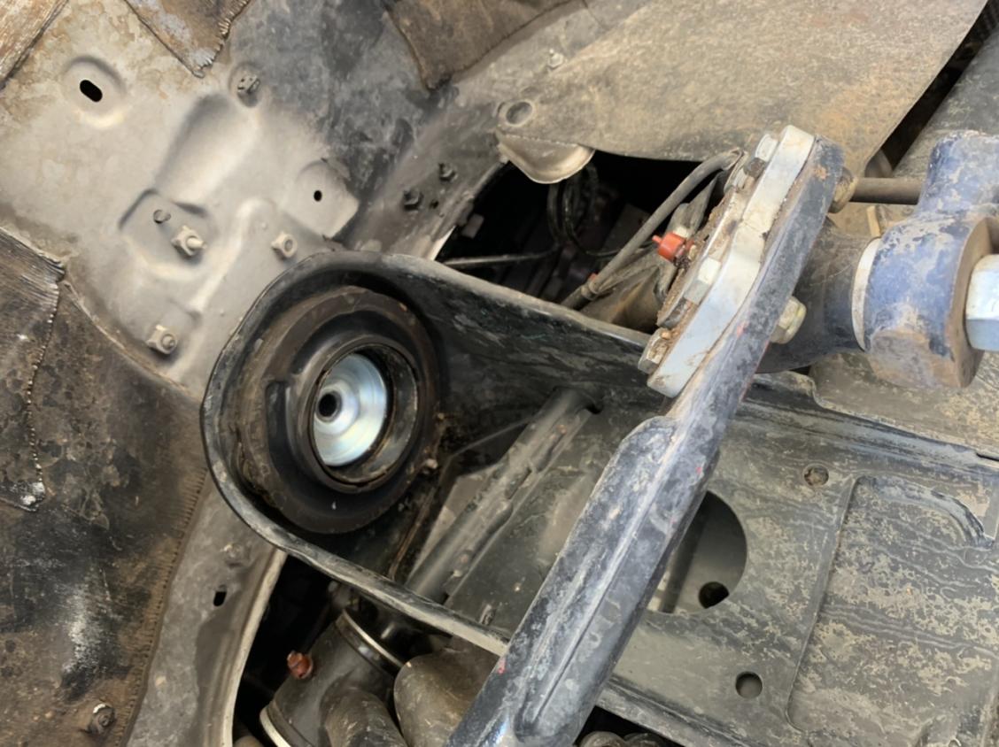

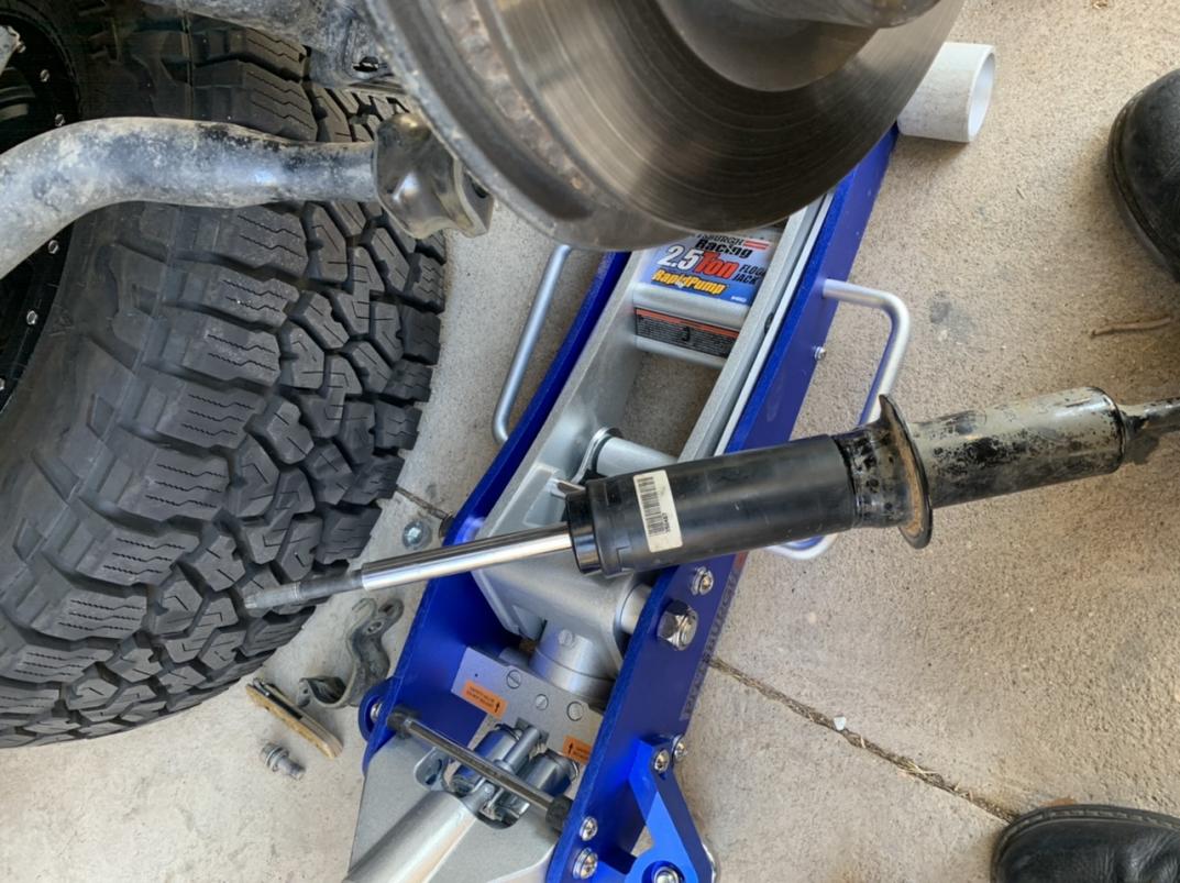

Also the strut caps them selves came apart when I pulled the assembly. Pretty stoked on dobsions quality and customer service. Hopefully I can manage to get that back together.
At a loss as to what to do as I wagered they might be a 1” coil. I suppose I’ll swap the springs and see if there is any difference. Something tells me I have wasted yet another weekend and another 80-90 bucks on an alignment.

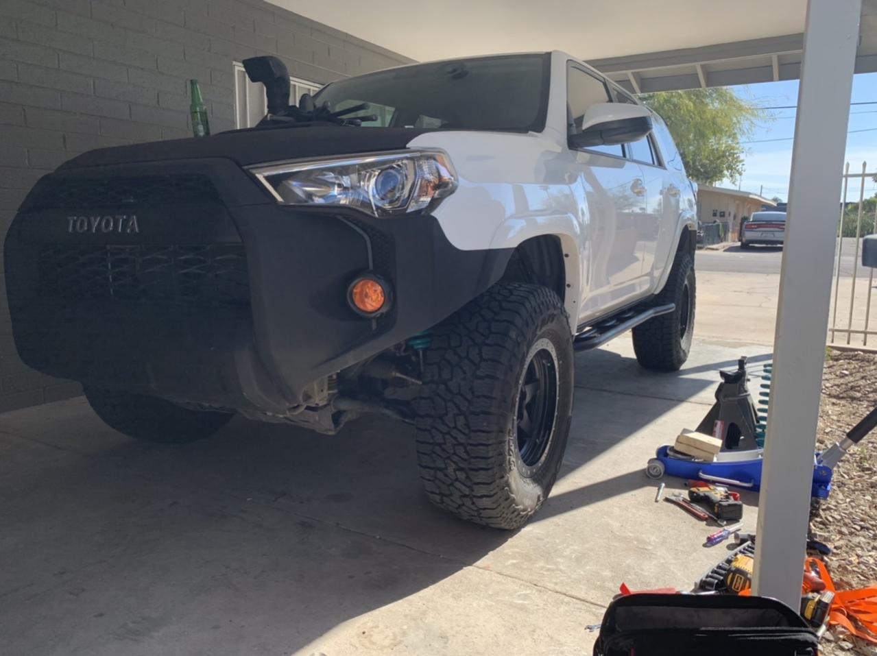

Initial impressions after dropping it down....
“Massive difference.”
Hopped up on the sliders and went all King Kong on the truck, hopped down, and took and initial measurement. 23”+... if they sold me the wrong coils or they are messed up I have no idea. Dobs can figure that out when I send their turds back.

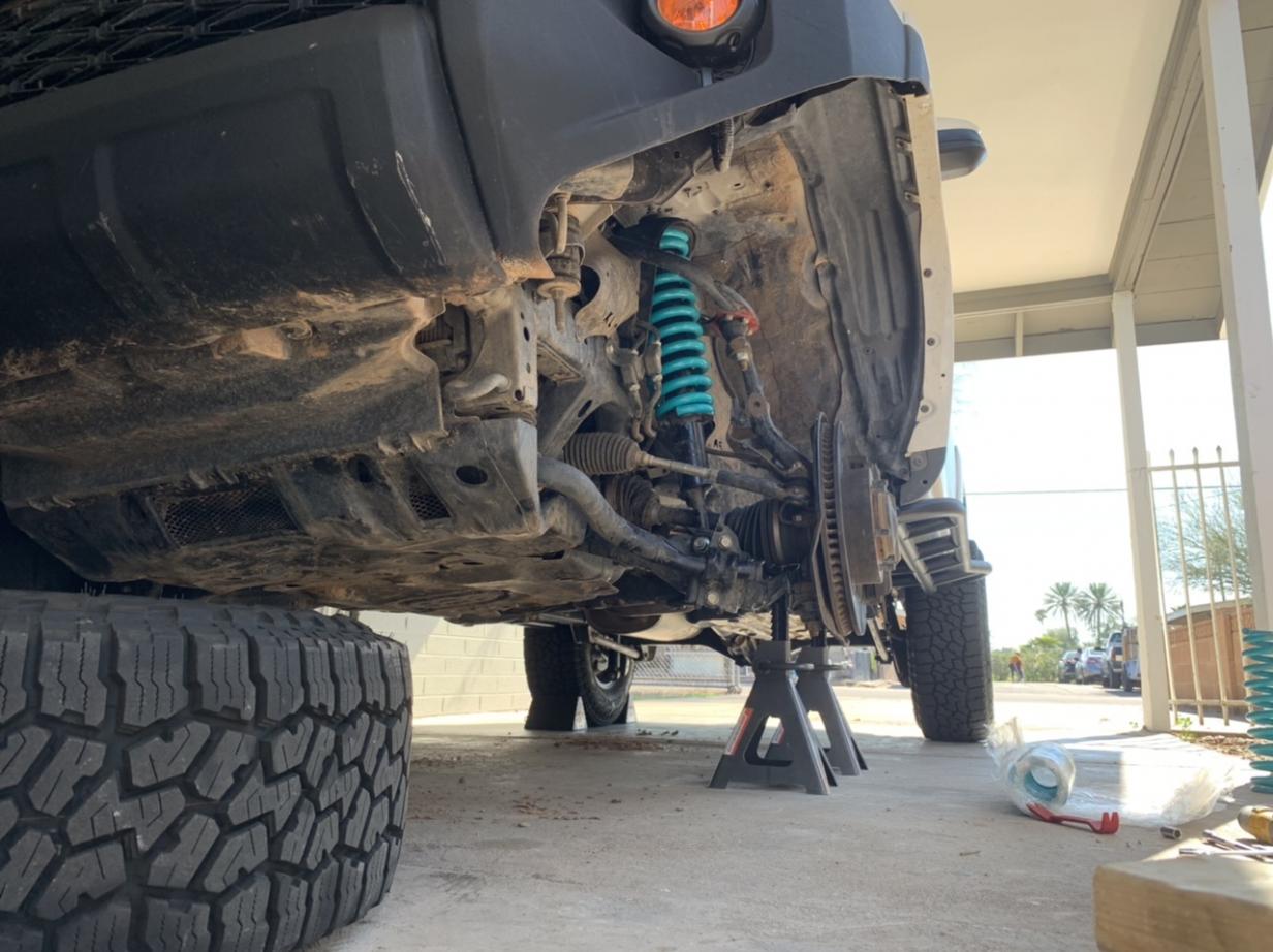

Finally! Look worlds better.
Congrats.
Thanks man. Pita tho ha.
So were the old coils mislabeled or defective? Either way it looks much better
Hard to say seeing as they measured out correct. Could be for another truck? I have no idea.

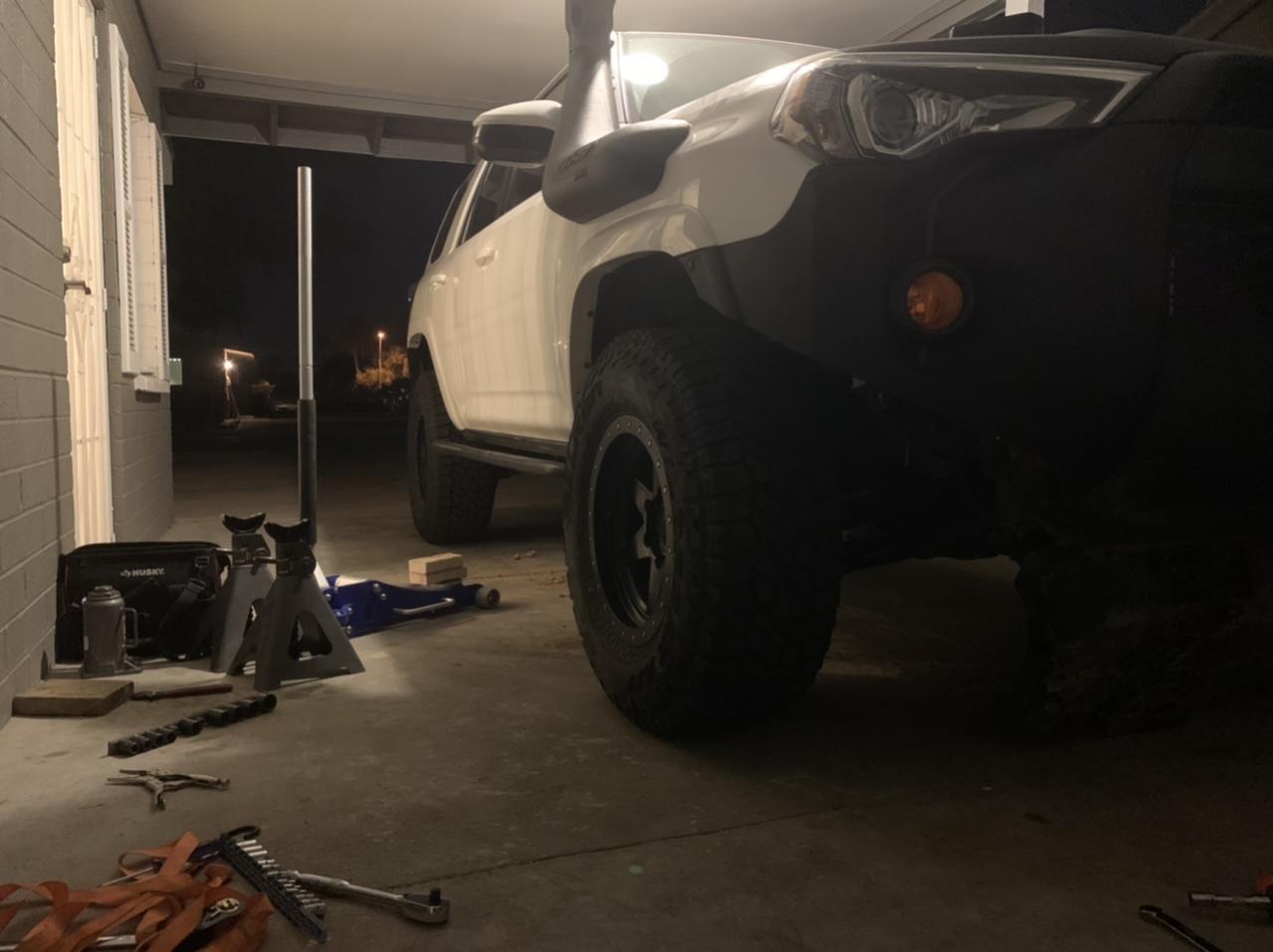

K so both sides are done I just need to tighten everything up (tomorrow I’m done). My initial sloppy measurements with a very sore back are 21.5/22.5 (+\- for errors).
For anyone with kdss. Unbolt the sway bar bracket (2 bolts) for the side you are currently working on with both sides in the air. When you finish with one side wrestle that bracket back on with ratchet straps and large cable ties BEFORE you start the other side. Wasted the rest of my day fighting myself.
Anyways. I’ll get back to it in the morning. Need to tend to my body for now.
Took some better measurements this morning:
22” maybe a little less drivers side.
21.5” passenger
Truck always has some lean to it. Hoping it will settle out a bit.
The drivers side strut came apart yesterday because I’m missing the bottom washer in the bushing sandwich. It occurred to me last night that that’s why it did that. That was my mistake on the initial install. Doesn’t seem to affect much, but I still took the time, and searched for the washer with no luck. I’ll want to address that ASAP just to be sure (screams internally).
