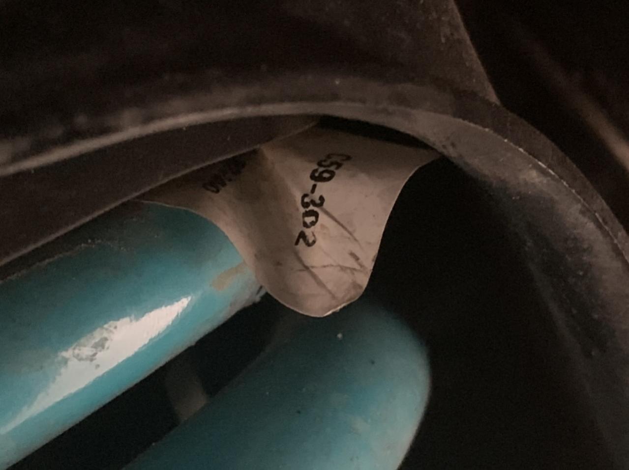

Been chasing a weird rake for ages. Turns out I most likely have front coils which are much shorter then anticipated.
They are labeled as C59-302 - Stock front end load, 2.5" lift (or comfort option C59-448 for 3" lift). 395/395mm, 17mm
What I think I got was C59-238 - Stock front end, low height lift, 1.0"-1.25" lift. 375/375mm, 17mm wire, 586LB

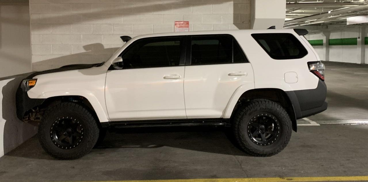

Stock hub to fender measurements 1engineer (kdss):
Front: 19.125”
Rear: 22.0”
My truck currently (kdss):
Front: 20.75” / 20.25”
Rear: 23” both sides

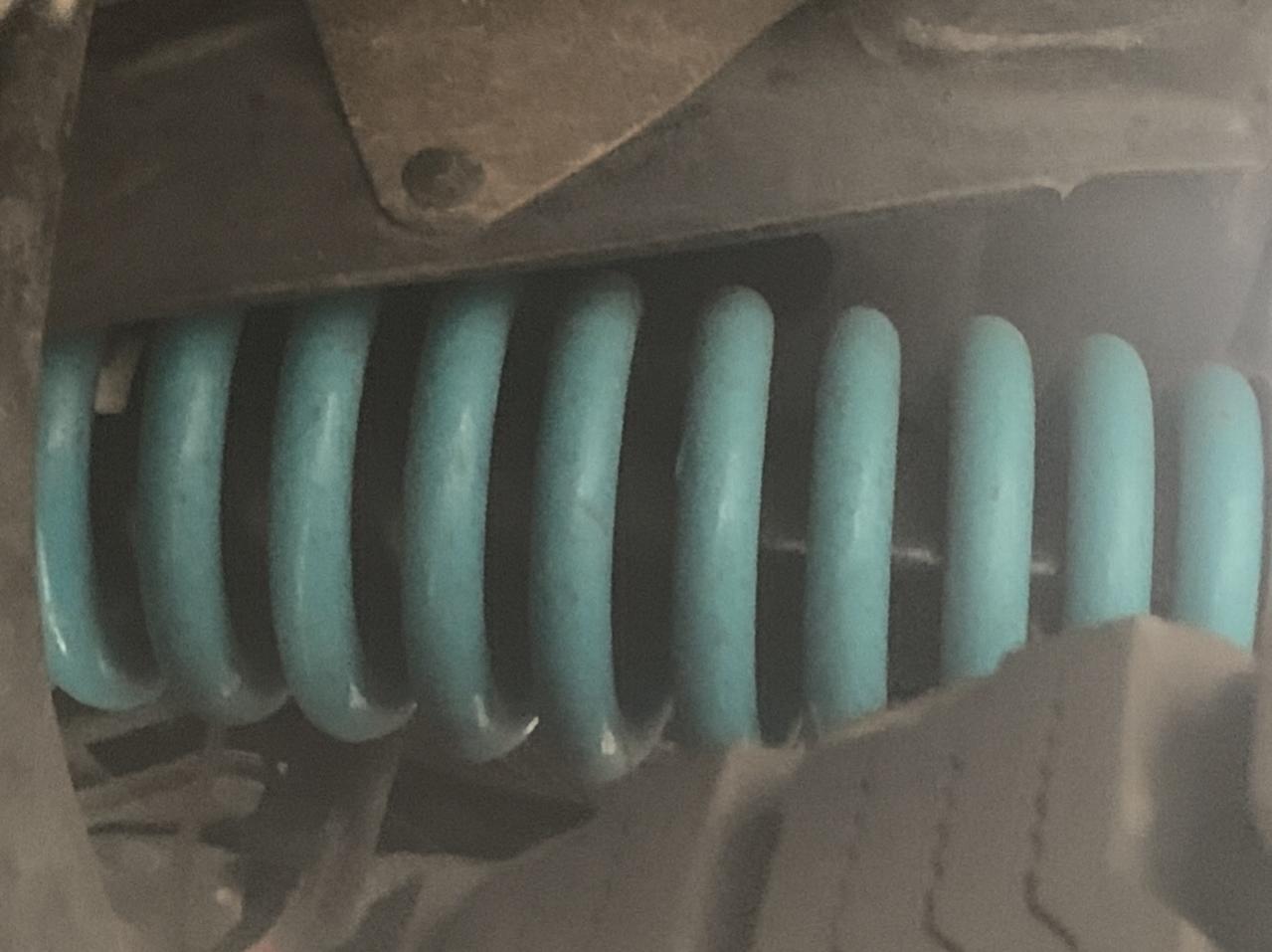

I would assume it’s safe to say I was sent a 1”-1.25” spring for stock weight?
The coils measure 11” with everything on the ground. For the c59-238’s they give a measurement of 375mm which is 14 inches. Would two inches of compression make sense?
Should I measure coils per inch? Is that useful for anything?

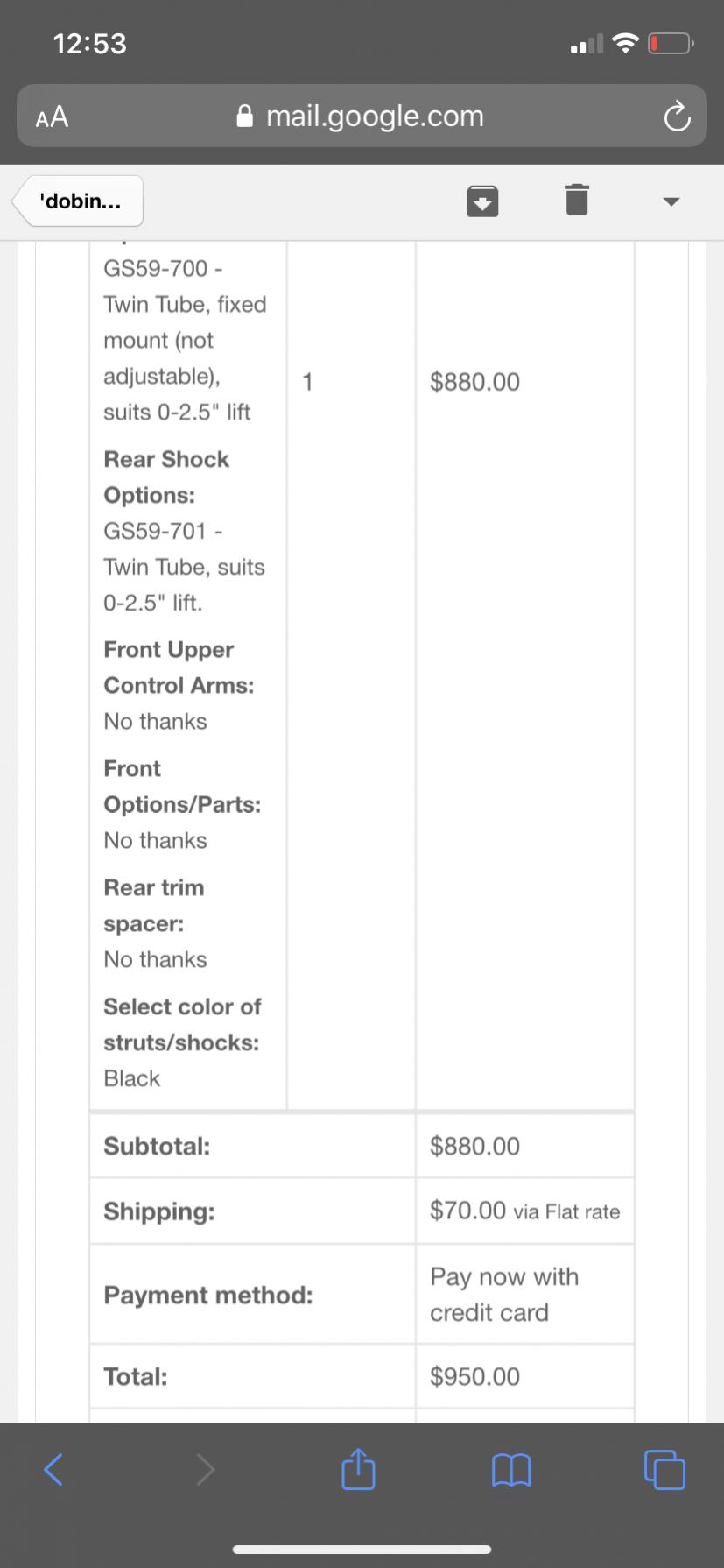

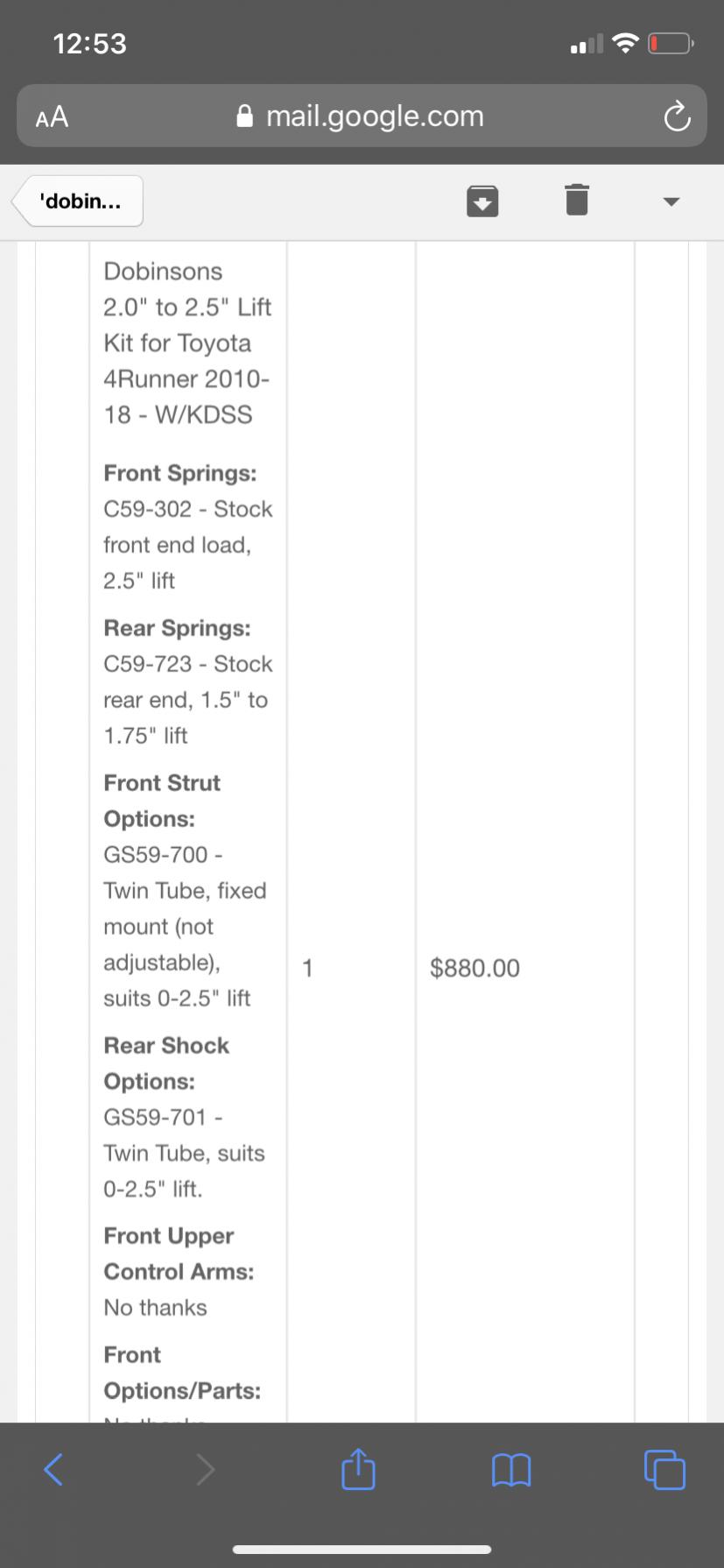

The lift I ordered was:
c59302 2.5” front lift
C59-723 - Stock rear end, 1.5" with 3rd row, 1.75" lift without, offset height coils for KDSS leveling. 420/405mm, 17mm wire, 228LB

I think you are going to have to unbolt the KDSS bracket, lower the LCA and measure one of those and compare it to the cut sheet on the spring you ordered. Don't know how else you could confirm anything if you don't trust the label. Sucks, but at least you shouldn't have to remove the spring to decompress it. And, you need an alignment anyway.

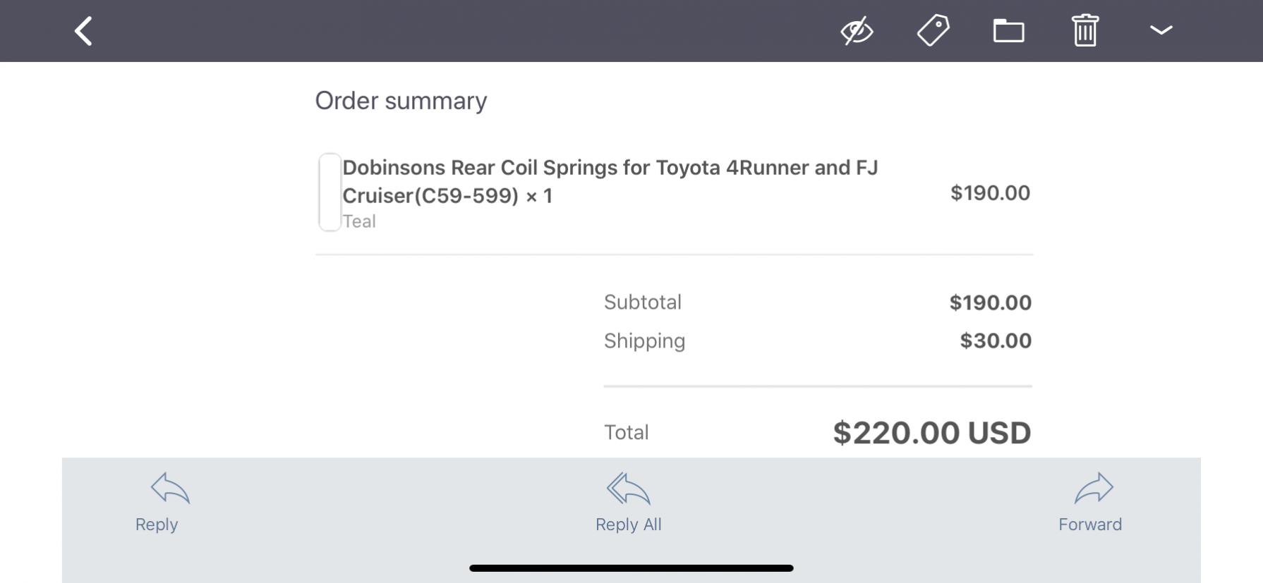

Then mike in Dobinsons didn’t catch the problem and recommended I spend another $220 on the 1” spring for the rear.

If they are intact 302’a they are garbage for sure. Glad we are on the same page here. I almost feel like I would have noticed the coils collapsing when I give it some over a bump or whoop. But, this is my first modified truck so idk.
Front: 19.125”
Rear: 22.0”
The rear height looks good to me, but are we sure 19.125" is the correct stock front measurement in the first place?
That would mean the front is nearly 3" lower than the back......which shouldn't be the case. All you should need to get the front and rear hub to fender measurements level is 1.75" of lift in the front.
Gotta remember the fenders are higher in the rear from the factory. Frame level they are offset too.
Pretty sure those are accurate #’s.
Not trying to level my fenders. Just trying to see what’s up with my front coils. But thanks.
