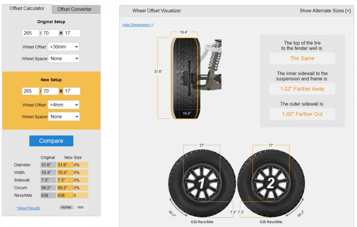

I just did this myself. Stock offset is a positive 30mm. The TRD wheels I got were a zero offset of 4mm. Your stock wheels are also 7.5" wide and the TRD wheels are 7" wide ( at least mine are).
The combo of the two takes the tire position itself and moves it towards the front bumper slightly. I am about to go to 33 x 10.5 Kenda Cleaver RT's.
Here is a photo showing the differences on my setup - currently on 265/70R17's.
This is the link to the site with the visualization - good luck: http://https://www.1010tires.com/Tools/Wheel-Offset-Calculator#
