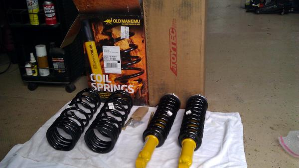

mizzle415-albums-98+ltd+runner+desert+dune-silver-picture3833-full-ome-3-kit-881-890-coils-60028-comforts-rear-1-2-spacers-top-front-got-1-diff-drop-kit-too.jpg

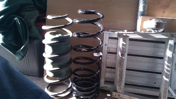

OEM spring and airbag on left, OME 890 right
mizzle415-albums-98+ltd+runner+desert+dune-silver-picture3834-stock-98-spring-blown-firestone-airbag-left-shiny-new-890-right.jpg

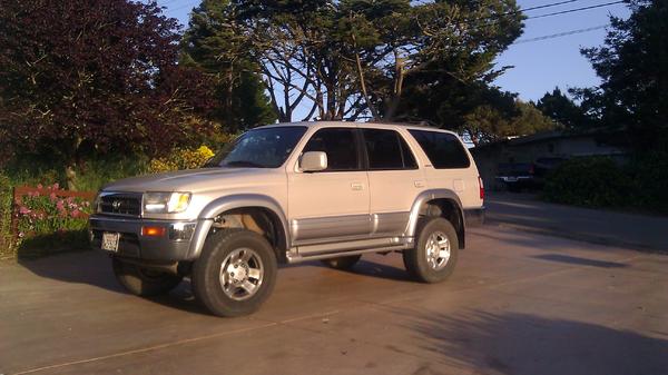

After OME lift
mizzle415-albums-98+ltd+runner+desert+dune-silver-picture3830-nice-light-runner-new-lift.jpg

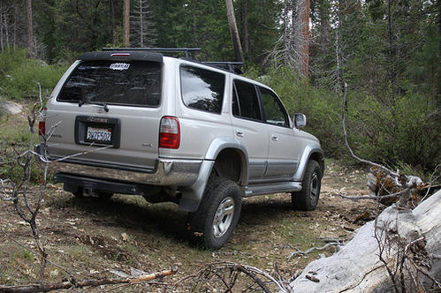

I live south of SF a bit, so it takes a long drive to get out and hit the trails. This shot is with the OME lift and Geolander ATs tires at 265/70/16. Cherry Lake, CA.
mizzle415-albums-98+ltd+runner+desert+dune-silver-picture4607-omes-flexin-little-go-around-downed-tree.jpg
