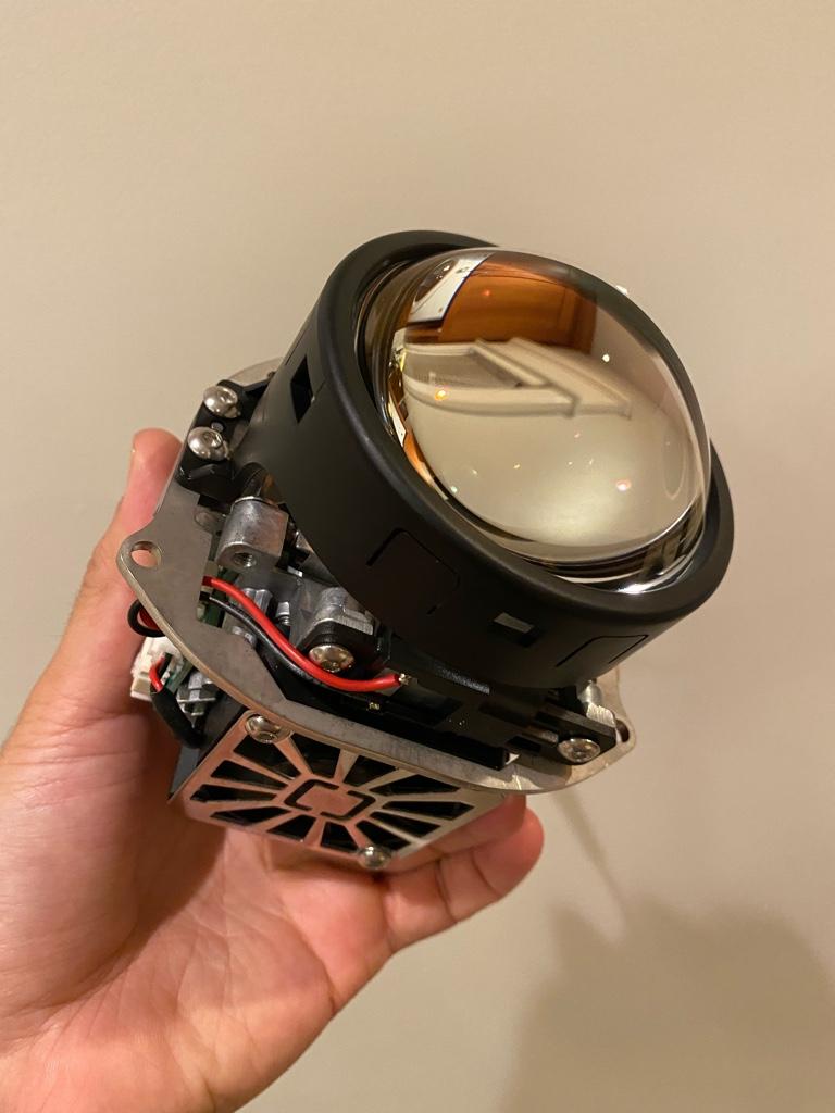

There has been a lot of talk about the OEM Bi LED headlights and Morimoto’s XB v2 drop in full replacements. I’ve been running HID bulbs in the OEM halogen projector housings for years and never was happy with how they worked. So I was initially excited about both options but was really disappointed with the output of those two solutions. After hearing great things about the MLED 2.0 projectors, specifically that it was one of the first projectors to match high end HID projector performance I decided a headlight retrofit was in order.

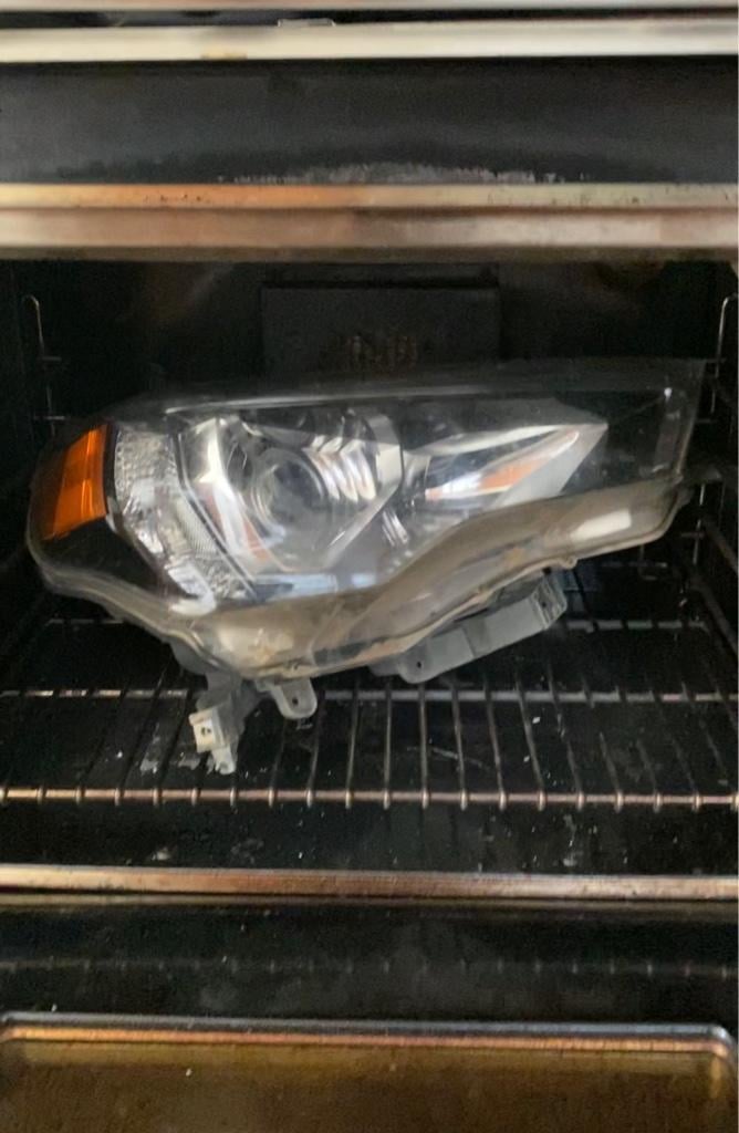

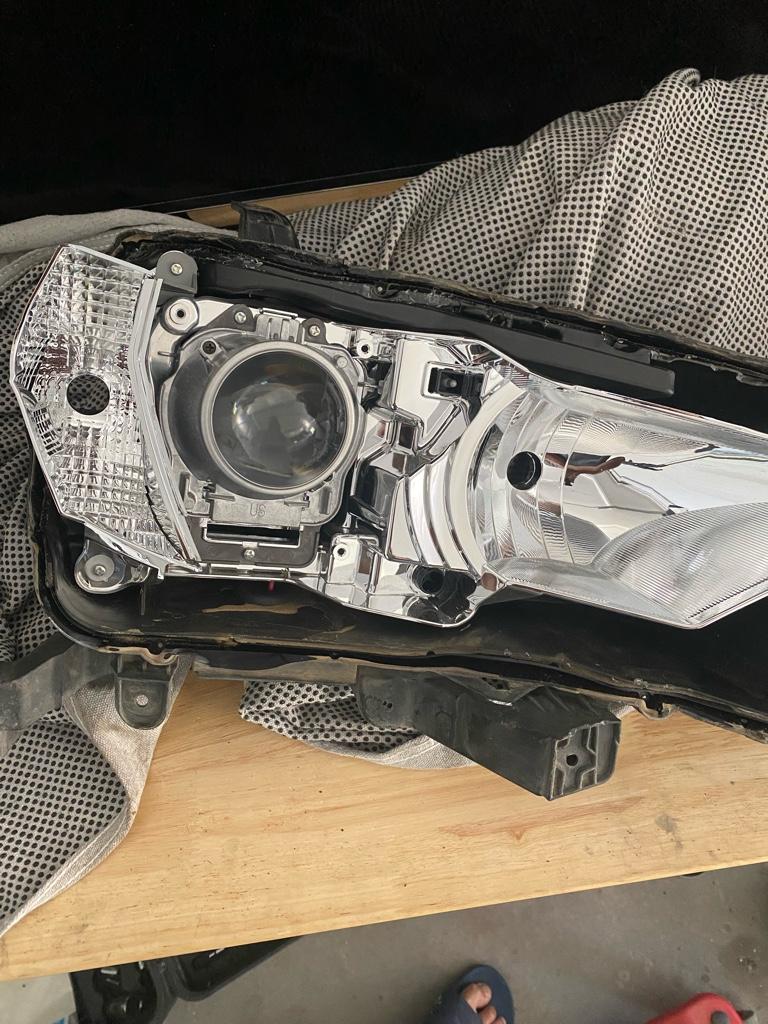

Probably the most labor intensive part of all of this was actually opening up the headlights. Toyota uses permaseal to bond the headlight components together and as the name implies it’s not meant to be opened. I spent easily three hours on each headlight just cracking them open.
Once they were open it was a pretty straightforward swap of the projectors using Quick retrofit brackets from [MENTION=81410]LightWerkz[/MENTION]. The technology behind these things is super impressive.

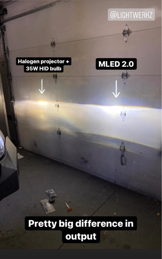

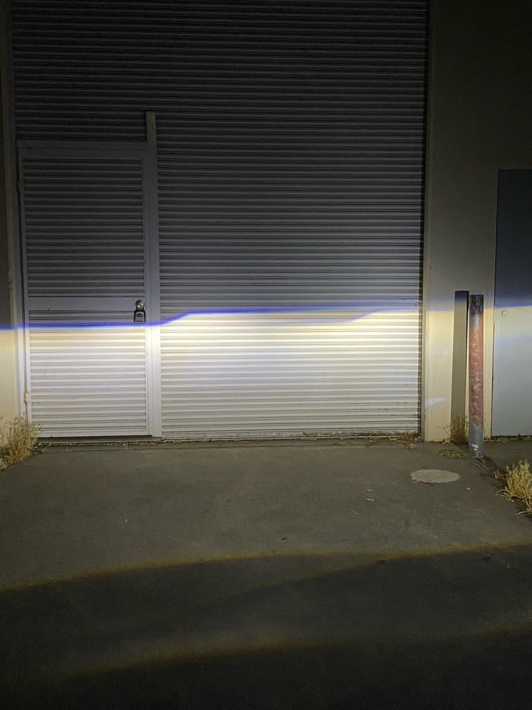

Once I had them installed on one headlight I wanted to compare the output of my existing setup vs. the new BI LED projector
As you can see there is no comparison in terms of even light distribution. After buttoning things up I went for a drive and was blown away by the output
Low Beam
High Beam (MLED High + Stock Halogen High Beams)

So my overall take on this is that it is worth a weekend and $400 in parts to make your driving experience at night that much better. My only complaint and it’s a pretty big one is that they used an LED that is pretty cool in color 6300K. I think the performance would be even better if they had something like a 5000K LED in there. Hopefully there will be an MLED 3.0 with an option like that.

Haha yes it sucked! I also damaged one of the housings in the oven when I decided to heat the oven up with the headlight inside of it. If I had to do it over again I would probably just cut the headlight housings open and reseal them afterwards. It would have saved me hours of labor!

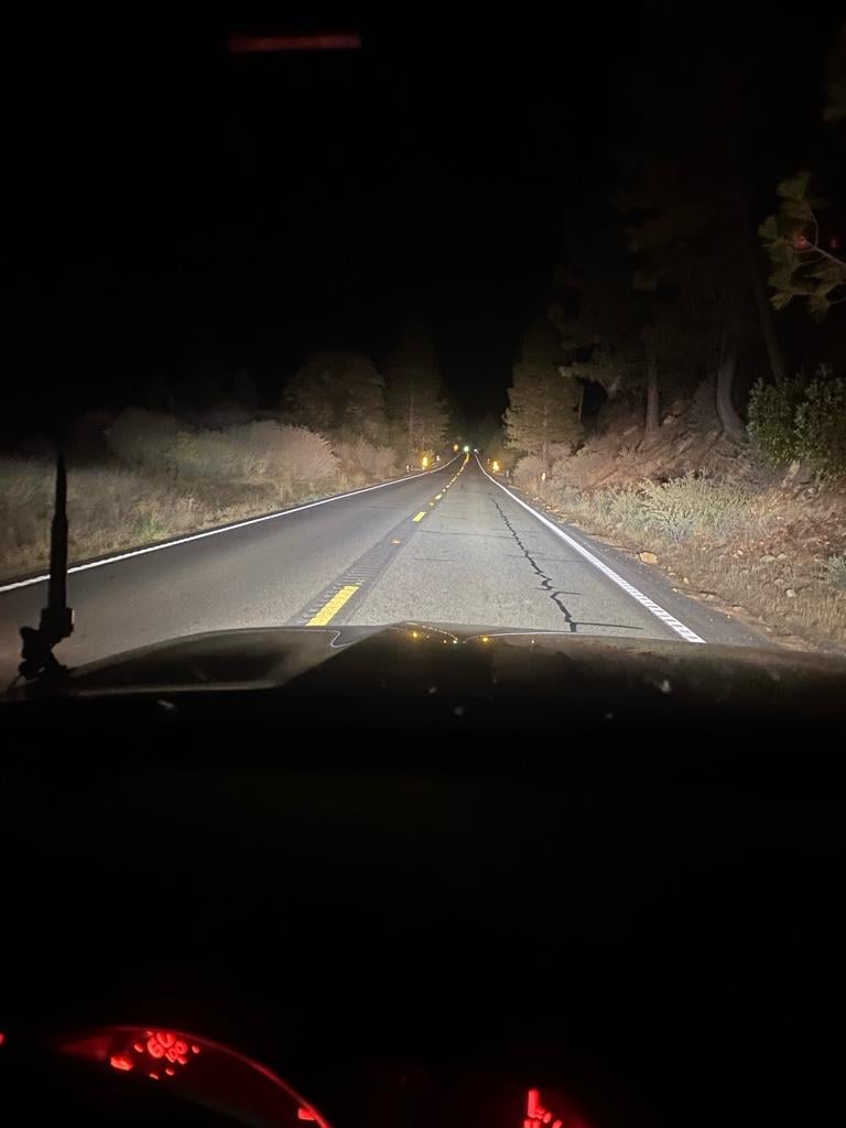

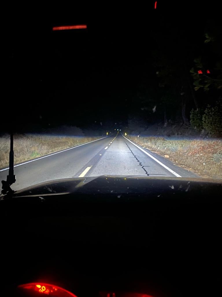

Updating the thread with better output shots. Had a chance to use them on some backcountry roads and the trail this weekend. Thoroughly impressed with the width and light distribution.
Low beams:
High beams (MLED 2.0 high + stock halogen highs)

Does anyone else see what looks to be the cutoff notch way out there in left and right field (literal field) instead of stepping down for oncoming traffic ahead?
Makes sense why you see such a straight and wide beam pattern, instead of converging ahead, the step-down of one beam overlaps the other.
There is no drop down on the driver side edge. I think what you are seeing is lack of shrubbery there which makes it look like a step down. Both patterns definitely converge together down range.
