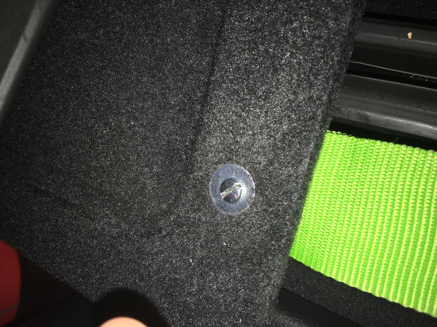

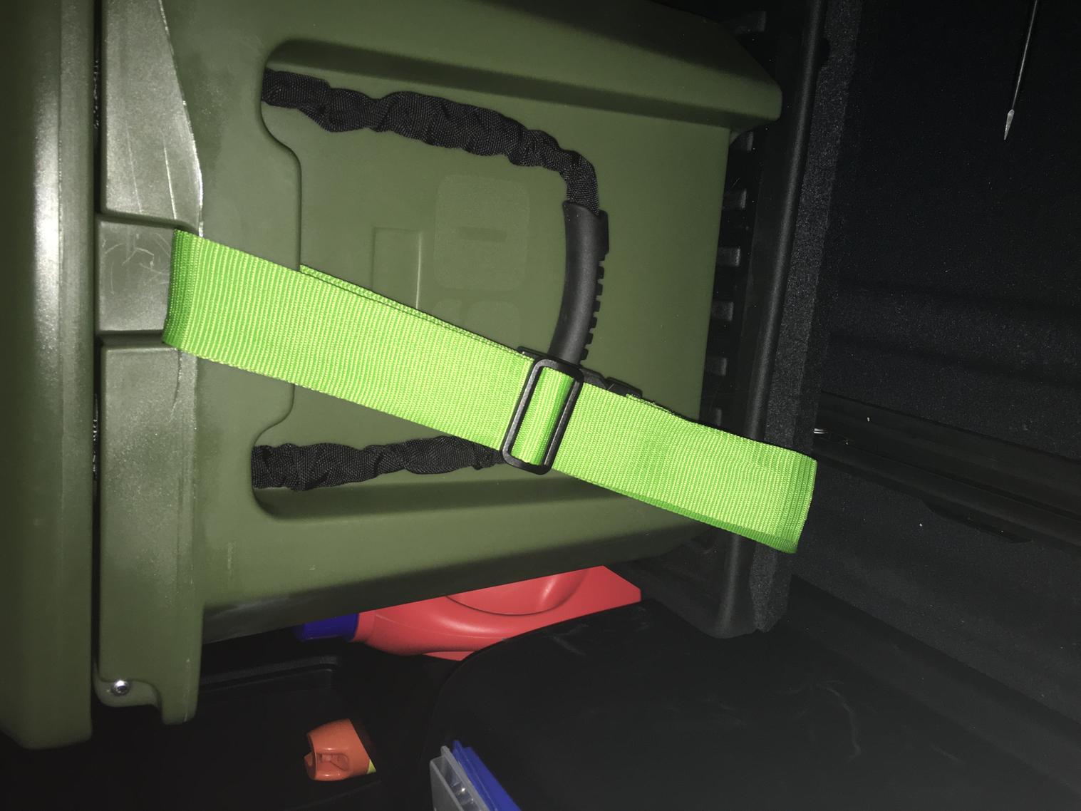

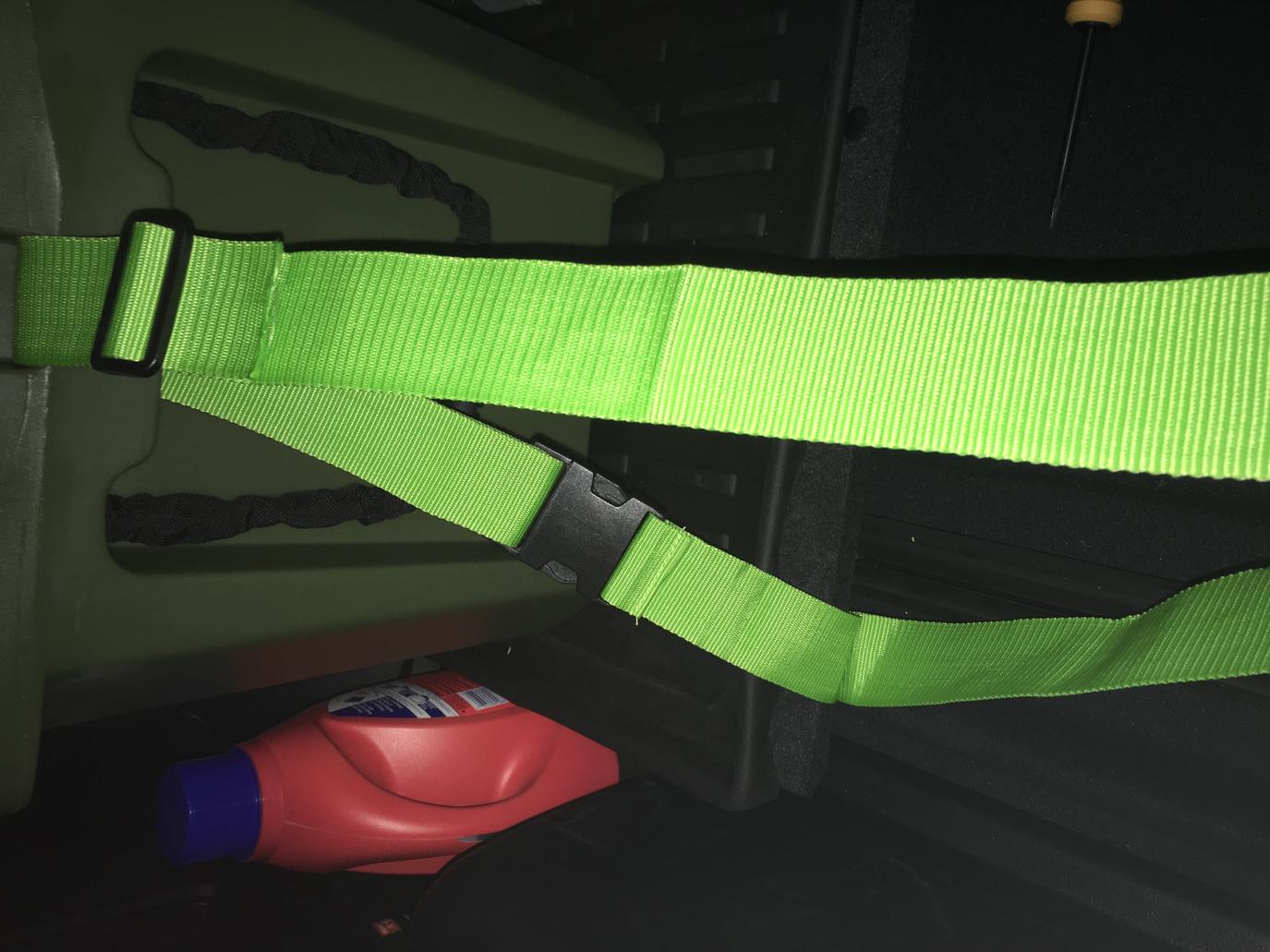

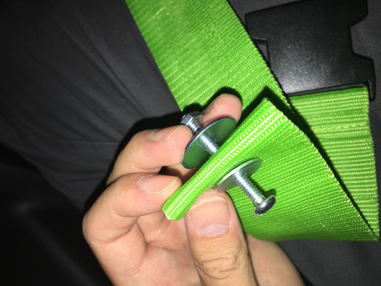

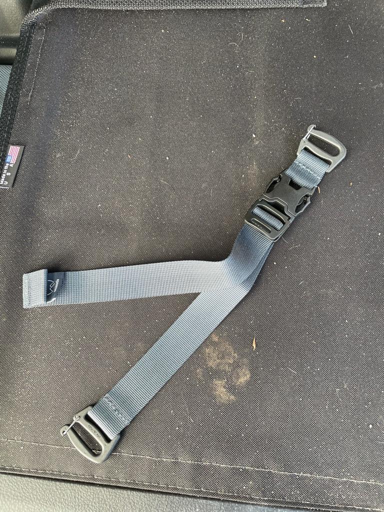

Here is a easy mod I did to secure my cooler to the sliding tray.
1. Remove the plastic plugs in the back that are holding the carpet down (these will be replaced by bolts). The holes go completely through the tray so no drilling is required.
2. I purchased hardware at ACE and used stuff made for furniture to have it as flush with the tray as possible.
3. Webbing and buckles I got at REI for $7. Cinch thingies were about $3, probably could be found cheaper or salvaged from old jackets. 550 paracord I had on hand.

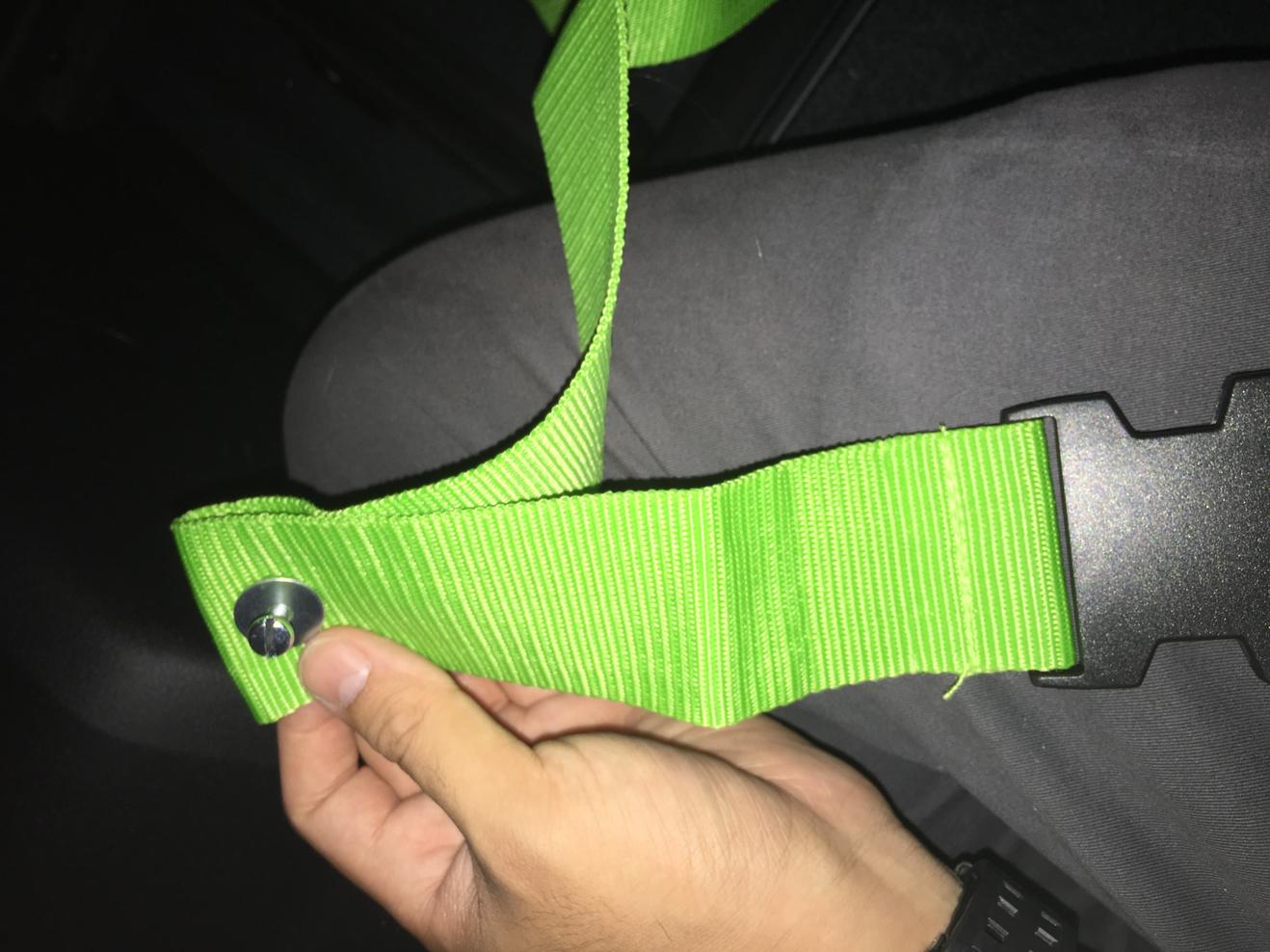

4. The things that allow the straps to be removed I had acquired from an old bag strap I wasn't using, but I'm sure you could find something similar online. (see pic 3)

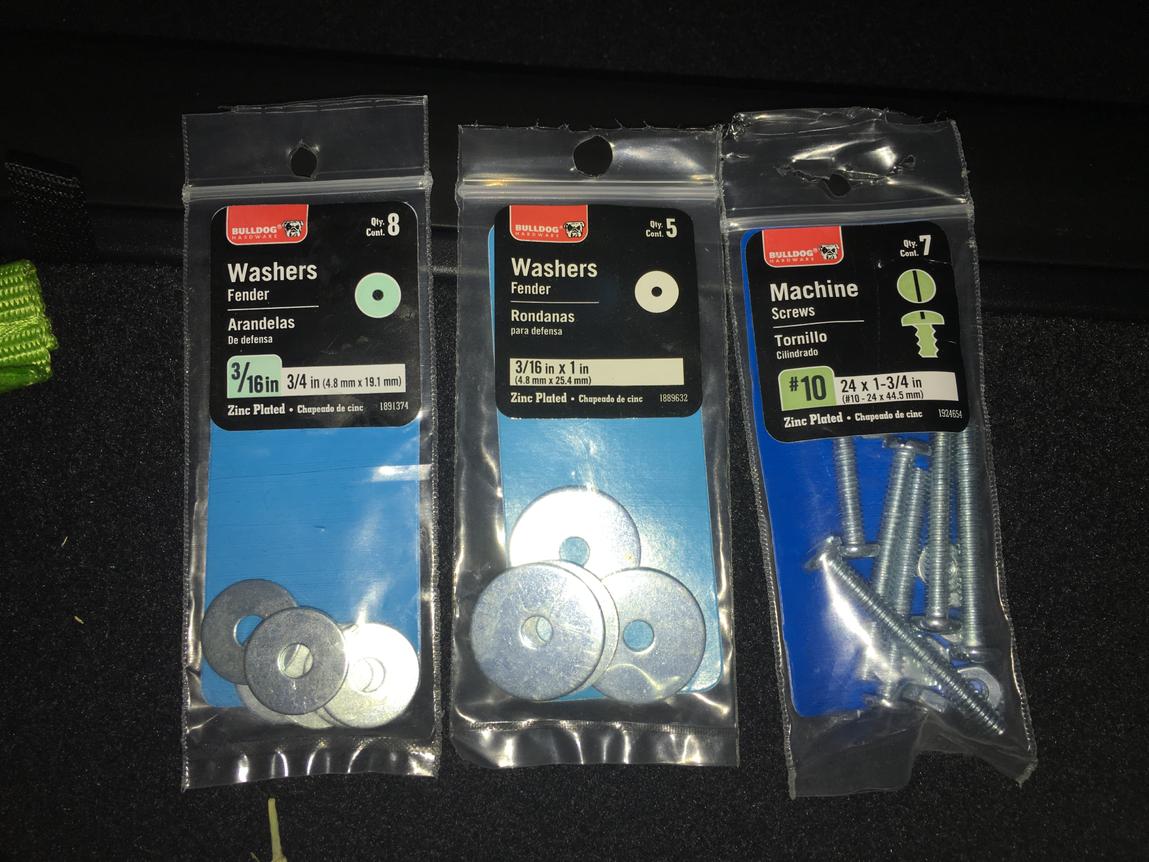

Thanks for the post man. Really great idea. I’ve attached photos of the hardware I used that worked well for me based on your idea.

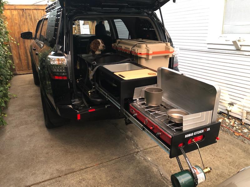

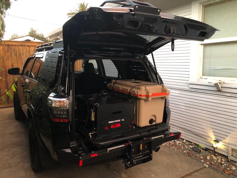

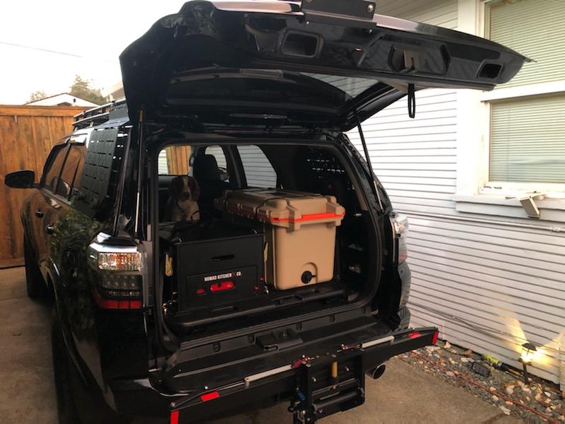

Found this thread digging and I'm really glad I did. Originally was going to do the Aiden James Customs sliding gear plate (plywood plate coated in Line-X, bolts onto cargo tray with no drilling) but bailed when fabrication and delivery dragged too long. Glad it didn't pan out!
It's a tight squeeze but I got everything to fit (Nomad Kitchen and 70 qt pelican cooler) like a glove.
What are those little buckles called and how did you seat them inside the webbing?

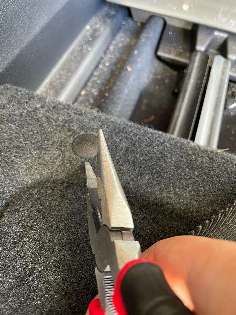

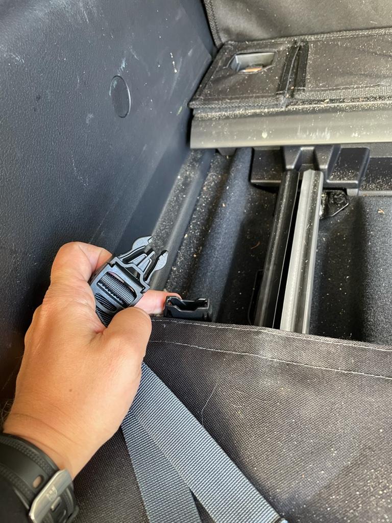

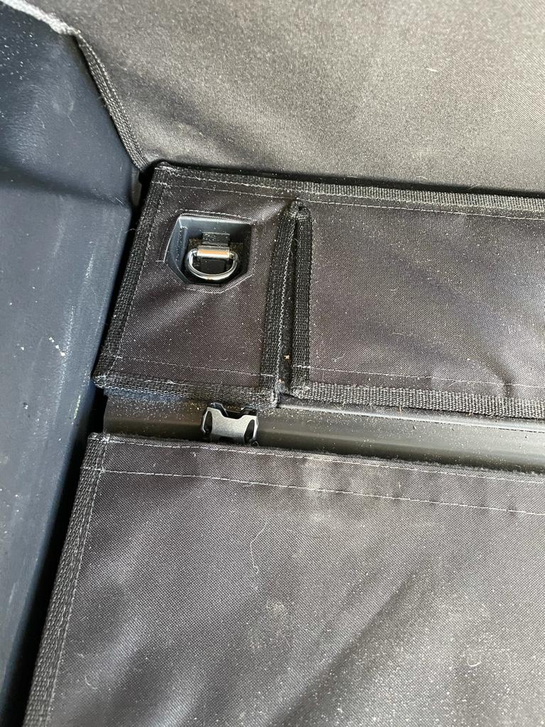

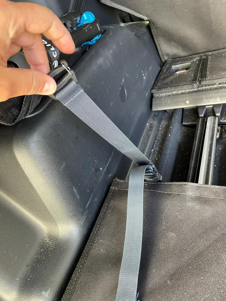

Followed some of the guidance here on adding tie downs to the cargo tray, but also possibly made some improvements
First I ordered straps from Shimoda seen here:
then I pulled the rubber carpet pins out with needle nose pliers
then I inserted the machine screws, washers and before tightening everyone, I ran the screw through the carabiner section of the shimada strap.
no drilling required, no need to peirce a strap through the middle. took 5 minutes per strap and feels very sturdy
Now I have quick releases and the tray closes normally without the buckle being an issue - it’s a perfect strap
