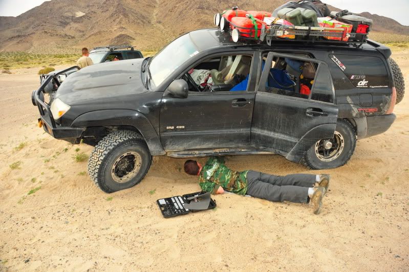

Caruther Canyon Was A breeze until that fateful moment...
DSC_0234-1.jpg~original
DSC_0283.jpg~original
When i started hearing a knocking sound!!
it appeared to be the driveshaft rubbing against the budbuilt gas skid, the was some severe wearing so i cut away...
DSC_0289.jpg~original
DSC_0298.jpg~original
crawled a bit more and the sound was gone, then it started again...
DSC_0279-1.jpg~original
we couldnt figure where it was coming from....
DSC_0309-1.jpg~original

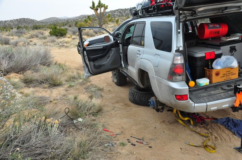

then i knew it was the axle, so i hopped out and removed the driveshaft in like 5 mins, and started again....

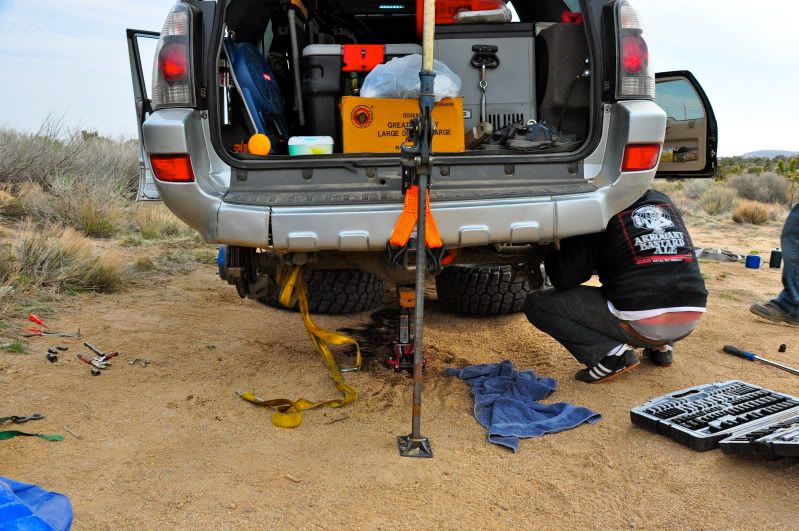

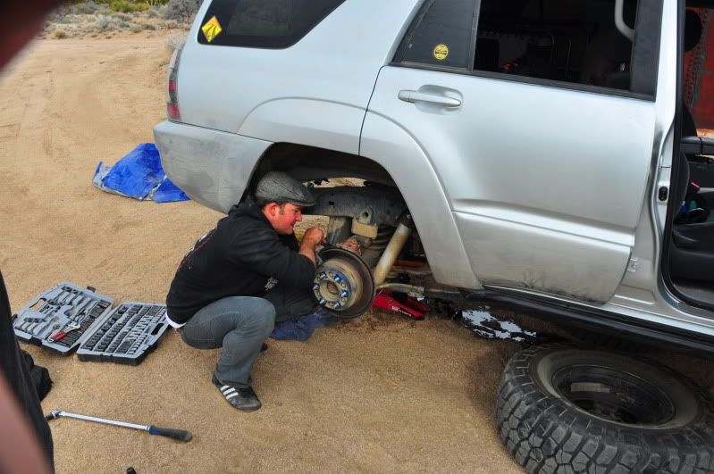

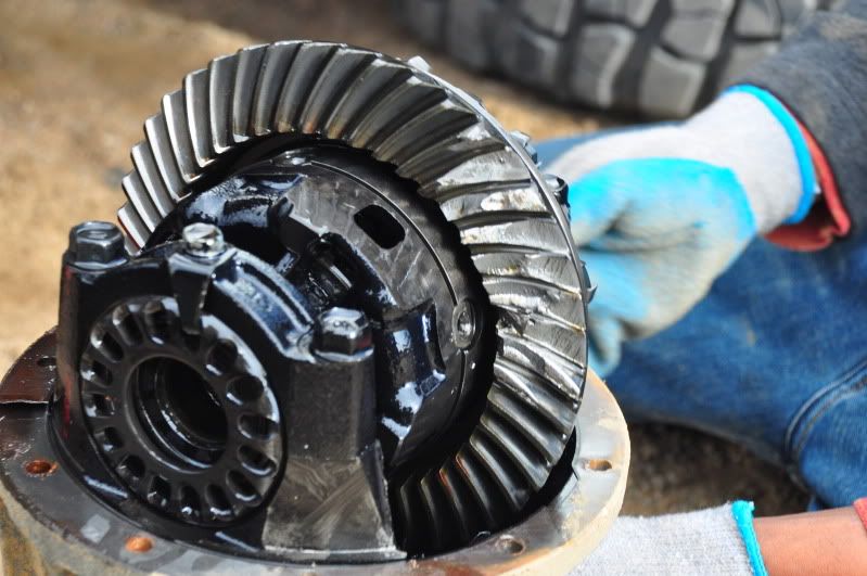

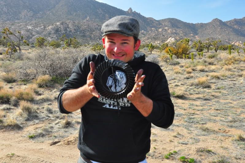

the truck was crawling then the rear axle was knocking and the wheels locking up!!! so i knew at that moment we went gonna make it outta the canyon on our own power until i removed the ring
then woody came to the rescue and towed us out at a slow pace of 5mph and a consistant knock coming from the axle
so we made it back down where the other were and explain the situation, we agreed that they would continue on and we would stay behind and get to work
so we bust out the bbq and got started!
DSC_0311-1.jpg~original
DSC_0315.jpg~original
DSC_0317.jpg~original
DSC_0318.jpg~original
DSC_0322.jpg~original
it was a bear to do, mainly because we only had a hilift and a small ass floor jack!
now i know why they call hilift's widowmakers, those things are scary and i know first hand how crappy they really are, next time i will be bringing my 6ton floor jack, if we would have had that, we could of saved 2 hours easy- the hi lift is impossible to work with, especially if your balancing the truck while you have to remove two tires!
DSC_0323.jpg~original
after the a close call of the hiliift slipping and dropping the truck we finally suceeded!
DSC_0326.jpg~original
DSC_0328.jpg~original
the mojave trophy
DSC_0329.jpg~original
after the Highlander mod was complete, we headed out to camp

Care to tell more about the "Highlander Mod"? LOL Did you have an extra gear ring with you or were you in front wheel drive only for the rest of the trip?
AWESOME pics! Thanks for sharing those!
I've always wanted to do an expedition style trail run. That is making me very jealous! Also goes to show that a lot can go wrong when you are out in the middle of nowhere. Glad you guys made it out without incendance.
thanks!!
yeah i think a expedition is really a great way to get to know your truck and what it can handle
well the highlander mod is the joke because i converted the truck into front wheel drive for the rest of the trip, i removed the drive shaft, removed the broken ring gear, put back together the third member and then locks the center diff so i can drive in front wheel drive, the truck still was a beast the rest of the trip but it was like learning to drive it all over again
