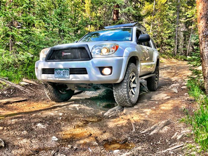

Hi everyone, here is my 2008 family truckster SR5. Just picked it up from the original owner with 105k and it's in great shape. Glad to be back in a 4Runner after over a decade of driving Tacomas.
This thread will show the work I've done, more to share info about "normal" mods- not planning on a solid axle swap anytime soon... Also, I plan on driving it all over the west so this will be a documentary on my travels.
Here is what I've done so far:
Old Man Emu 884 front springs with sport shocks, and Toytec superflex coils with OME shocks from a LC80 (it's the OME kit from toytec)
After about a thousand miles it sits at 23" up front center of hub to fender, and 24" in the back. RSG Offroad in Denver was able to get it into alignment without having to replace the UCAs. On a side note the OME front extends an extra inch compared to the original struts.
BFG mud terrain 255/75r17 take-off from a Rubicon, couldn't pass up 5 brand new tires for $500
RCI skid plates (front, transmission, and transfer case) and sliders. Everything bolted right up without any issues. I picked everything up at their place in Ft Collins. Very impressive operation where they make everything on site in a really clean and organized building. Super nice people, too.
CVJ CV axles with their long travel boot- the're red so good for 5 hp
Routine maintenance- all fluids changed, spark plugs, filters etc
Just roof basket on the OEM rack- seems sturdy and well built, nice and low profile. Bonus is that it also carries two bikes with a built in fork mount set up.

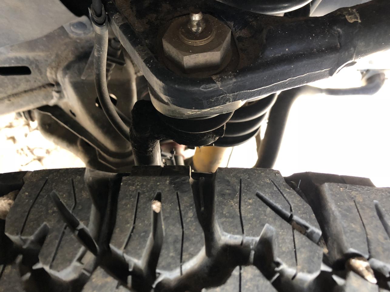

I joined the dark side and switched to 285/70r17s after being a fan of 255/80s for a few years. My biggest hesitation with the wider 33s was rubbing and bad gas mileage compared to skinny 33s. The trimming was just a small piece of the stock plastic bumper with the 4Runner trail/FJ cruiser wheels. And the new KO2 285 in load C is 8 pounds lighter per tire than the Cooper ST Maxx in 255/80r17, so my mileage has gone up 1.5 MPGs. Plus the ride is so much smoother with a softer and wider tire.

Plenty of UCA clearance without wheel spacers. I just needed to push the fender liner forward and trim a small section of the front bumper.
