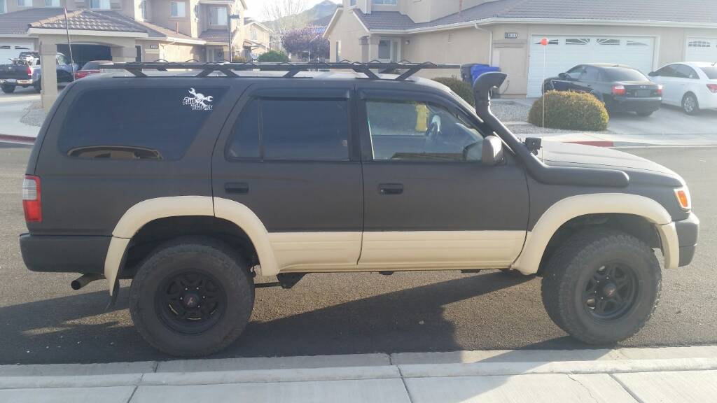

Hello T4R I have a 99 limited white and silver. My flares are faded and scratched up from wheeling. I plan on color matching them with the tintable monstaliner and 4runner natural white. For those of you with monstaliner experience how much do I need to order for the flares and side cladding only. I don't want to order the gallon kit and have a lot of leftover just go to waste. Also is adhesion promoter needed since these are plastic pieces? Your responses are greatly appreciated, thanks in advance!
I did it with a quart. You will want to hit it with the 3m paint removal pads (brown 3m pads) first to break up the clear coat really well. After that roll away.
Thanks for the response did you bother with the adhesion promoter? How is it holding up?
I did not use a adhesion promoter......although it probably wouldn't hurt since the moldings are poly urethane instead of metal.
Everything has held up pretty well if you ask me. Just don't bother using it on your mudflaps. It doesn't stick worth a darn and I ended up just removing it. I don't know why I thought it would stick there either lol. Everything on the fenders is doing well though.
I took this just the other week. I live in the desert so it's about as harsh as you can get for paint testing without adding salt into the mix.
