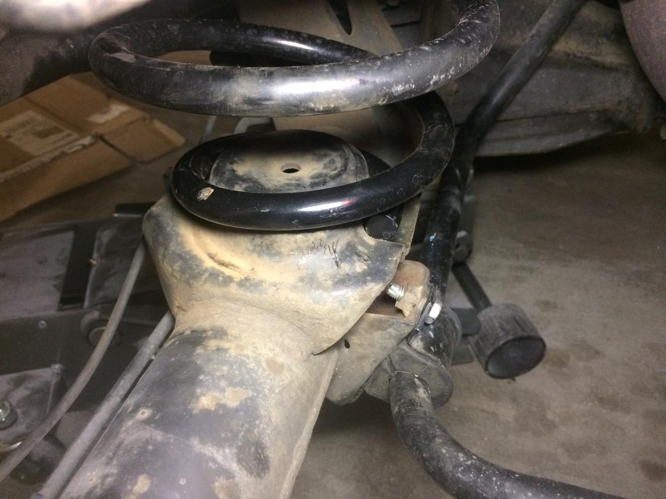

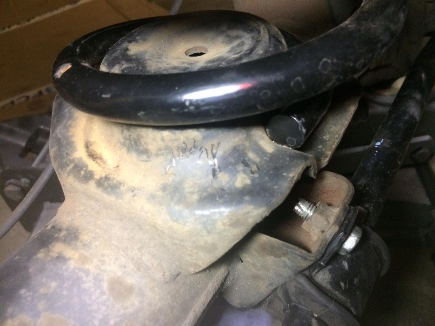

Since almost a year now since Moog 81045 was installed, Was it flushed to the bottom? I have 2006 Runner 4WD but when I installed the rear coil spring it will not seat properly no matter what. The bottom lower end of the rear coil springs diameter was small.
I wasted my $50 bucks for this rear coil springs.

From what I hear, that's a common issue with the Moog T4R rear springs. Some sets fit, others don't. People have had luck grinding away at the inner surface of the spring with an angle grinder if the difference in diameter isn't too massive.
I bought Moog FJ springs when I went to Bilstein 5100s.
The Moog rear coil ID was about 0.25 in too small. I ended up cutting off a 1/4 coil with the angle grinder, then got a good fit and still raised the rear about one inch.
I put back my OEM Toyota (yellow paint on the rear coil springs) back since moog81045 will not seat. I still dont know if i get OEM or upgrade it.
The poc Attached the moog 81045 that i removed was before i tried to slide to fit the groove. I did moved the spring to aligned the groove but with no luck.
Agsin I did slide the lower end bec it was sitting high next to the groove but still it will not seat.
more pics.
