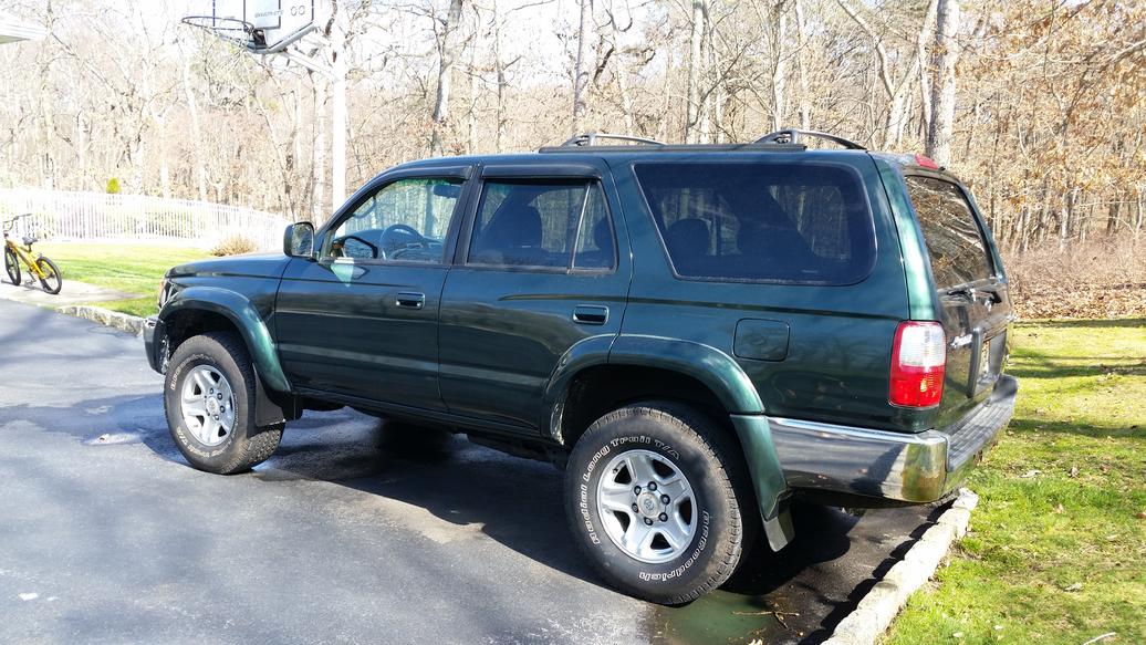

I was in the same dilemma as you a couple months ago. I wanted a mild ~2" inch lift. I don't do any rock crawling or push my truck to the limit, just occasional offroad use. I ended up with the 880/906 combo and opted for Tundra Bilstein 5100's in the front and 5100's for the rear aswell. Check out Wheeler's Offroad. They are a sponsor on here as well and it's where I ordered all my parts.
I love my setup, not too crazy but just right. It handles and rides great too. My stock suspension had 180k on it before I replaced it. I get rear slight rake as well and you have the option to adjust the front shocks to your liking.

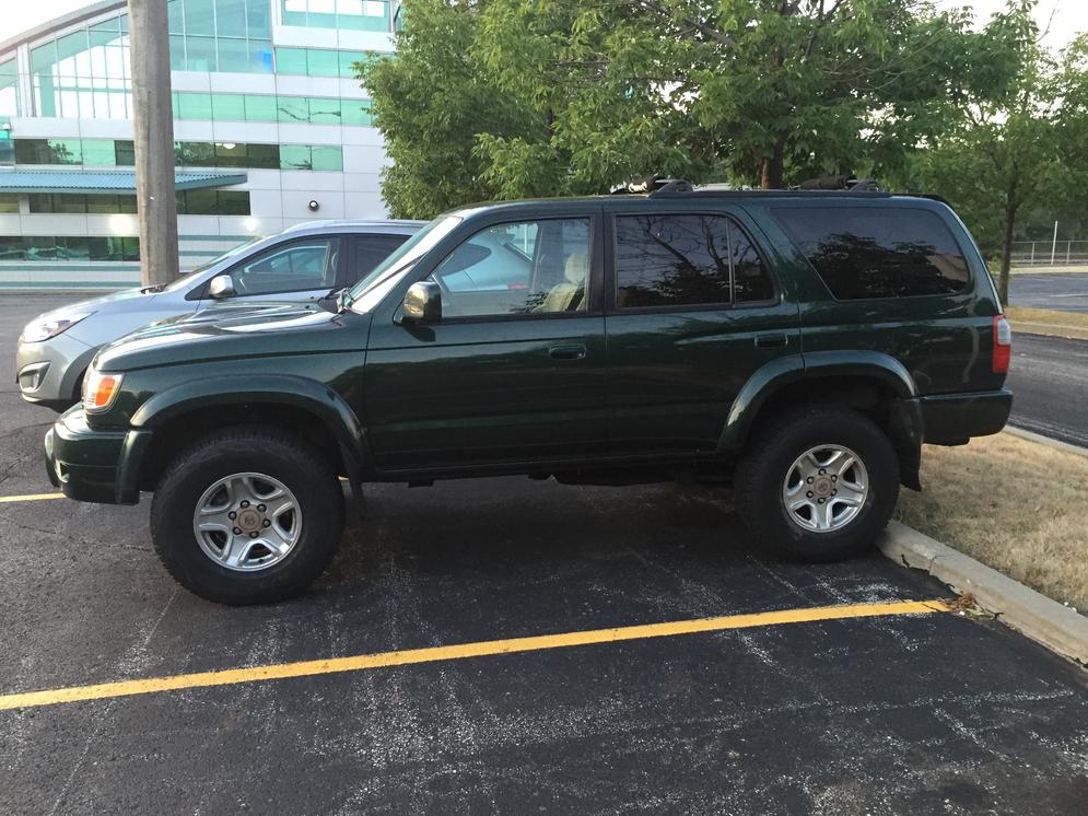

I went through the same process as well. Ended up with OME880/906 with Tundra 5100s up front on the second perch and KYB gas adjust in the rear. Went with the KYBs in the rear to save some $$ and they had good reviews. So far a like the ride. Pretty firm but I don't think it is harsh at all. Certainly better than the old suspension with 220K on it.
