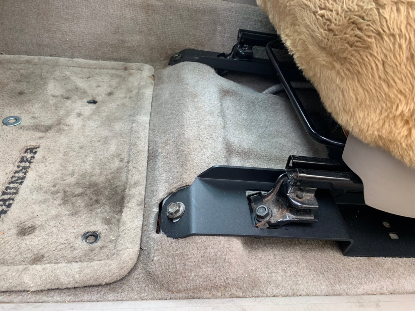

More Legroom
Looks like it just moves the seat back by relocating the bolt holes. Pretty simple and easy design to get more room. Out of curiosity, how tall are you to feel the need for this?
Please report back, very interesting. However, being 5'5" I have no need for these, but would be interested in moving the rear seat back a bit. Really doubt there is anything for that.
I’m 6’-3” with a 36” inseam. Now 60 years old the ONLY vehicle I’ve ever owned that had enough legroom was a 98 F150. I put Misch BigBoy Brackets in my 2016 Wrangler which made it fit perfectly and have been searching hard for something like that for the 4R and my DD Accord. Finally got them from this new place for both. I typically get very uncomfortable on long drives and especially stop and go traffic. I’ve been looking hard for a replacement of the 4R, considering 2019 4R TRD or Grand Cherokee but want more legroom than offered in either. That may change if this bracket company starts making them for those new vehicles.
I also cut the brake pedal on the 4R narrower so my size 11.5 shoes can fit on the gas pedal without hitting the brake pedal. You should be able to search to find info on that mod, night and day better for years now. I also stacked steel washers under the front of the OEM seat brackets to raise the front of the seat a little bit which helped a tiny bit, did that previously to my 90 Cherokee too.
I installed the seat extension brackets yesterday and they moved the seat back 4”. More than enough to make me happy. Installation was very easy.
