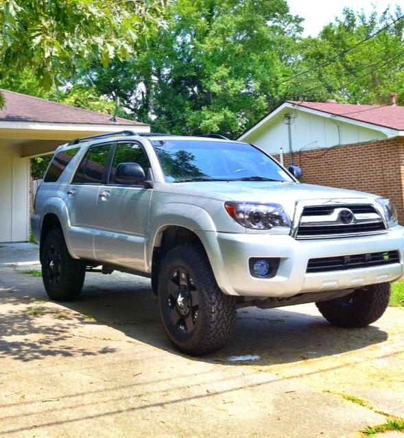

I have a 2007 4runner and i installed a 3 inch front 2 1/2 back Toytec leveling kit a few months ago, but its just not enough lift to fit the tires that i want on there. Does anybody have any suggestions, or could share what kit etc. they put on theirs to get extra lift? thank you

:iagree: body lift is about the only option you have for going higher unless you intend to drop a couple grand.
What size tires are you running now? And are you running the spacer kit or the coil lift.

What body lift would you recommend? The tires are only 265/70R17 currently. And thank you!

4crawler makes one, i think there was a 1.5" in the classified a while bakc that never sold.
[MENTION=63211]emelianenkov[/MENTION] makes 1/2" BL's which is probably all you would need to clear the tires. Nice rig.
I run LT 285/70R17 Nitto Terra Grapplers with minimal rubbing (only on turns due to stock wheels and severe compression/flex when off-roading) without a body lift using a 2.5" OverLand Warehouse lift kit. Depending which way you wanna go, BL would probably be chapest... but if you intend to use the truck, in the long run a good suspension would be a better investment.
Thank you everybody for the help. This is the first post I've done, and was surprised with all the responses. I'm gonna go ahead and get a body lift
if your rubbing with a lift and 265/70's have you moved the liners forward and trimmed any?

i think at 1"+ you have to do a steering extension and radiator drop. be warned
Just the steering extension. The radiator drop isn't necessary. I don't have one in my 1.25" BL...also don't have my steers extension on but that's another story
