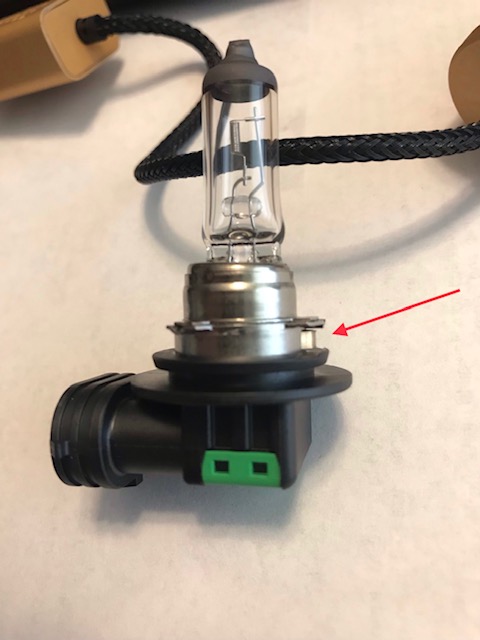

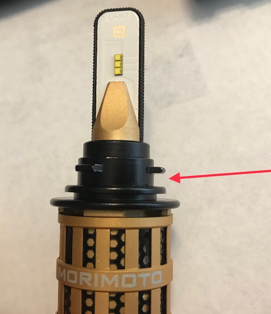

I've noticed the factory H11 has a little nub just below the widest blade on the mounting flange. The morimoto does not have this nub. Could this be the reason for it not locking in? Had to remove the gaskets to get a better pic. Also is the mounting bracket on the morimoto supposed to spin separately from the led? I noticed this was happening when trying to install them and i can do this by hand too. Thanks for your help

They are, just not as easily adjustable as other indexing LED housings. There are two O-rings that hold the H11 adapter to the LED housing. It's just a compression fitment, so it can be adjusted with the housing on the workbench but it's very tight. I had trouble with the throw of my first set of these, so I ended up tearing them apart to understand how they worked while I waited for my replacement set. The replacement set installed perfectly. If you look back a few posts, my problem was that the LED housing actually spun pretty freely when I attempted to "lock-in" the H11 adapter (should be quarter turn). TRS said that this was due to the O-rings and their had a revision to resolve this.
