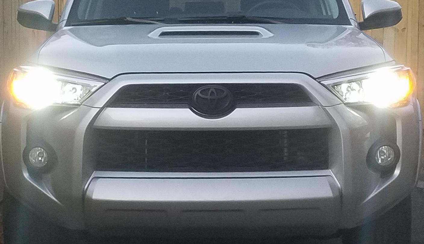

Morimoto 2 Stroke LED low beams and Diode Dynamics Fogs both turned on.

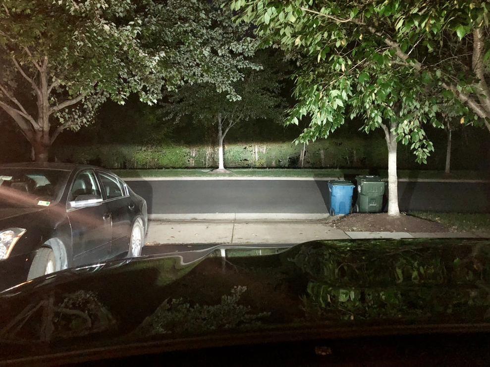

Does anyone have a bright spot from the bulb hitting right in front of the car? What is this? How do I fix this? Mine is only from my left bulb if you can see it.

I just installed mine last night. I noticed the same impact that you have there as well. I wonder if it was there before but I did not notice it because the stock light output was not as strong.

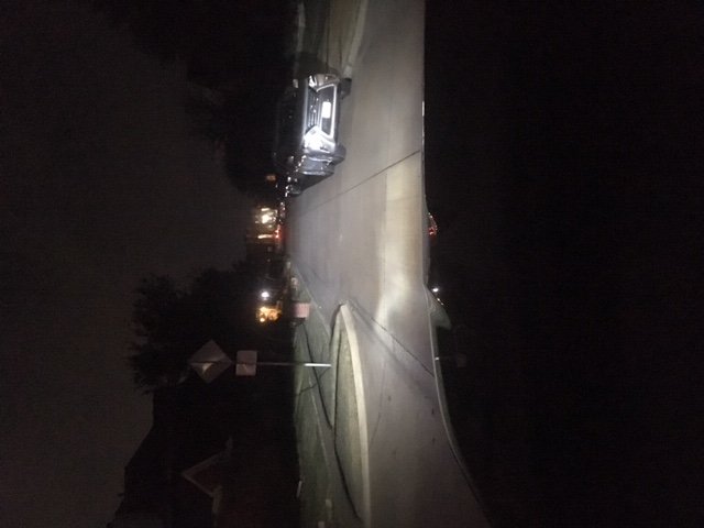

Installed. What others have said. Feels about 20% brighter. It does wash out with LED public lighting. But much better on highway in the dark.

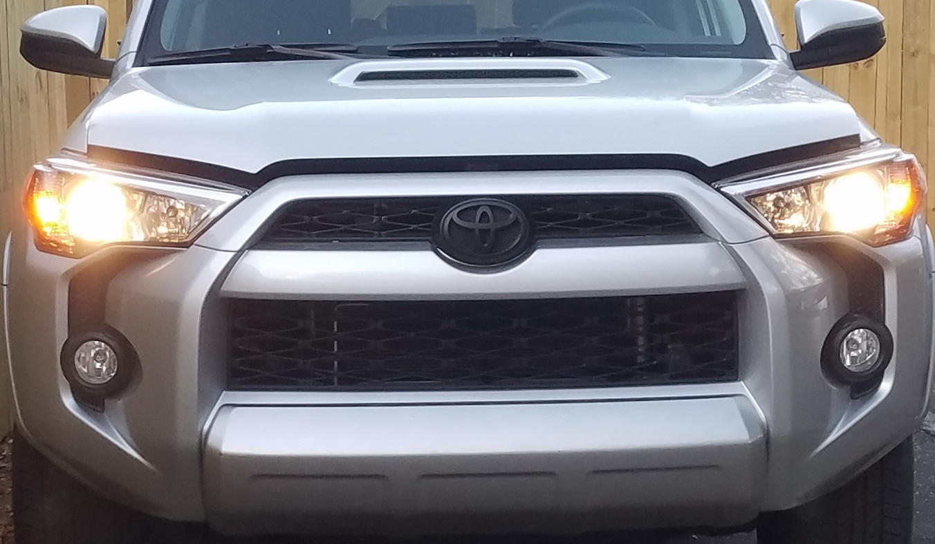

My H11 2.0's just came today. Simple 5 minute install and cant wait until dark to try them out. I was running modded H9 bulbs and they were slightly brighter than H11 but color match to my Xenon Depot 9005 high beams were terrible and im also running H11 led's in my fogs so now all should match up pretty close.

That doesn't look correct. Mine and a few others that I have seen in this thread do not have a hot spot. You should have a clear light pattern with nice cut off lines on the top end.
The only thing that I could think of is maybe the bulb is not turned all the way. When I was installing mine, I played around with the light pattern by turning the bulb in different directions. I found that the best/cleanest pattern was turned all the way until they stopped. The bulb created some funky light patterns when it wasn't turned all the way.

From what I understand, the bulbs must be rotated until the blades face horizontally (3 and 9 o'clock). When they are instated incorrectly, it can produce some strange hotspot and cutoff patterns. Xenon Depot makes their bulbs indexable, I'm a little worried that I won't be able to get the Morimotos to sit correctly because they are fixed.
That is probably accurate. Unfortunately with the projector, you can't see into the light to check how the LED is sitting (9&3 vs 12&6). I know with the high beam replacement you need a 9&3 placement.

So my initial review. The 2stroke 2.0 are definately brighter than the modded H9's. Not holy s*!$ I have to have them but brighter whiter light. They have a defined cut off and it appears to have a wider more usable light pattern. This first run was on dark back country roads. We'll see when in town or on a rainy night. But so far happy with them.

I checked on the bulb tonight and it was turned all the way. So I played with it a little, looking at the light on the wall and turned it the opposite way just a little and noticed the light on the wall pull together much better. Maybe 1/8 to 1/4 inch turn. So I'll see how it is in the morning.
