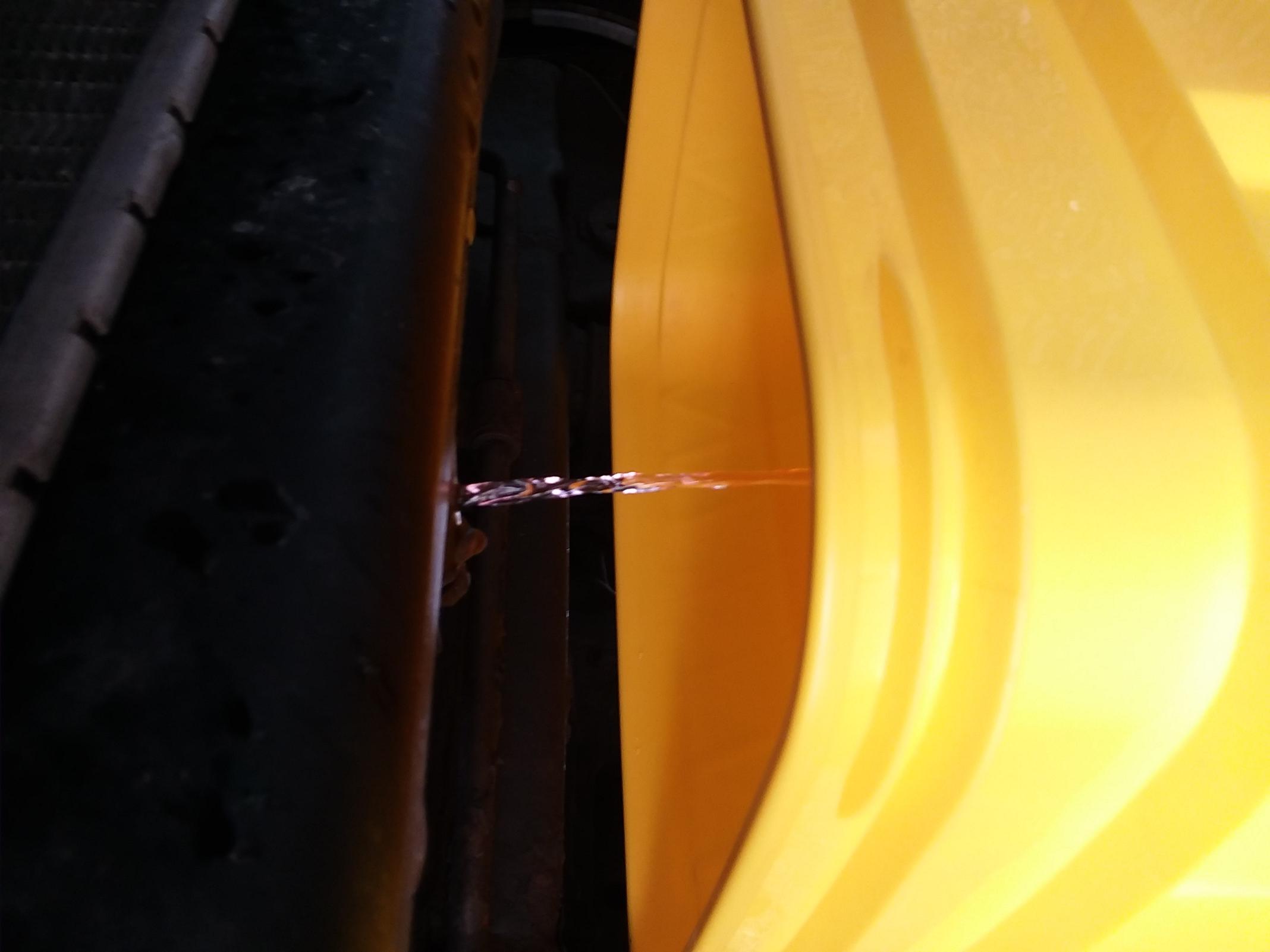

Coolant is clear and pink. Oil looks like oil always does. I have a valve cover gasket leak and my oil level is a tad bit lower than normal after 2k miles. Still in the safe zone though.
The smoke appears to be white but it is hard to tell because it is dark out. I am not sure about the smell. It only does it while I am backing down the driveway. It does not do it after work or any other time except early morning. I will focus on it tomorrow morning to see if I can snap a pix.
I have a fuel pump thread that I started recently and I think running out of gas has damaged my pump, causing that rough idle in the morning. I think it is not holding pressure but I cannot check due to no port on the rails. Still looking into this.
