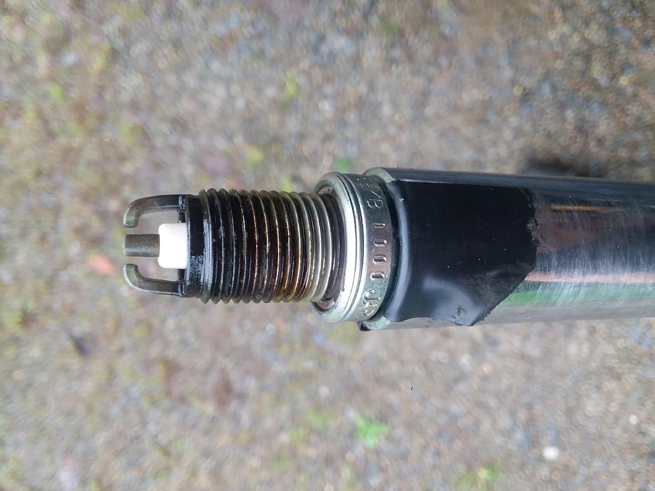

I decided to swap in some new ignition coils and checked the spark plugs while I was at it. Plug #3 has oil on it, not on the tip, but on the threads and leading up to the tip. This makes me think oil is getting on the plugs and burning off? I also noticed a bit of oil at the bottom of the throttle body and quite a bit on the hose connecting to it (blow by?).

How many miles do you have on that plug?
With the insulator being as white as it is usually indicates a very lean condition.
A plug with the correct fuel/air mix will be tan color insulator.
Plug with a rich fuel condition insulator will be dark brown/black.
Oil can also give a black insulator color.
From the look of plug electrode you don't have many miles on it looks new.
It has abt 16k miles on it. I replaced em in early 2017.
Does the other side of the plug look the same or is there a brown circle on it near the top of the insulator?
