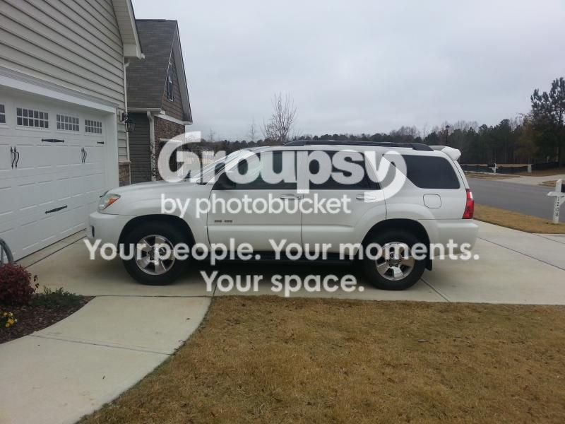

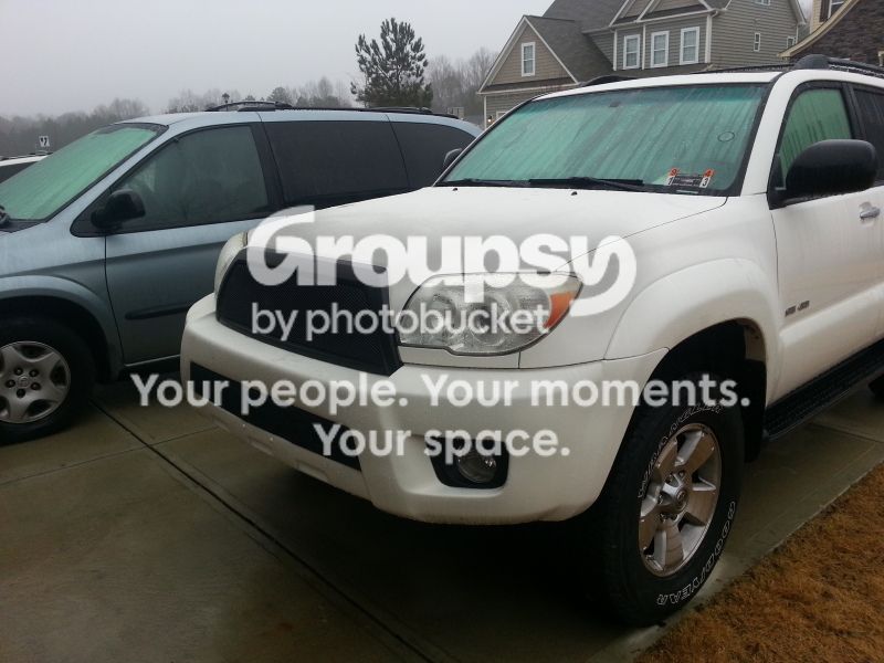

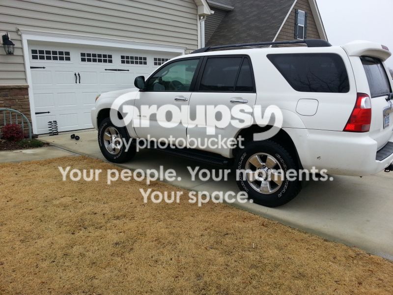

Ok so here it is with new FJ moog springs and bilstein shoicks set at .85 in the front.

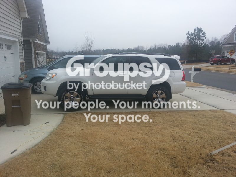

Here is the before picture for comparison.
I am kicking myself fornot taking before measurements and that the before pic is so bad. but after careful scrutiny I can say it looks higher in the back. But I am not sure. I am going to investigate further.
Anyone have stock height measurements?
Ok so I sit here with grease still on my hands to tell you. Changing shocks and springs sucks bad. Took me a solid day and a half. Maybe more like a day because we did a alot of jacking around yesterday. But I would say I have a solid 12 hours into this project on just the springs and shocks alone.

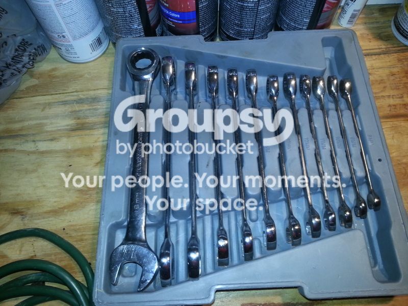

My one piece of advice, do not attempt this swap if you don't have a set of these.
These were a life saver. absolute must for working in tight places with the shocks.
As far as the lift, I appologize but I did not take before measurements. But on old worn out stock tires front sits at 35.5 both sides and the rear sits at almost 36" (right rear sits 36.5 but that is because the spring did not seat yet. I will work on that tomorrow).

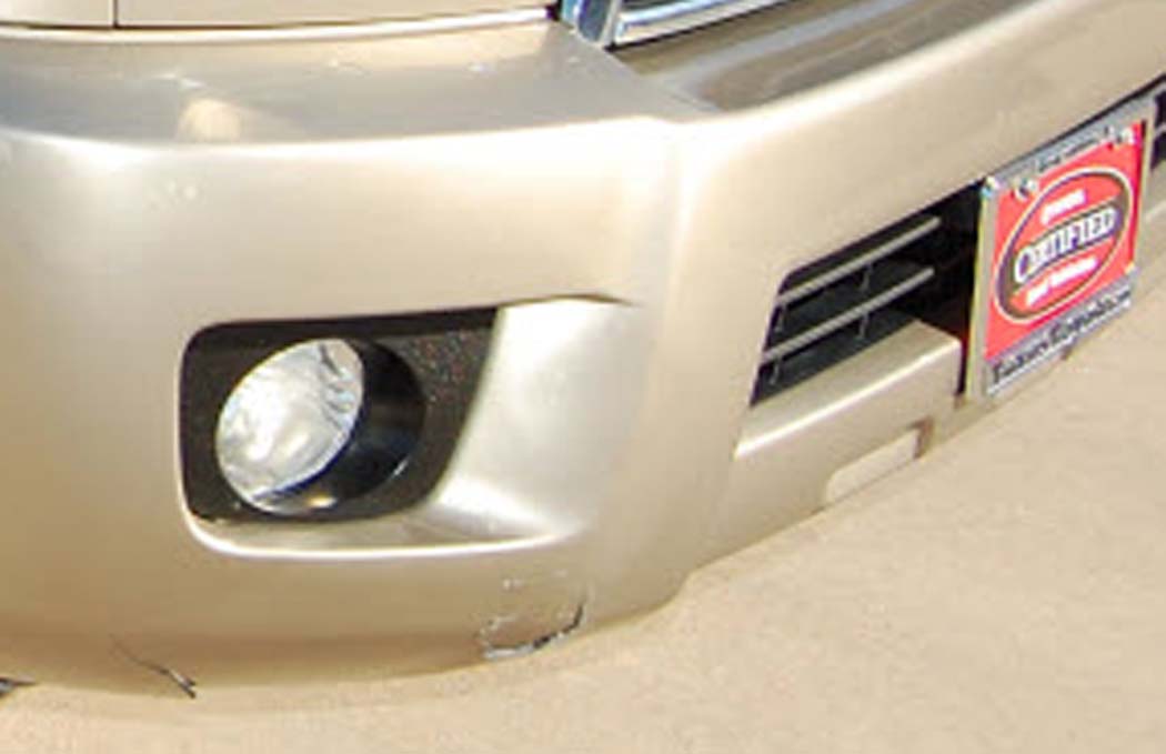

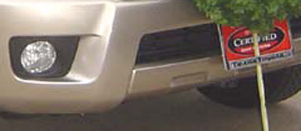

I need the same bumper repair that was repaired before I purchased the pre owned 07 4Runner V6 2WD SR5. My concern is that the repair had no flexing ability. It cracked from touching my rubber thread padded stop (dead in the weakest spot so slow I c/n feel any resistance).
My question: Did you repair with a material that will flex or hard and will crack before it flex? My purchase was a Certified Pre Owned and the Dealer said that method of repair is approved on Certified PO Sales. Would you or others know if that is correct (vs a flexible repair?
Attached are before and after repair pictures before the purchase.

DF - 36 3/8
PF - 36 3/4
DR - 37
PR - 37 3/8 (this is the onle with the half seated spring so if I ever get that ***** in then it will likely be 37)

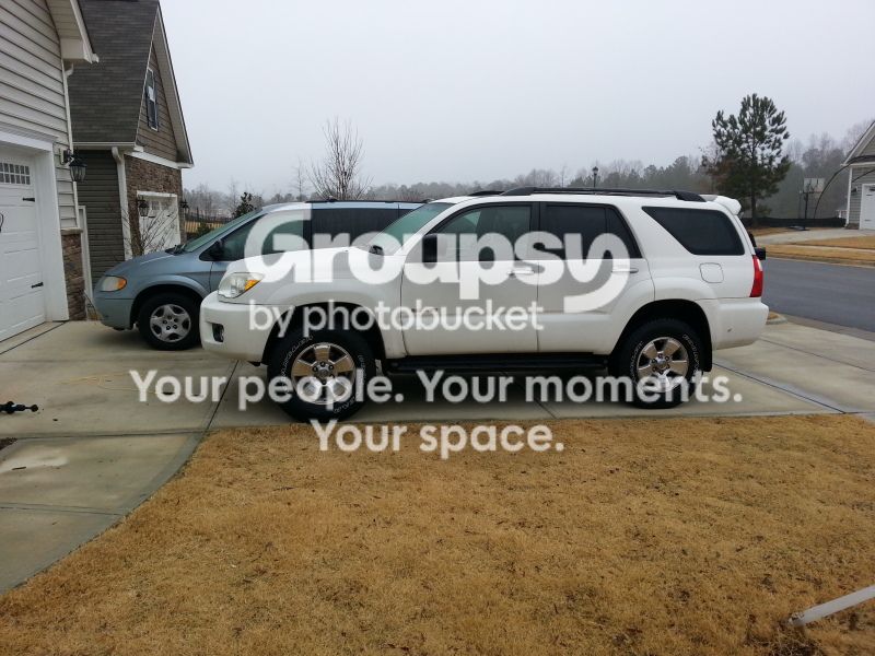

Final product. I LOVE this look. perfection has been achieved.

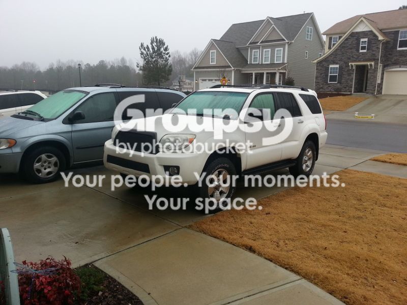

here is my before pic
after
Sorry for the horrible cell pic. I will try again tomorrow.

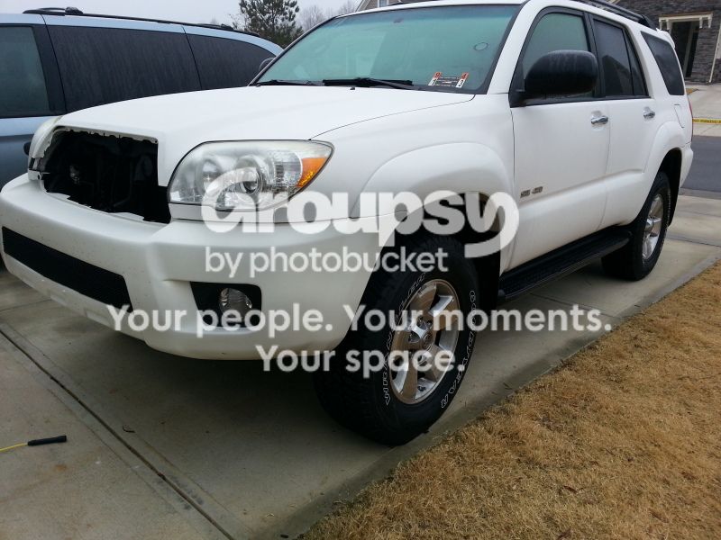

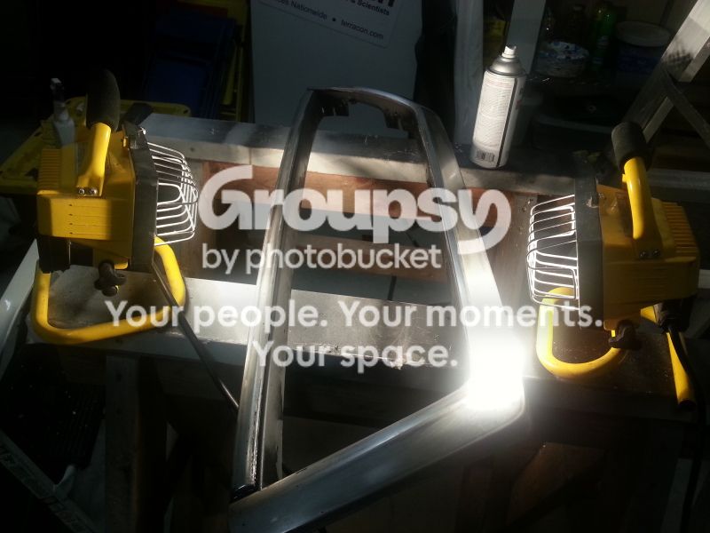

Lastly, I have been having fits getting my gril to take paint here is the thread on that.
http://www.toyota-4runner.org/4th-gen-t4rs/156478-painting-frustration.html
But I figured out what the problem was. The duplicolor body match paint that was cracking was applied where the rustoleum flat black over spray was thickest. Far as I can tell, the two are completely incompatible. Even after a couple rounds of sanding and cleaning with alcohol and acetone it still cracked. So I got pissed and painted the whole thing flat black.
Which I love and hate at the same time. So last night I disassembled the grill and got some etching primer and am going to have another go at it the right way.
Back to chrome, sanded and cleaned with acetone and a slapdash of black put on. Gonna let this dry and then tape over it and then it is on to the etching primer.
Should be done and on by the end of the week.
