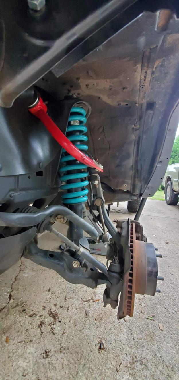

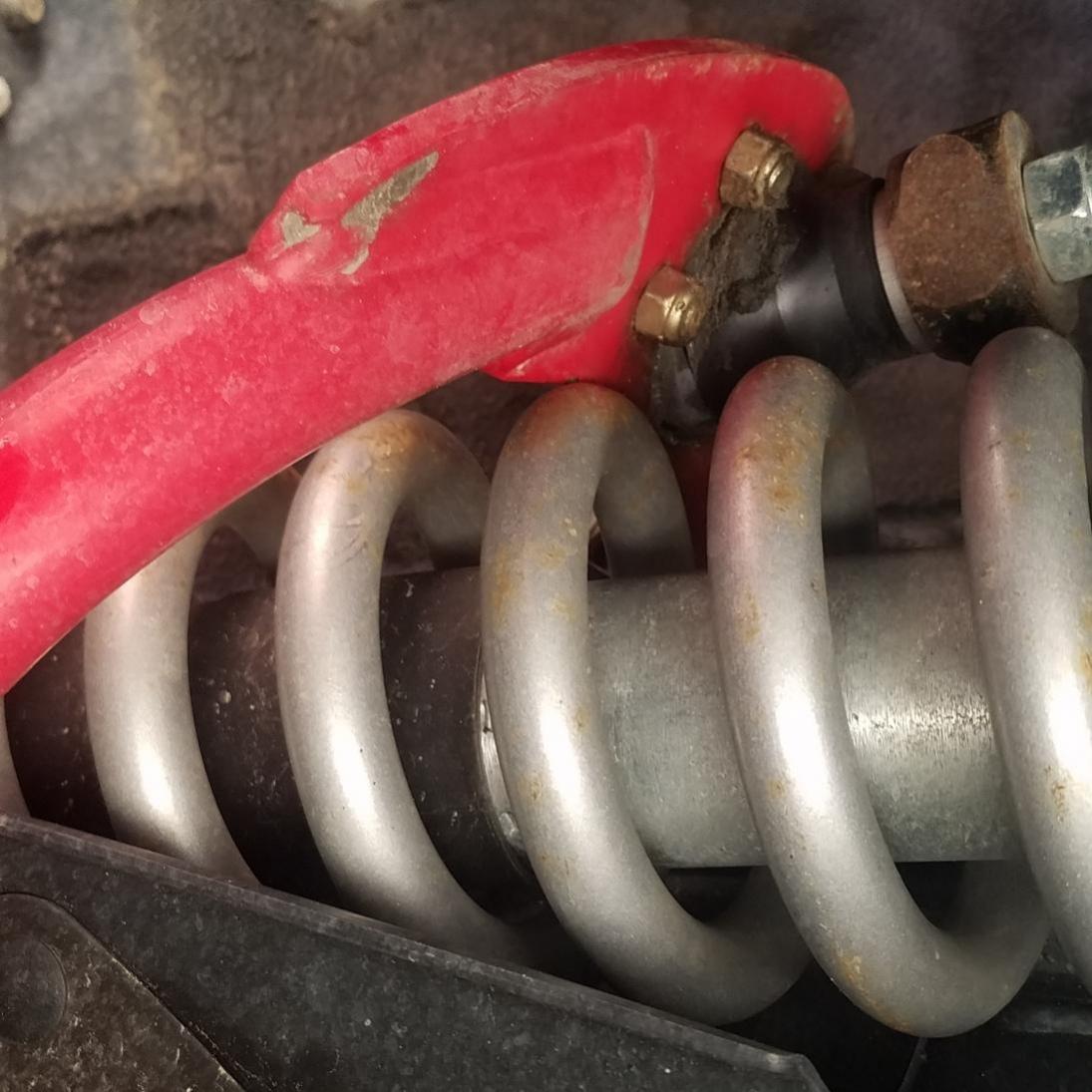

Read the fine print with these. There are some reported issues with the UCA hitting the coil at full droop. May or may not be an issue in your situation
JBA STD High Caster Upper A-arms for 2005-14 Toyota Tacoma, 4Runner, FJ Cruiser
Yeah, I only just found out about that 2 weeks ago when a customer sent in a photo, then I found out from some Tacoma guys that it can be an issue too with the JBA's and longer travel struts. Due to this, I can't recommend them for the long travel struts (GS59-574 or GS59-220) that we offer anymore.
First photo is Dobinsons GS59-574, 2nd photo is Bilstein 5100's, both at full extension. With standard length struts, they're probably ok.

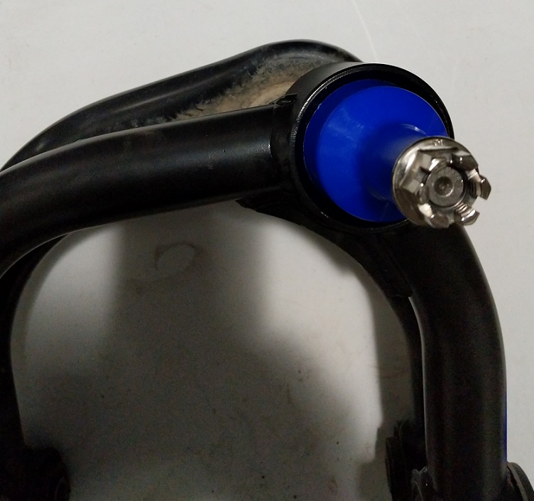

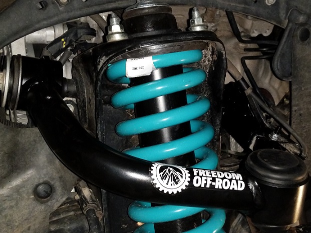

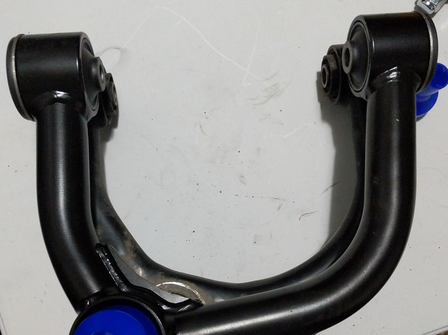

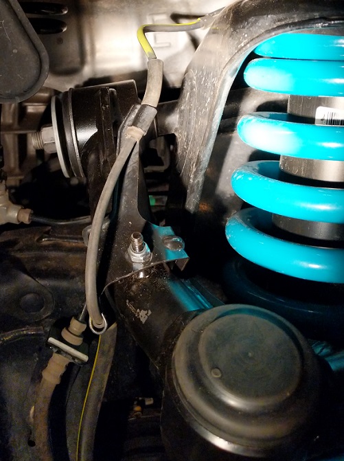

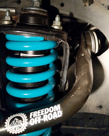

I'm running a 2.5" lift (it's sitting at 2.7") and I went with the Freedom Offroad UCA's.
People don't like them because they are a "lesser quality arm". So far I haven't found issues with them, the welds were great, and the fit was perfect. Lots of reviews on Tacoma World.
I probably didn't need them but I'm happy I got them. Caster is at a 3.6 and the truck rides a bit smoother than on OEM arms. Between Ebay sales and other sales, you can sometimes find them for under $300 shipped.

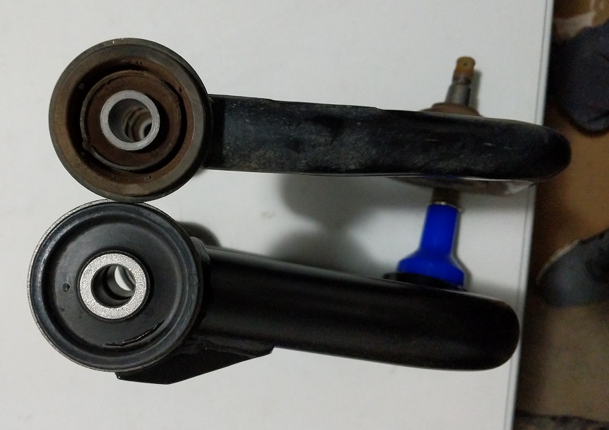

Couple of things I'd like to clarify from my research before buying the Freedom Offroad arms.
1. These are OEM style ball joints, not uniballs, so I'm a bit less concerned about a failure like your Uniball UCA's (glad there was no major damage or injuries BTW!). From my understanding, your uniballs actually pulled through the uniball due to the bolt being smaller than the hole in the uniball?
2. These are made in Taiwan, not China. Not saying that changes much/if anything with the long term quality one way or the other, but seems like manufacturing is usually a little better from Taiwan :shrug: I highly doubt they are the same as the Ebay junk/Alibaba arms as they don't even look the same (different gussets, weld quality in images alone is better etc.)
3. These do have built in caster correction. There is no way I was pulling a 3.6 caster with my lift at 2.7" (hub to fender measurements) on OEM arms. Also, you can see it in the attached image. It's not nearly the caster you can get from SPC's but it's also fixed.
4. I ordered based on multiple reviews from people running for years on Tacoma World without issue. Was there some hesitation since they aren't TC/SPC/JBA? Definitely. So far am I satisfied with them? Yup.
5. If I recall correctly (can't find the image anymore for the 4Runner UCA's, but did find one for Nissan Titan SPC's) the SPC arms are made in China but assembled here in Colorado.
So they might be Chinese junk, they might not be. What i do know is the build quality looks great, I've had no issues so far, they are a serviceable and replaceable ball joint, and have a lifetime warranty.
Not trying to start an argument, but to have some good conversation on these, as I appreciate the input and knowledge you provide to the forum, as seem recently in another thread. So far I've only got about 100 miles of bashing offroad on them, so they will be inspected, as they are new. Just trying to provide as much information as possible to people.
