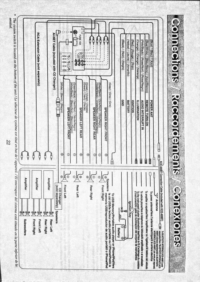

Behind your stereo there should be a wiring harness that goes between your stereo and the actual trucks wiring harness. These have pretty much universal coloring codes and I believe the color you are looking for is solid blue. Snip snip...
