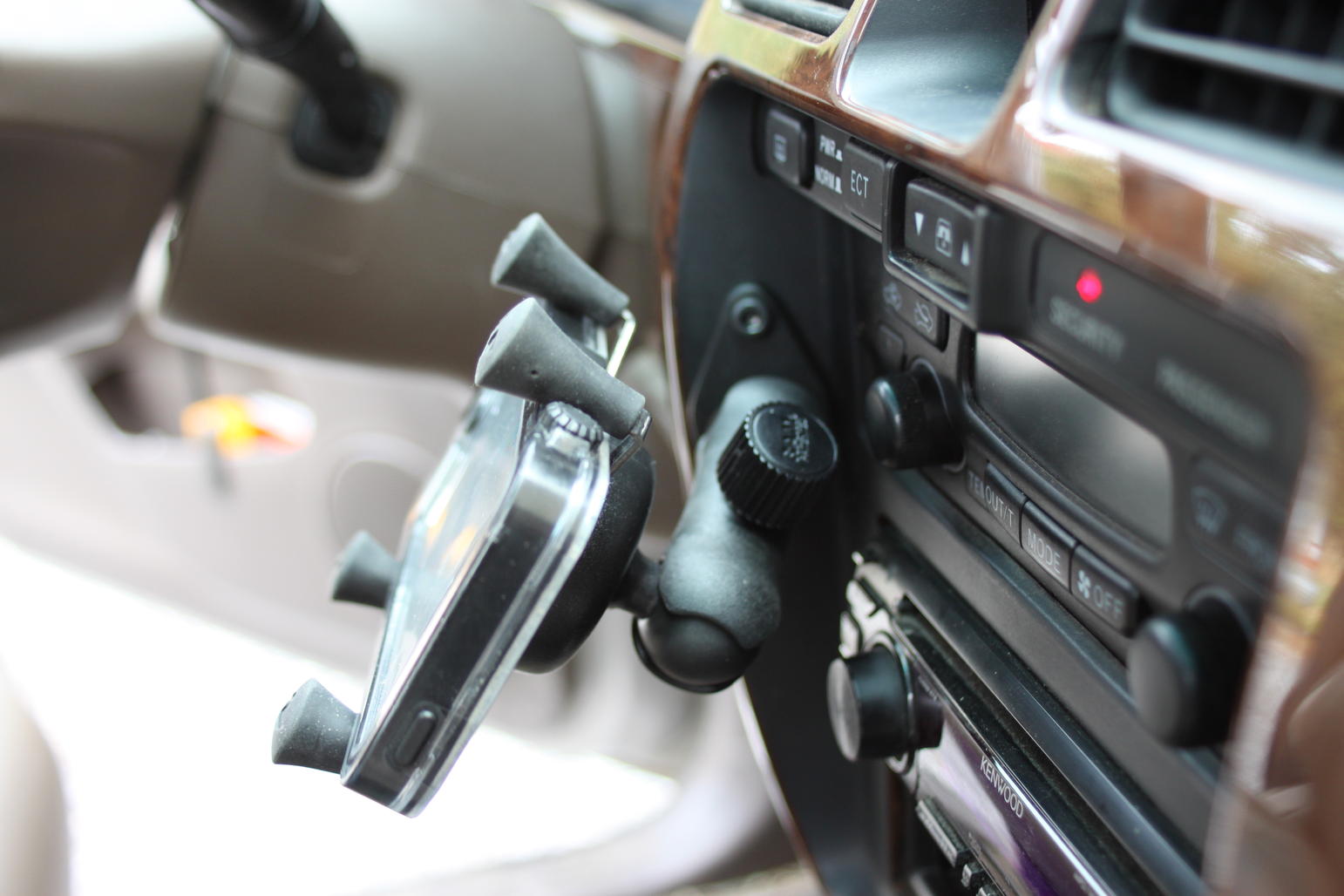

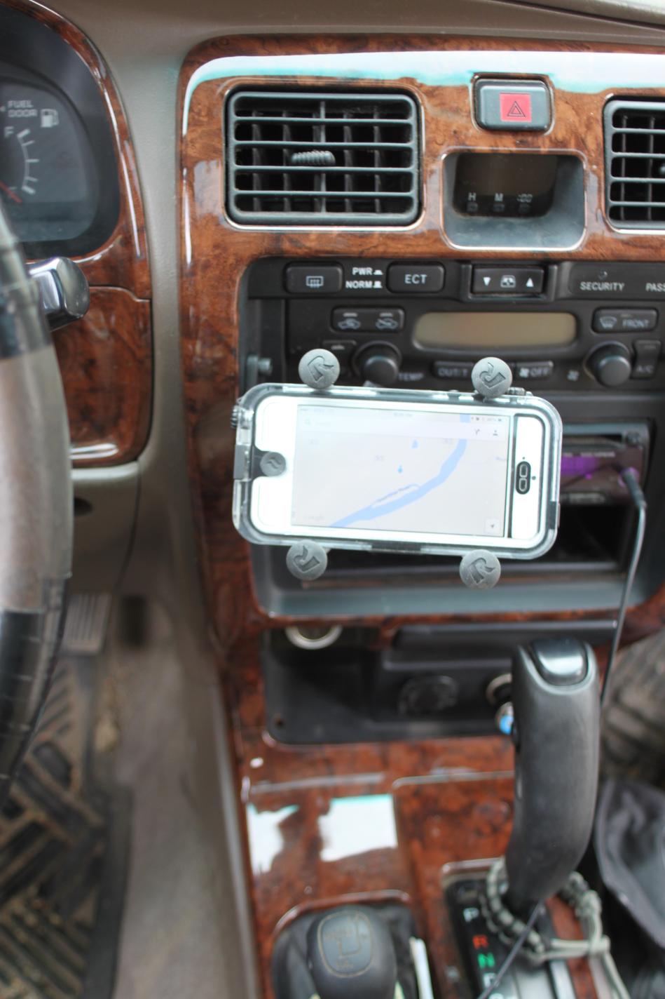

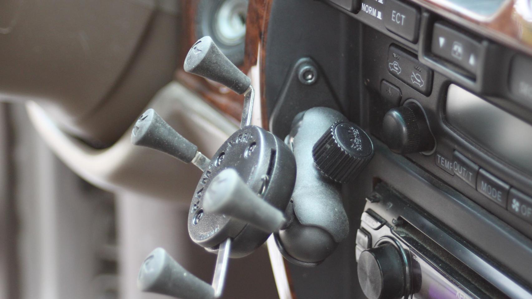

Wanted to show some pics of the Ram Mount modification we did in the T4R. Removed the "wood" trim piece and cut an aluminum back plate to go behind the mount. ordered the ball mount separately. This makes for a really solid set up. We are building and running GPX files on the GAIA GPS application. Its really perfect.
Looks good. Another bracket option is the Panavise bracket. It holds your cradle on the right side of the radio and is pretty solid too. Downsides though are its a bit further away (yours is closer and easier to reach) and the passenger can end up banging their knee on it depending on how tall they are. RAM products are good stuff, enjoying watching your build!

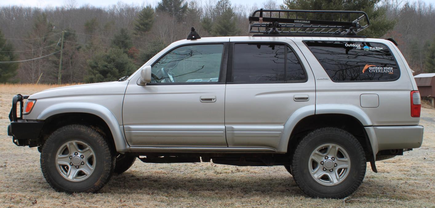

Here is a shot after the old man emu suspension addition. this is without any weight added to the rear end, which will receive some storage options and other accessories.

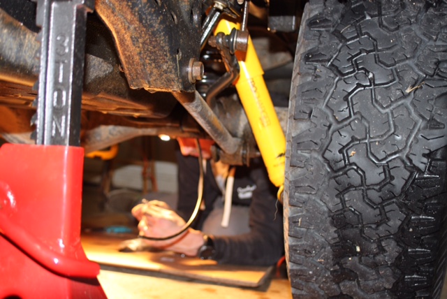

front end getting some old man emu love as well. Went with the "prado" front springs as recommended by Matt with ARB4X4 USA. Designed for holding front end weight. The rear OME's are 890's, plenty stiff for holding a lot of cargo weight.

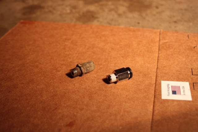

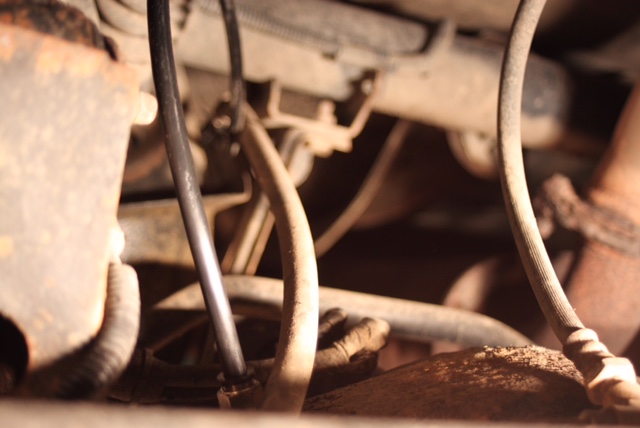

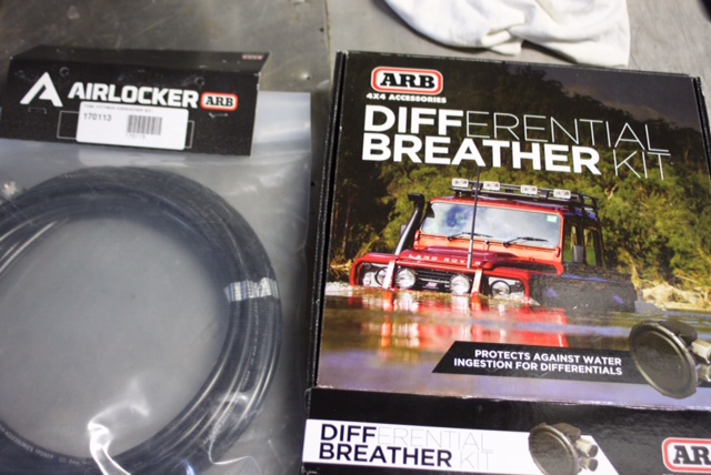

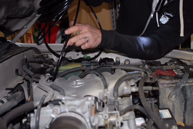

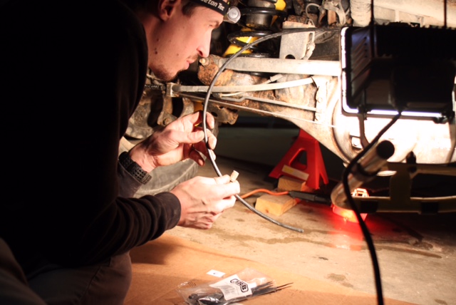

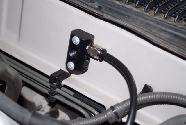

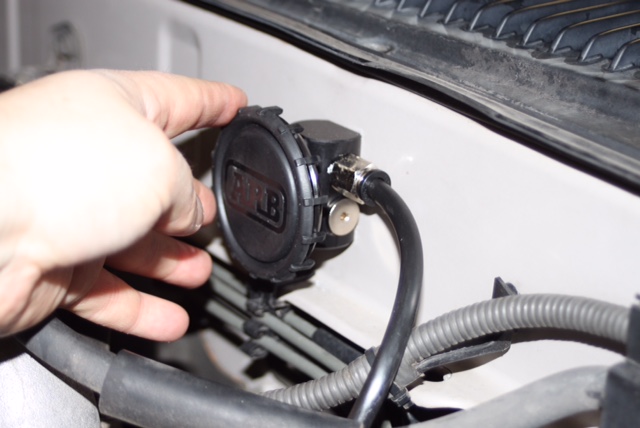

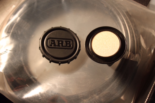

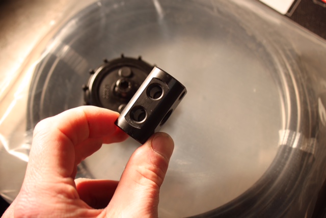

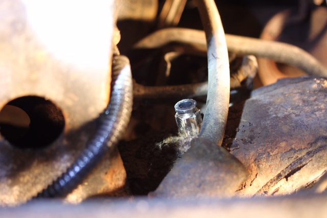

I wanted to take a minute and share some photos of the ARB Differential Breather install that we did on the 4Runner. This was a straight forward kit and was very easy to install. We opted to run the breather to the top of the engine bay with the possibility to extend the front diff breather if we really wanted too, even though it is already extended in stock form. We spend a fair bit of time doing water crossings and wanted to be sure we didnt toast our rear differential.
and wrapping it all up. everything you need is in the kit and took maybe an hour to install stopping for a suds break and taking some pics. Enjoy!!

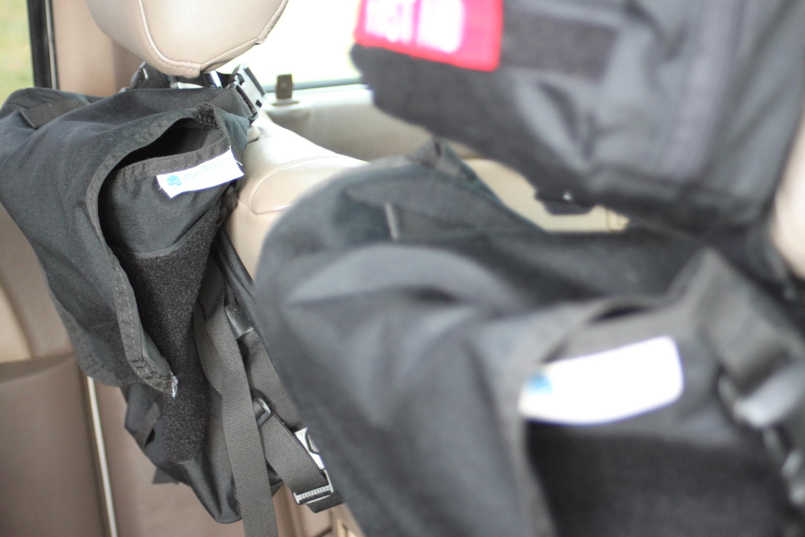

Wanted to show some of our organizational items in the rig. We came across Blue Ridge Overland Gear just out our back door (literally) and have been continuously impressed by their made in USA products. This is a photo of their headrest bag. Great for stashing on the go necessity.

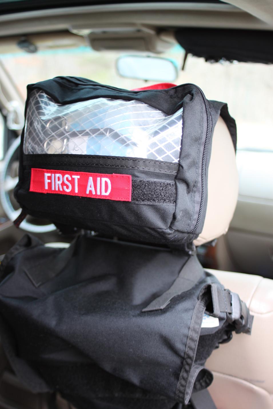

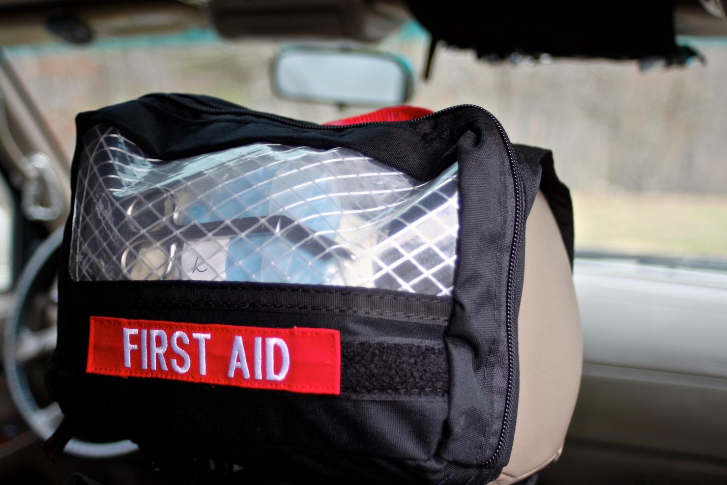

After enough incidents kayaking, mountain biking, or simple camp hijinks we have always kept a pretty well stocked first aid kit. With a headrest molle panel and first aid bag from Blue Ridge Overland Gear we are well equipped and organized for life on the trail. It is easily pulled off the molle panel and you always know where it is when things get a little serious.

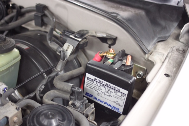

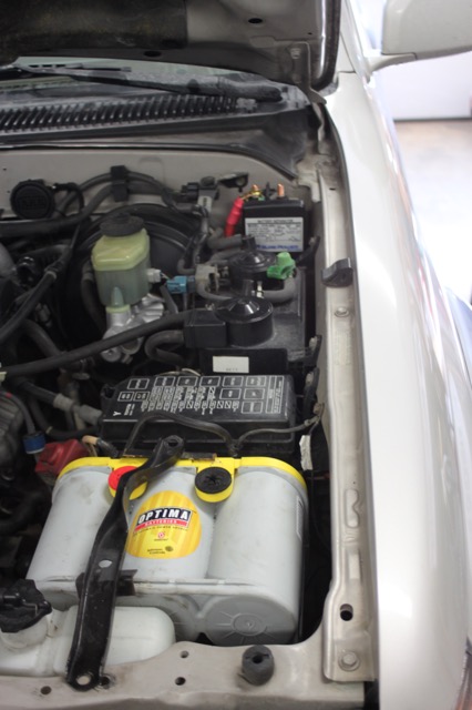

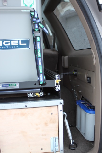

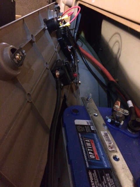

Wanted to update the build thread with some pictures of the dual battery set up that went into the 4runner. Decided to go with a SurePower 200 amp smart seperator to link the two Optimas running the "house battery" in the back. Created a better hold down for that yellow top optima after taking that picture BTW.

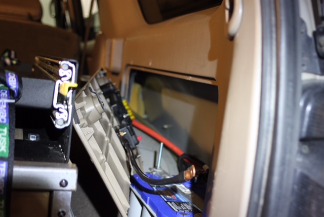

Ran #2 wire through firewall and under door sill trim to the rear of the vehicle and tied to the house battery in the back. It went pretty well, getting that heavy gauge wire through the firewall grommet on the drivers side was somewhat tricky but not terrible. We cut out the existing storage bin in the rear passenger side and strapped the battery to part of the body which creates a super heavy duty tie down point.

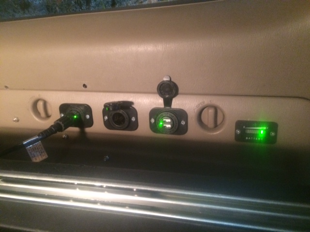

That panel allowed for mounting a couple Blue Sea DC outlets and one dual USB outlets with plenty of room to spare. Also wired in a battery meter just to keep a visual on the battery charge. A Blue Sea fuse block is mounted to the back of the panel with a 100 amp circuit breaker as well. Very happy with this install for running the Engel Fridge and charging other items on the fly like cameras/phones/tablets/Bose Soundlink etc. Will likely add an inverter at some point in that area as well.

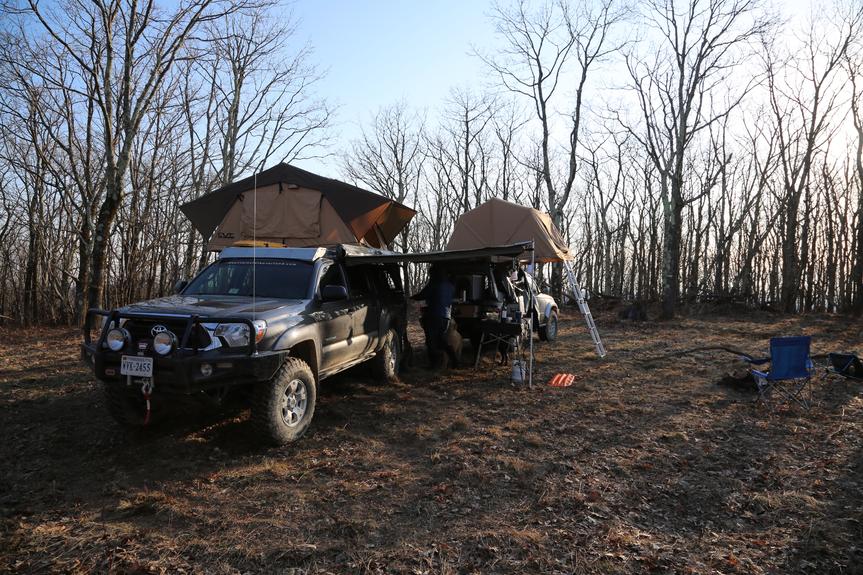

In this pre-season episode of Mountain State Overland, Team MSO hauls the camera equipment over to Greenbrier Offroad Adventures to put their recent truck builds to the test. With a few lessons to learn, the Team preps themselves for their travels in southern Appalachia during Season 2.
TRIP REPORT by Jamie - Team MSO Cook
When we started planning this excursion it was a means to an ends. We were hoping to get out in the woods and have a little fun while filming some footage and testing out some of the gear. Let me give you some details about our hosts - Chris is the owner of Greenbrier Off-Road Adventures LLC, and Tracy is one of the instructors; both a great resource when we found ourselves in a pickle. Their trails are located on the property of the world famous Greenbrier Resort. Their vehicles of choice are specially equipped Jeep Wrangler Rubicons and let me tell you one thing - they are beefy rigs! These highly trained guides accompany and instruct guests on advanced driving techniques necessary to traverse The Greenbrier's private 10,000 acre mountain preserve. The terrain varies from modest unpaved roads to some seriously extreme terrain. The thirty-mile course has rocks, ruts, creek crossings, steep hills, gulleys and mud pits. We felt this was the perfect place for us to test out our skills.
In a nutshell, we had a great time with Greenbrier Off-Road Adventures LLC! They are a solid group of guys and they love getting out on the trails and showing people how it’s done. They were able to help us cut our teeth and introduce to the recovery options available when using ARB bumpers, Warn Zeon winches and Maxtrax to help navigate the obstacle that presented themselves. I'll have to tell you that they certainly didn't take it easy on us either. Within the first hour we were up to our waists in mud pits and rocky rutted terrain. There were several occasion that we got in a little over our head and thanks to the efforts and training we were able to get out of the the tight spots and keep pushing forward. The entire trip lasted around 4-6 hours. It was some of the most extreme 4X4 action that I personally have ever seen. We gained a lot of knowledge and experience that will aid us in our adventures to come for Season 2.
