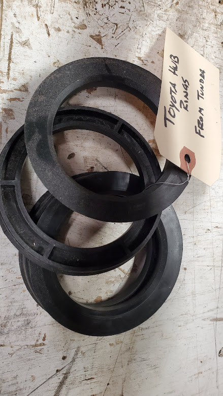

Oddly enough I think I know what you're looking for. PM me your mailing address and you can have these for shipping cost.
I bought some secondhand OEM wheels from a Tundra for my Tacoma (same lug pattern) but it had these plastic rings snapped into the center holes, presumably to help with centering.
