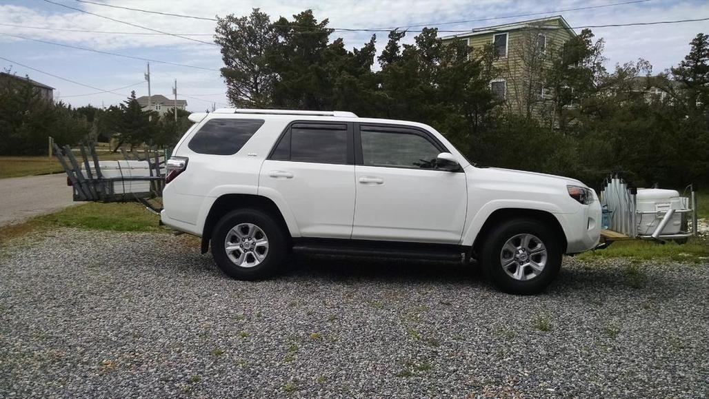

Maybe you need a rear rack for all that surf fishin' stuff like me. Note the shelf in front that would accommodate a HI-Lift if needed. :bigok:
Oh my goodness! I thought I carried a lot of stuff : 0
That’s aesome Salvo!
I do want to carry it inside so it’s more protected from theft & it dosen’t get all muddy, icy etc.

16 rod holders? Awesome! Reminds me of the quail rigs in Texas. I would love to learn the surf casting ropes from you if you have the time.

The best person to teach you the technique is Ryan White at Hatteras Jack in Rodanthe NC. He gives good reasonably priced lessons. Highly recommended.
