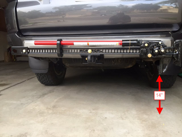

If you've dragged your tailpipe on rocks then you would almost certainly hit the runner on the jack, too. On my stock suspension, the clearance is 14" for the runner while the pipe is 16"
If I'm going over a rock on that side, then I switch on the rear camera override to get a look. So far, no issues. I've seen on this thread pictures of a mount where you can have the runner facing up. I wonder where that mount comes from. The mount I have will not allow the jack to be flipped the other way since only one bolt holds it in and it has a "shelf" to keep it from moving, thus you can't have the round handle facing down. You could mount it upside-down, but then the entire jack is low clearance and not just the runner!
The other disadvantage of this mount is that your hi-lift will get completely covered in dust, just like everything else on the back of a 4Runner.

If you're doing any serious rock crawling you're going to f up a hi lift with one of these mounts. I constantly drag my trailer hitch, bumper and have crushed the exhaust until it was almost completely closed.
I mounted my Hi-Lift on the rear bumper similarly to what is shown above. Made one off-road trip and said "Nope, that won't do". It now rides on top of my roof rack bolted down to the crossbars. Much better place for it.

So I ordered and installed the gowesty part and went out wheeling last Friday. Lets just say that part is not meant to go off-roading!!
The only way to mount the hi-lift with the gowesty is like what proimion posted. The flat side of the hi-lift lay on top of a shelf so the pointy part of the hi-lift hangs down. That part got hit by a rock when going down a rock last week which bent the mount and pivoted the hi-lift against the bumper :AK47:
From now on, I'll just toss it in the backseat when I go off-roading. The front mount looks great hmmm

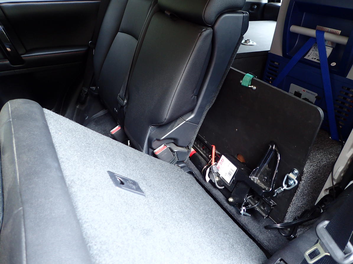

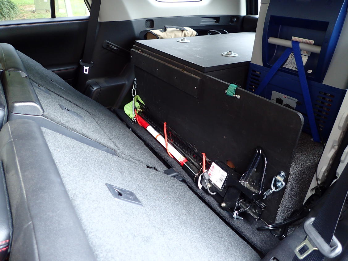

I keep mine behind the back seat. It's wedged between the back of the seats and the homebuilt storage box.
