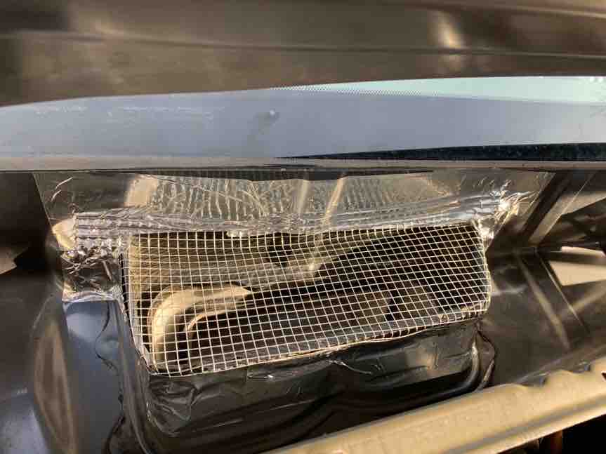

Same thing in the Sienna community. Some put a wire mesh over the air inlet to stop them getting in in the first place. I wonder how hard that would be?

Don’t think it’s too difficult to put a mesh over the intake. There are some posts on here showing how it’s done. I was just worried that’s not the way they are getting in since I’ve found my filter intact. Maybe they are getting around it in some way. Wanted to check in for other possibilities first.

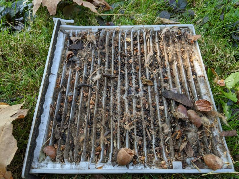

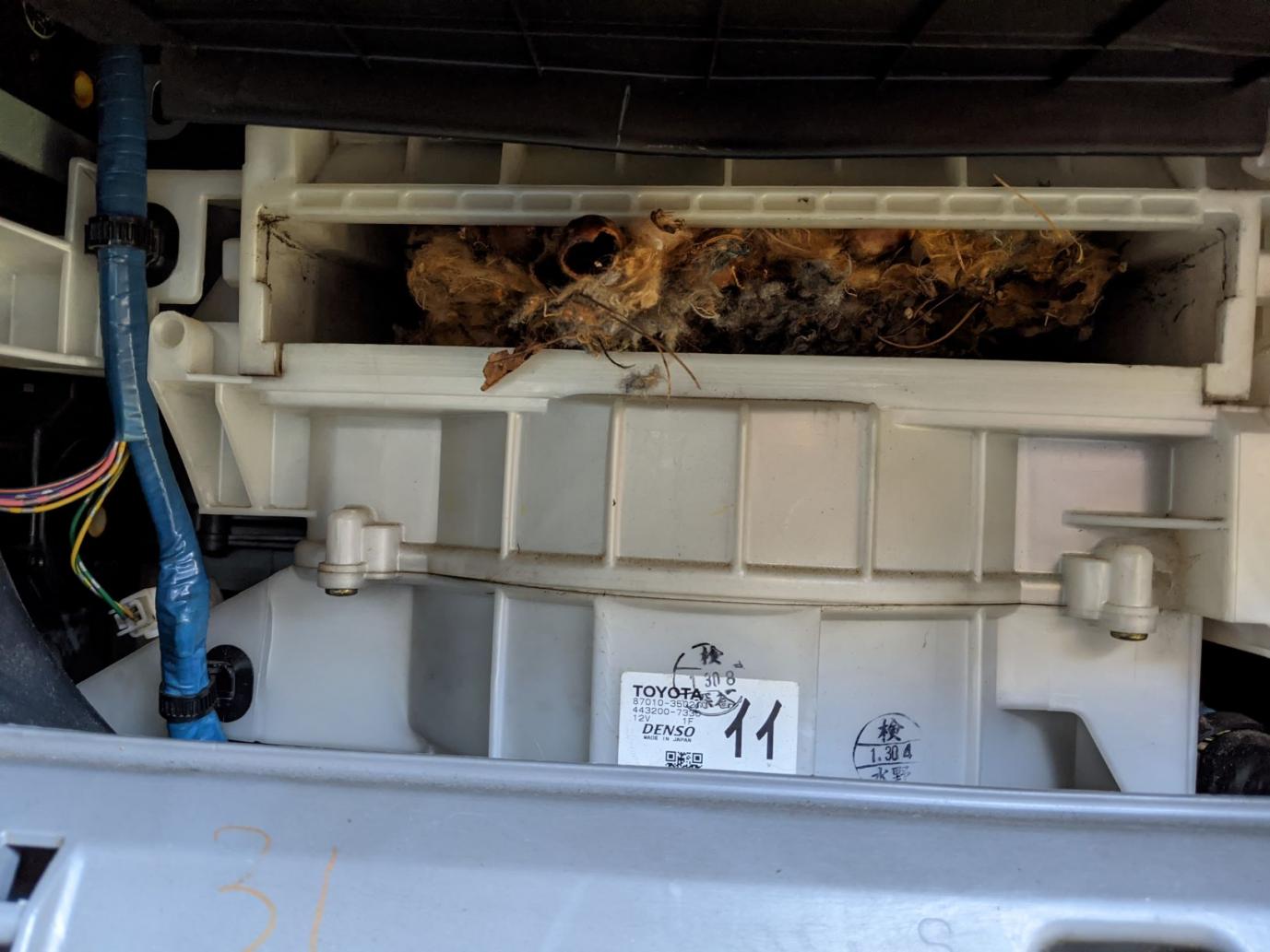

For me it was definitely the climate control air intake. The downside to parking outside near a bunch of oak trees. Oh the horror...

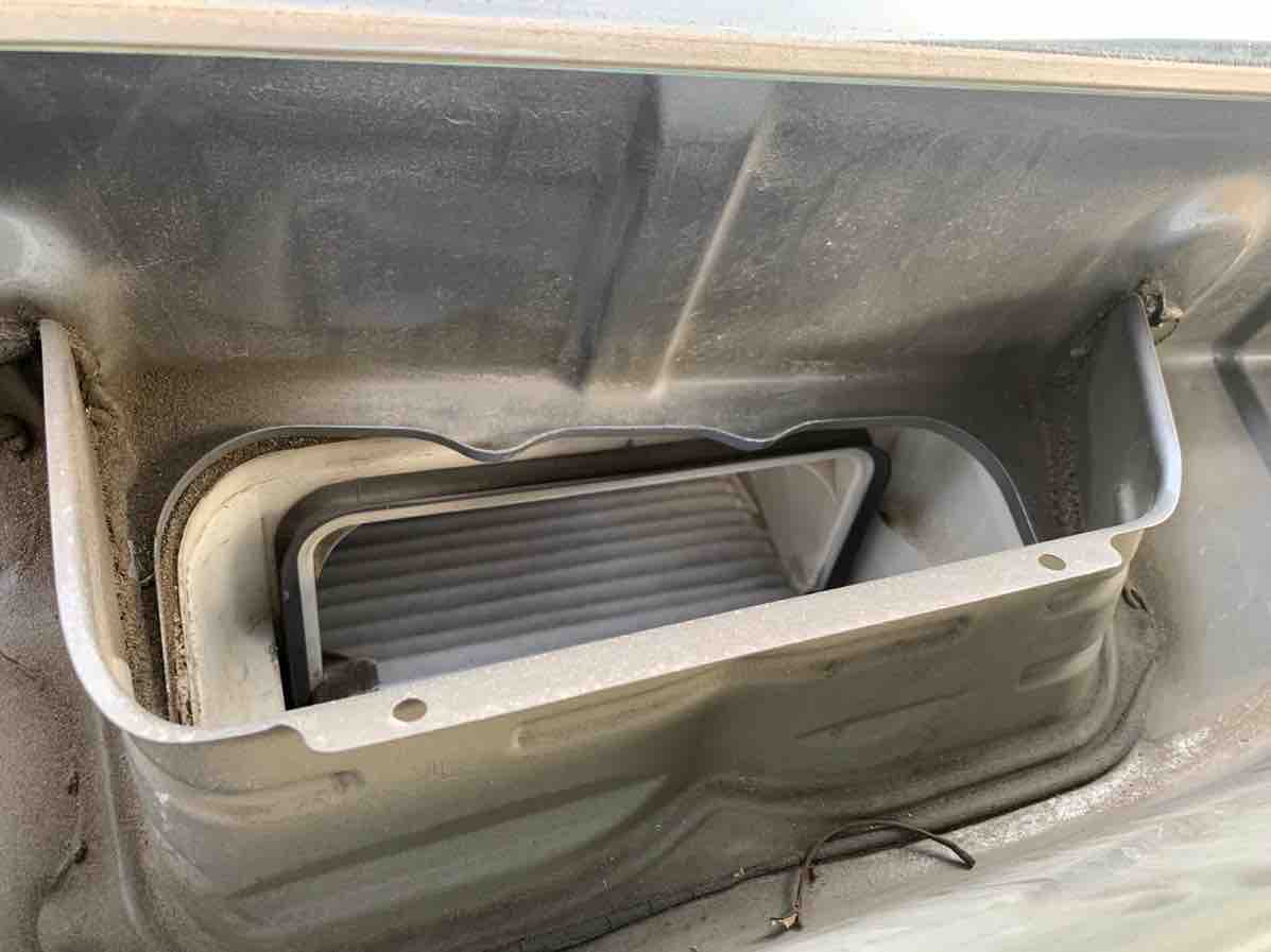

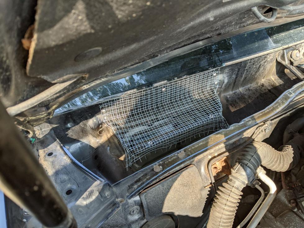

My fix was to put hardware cloth over the port into the cabin filter box. Just pull the wiper arms off and pop the plastic cover off and you can access it. I also put hardware cloth over the holes on either end of the area under the plastic cover where the wiper motor assembly resides, as that entire area was a mouse nest in our RAV4.
Quick edit as I know this will be judged harshly otherwise: I do check this filter every year. This happened over a single winter.

Did the “anti chipmunk” mod today just in case.

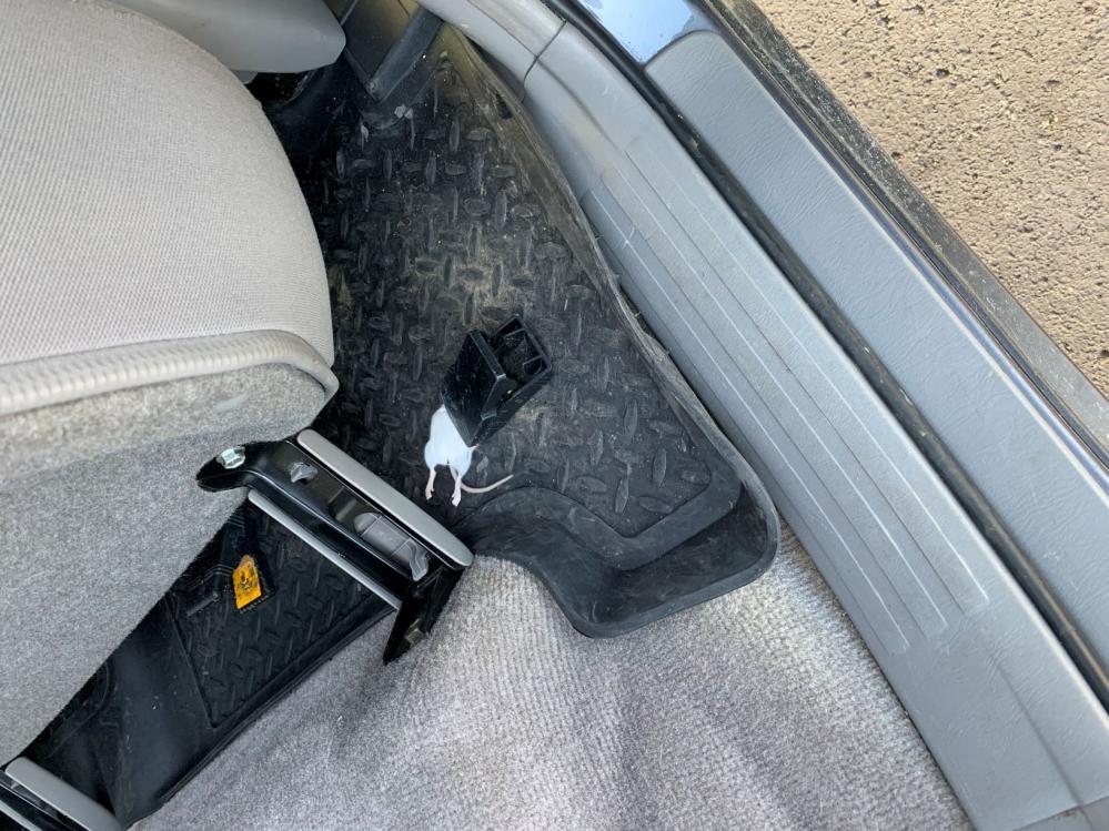

OP back...
Caught second mouse in a trap last night.
The mouse is white??
Somebody needin' to feed a snake is goin' to the pet store and throwin' extras in your 4R.
Or is this a case of Munchausen Syndrome By Mouse?
:lol:
Nah, that's the poor thing's undercarriage. He was a typical gray-brown mouse. Must've flipped when the trap snapped on him.

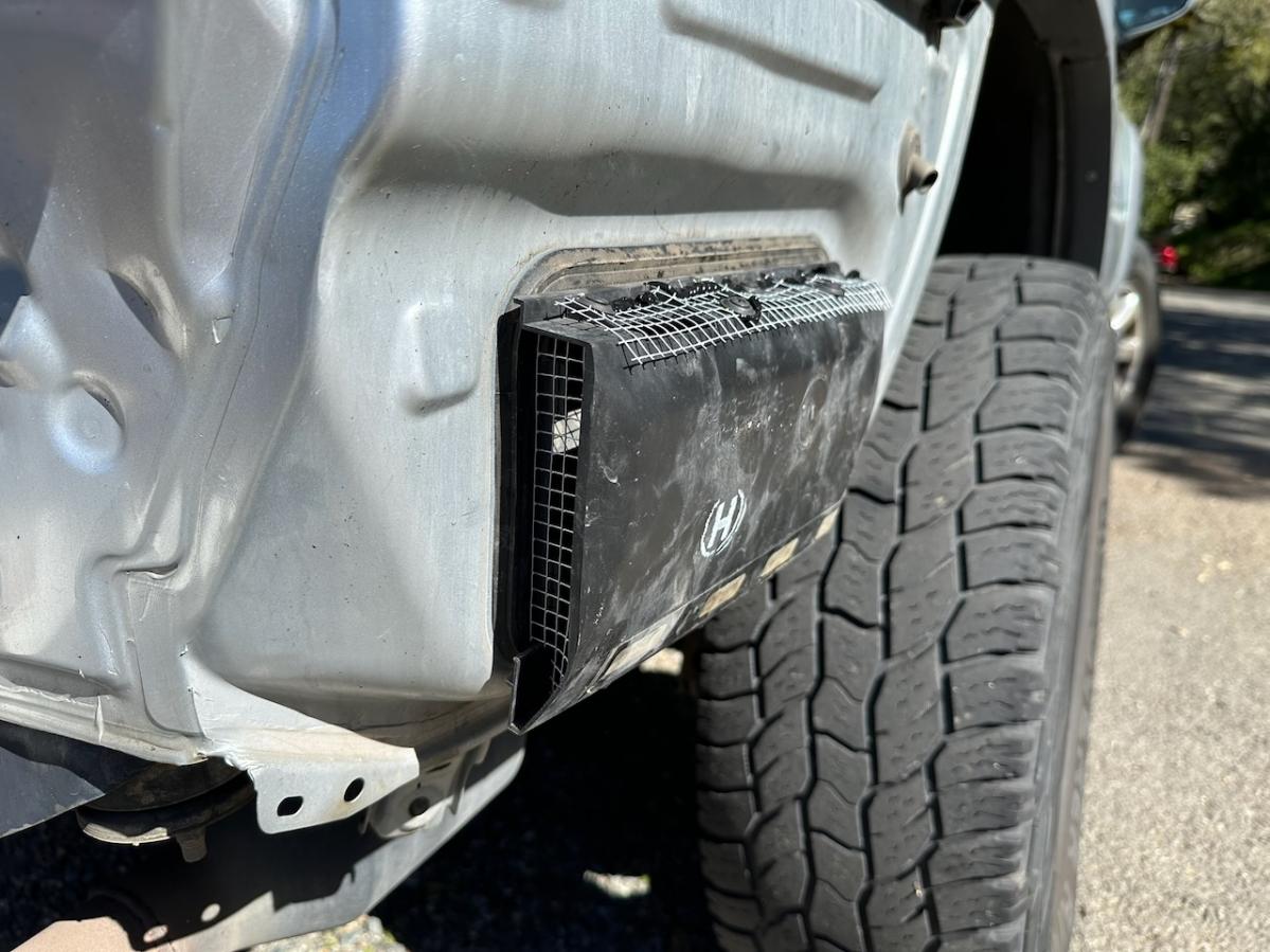

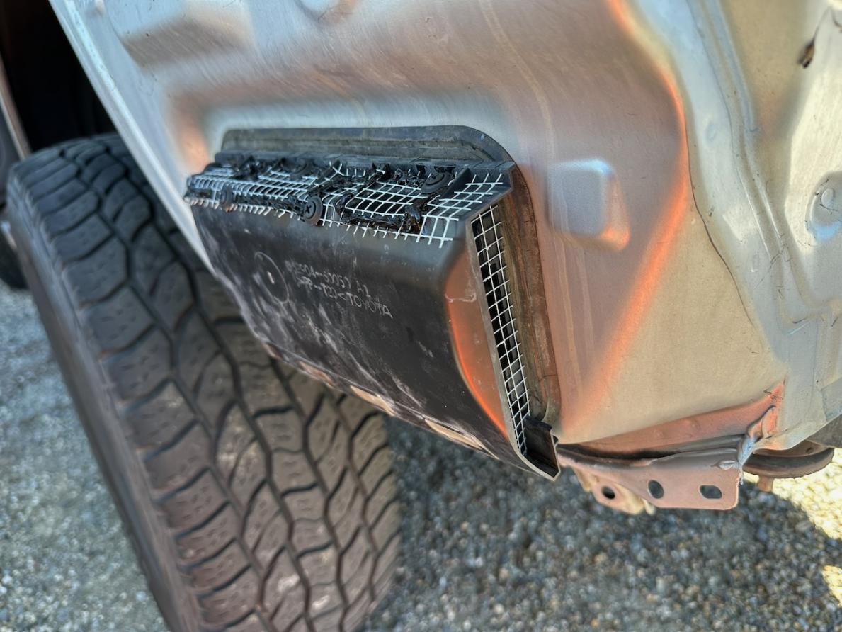

I've been fighting this for the last year or so. This past summer i sealed off the cabin air intake the same way others in this thread did and it seems to have worked.
Although they still camp out in my engine compartment and make a mess but they aren't chewing the wiring

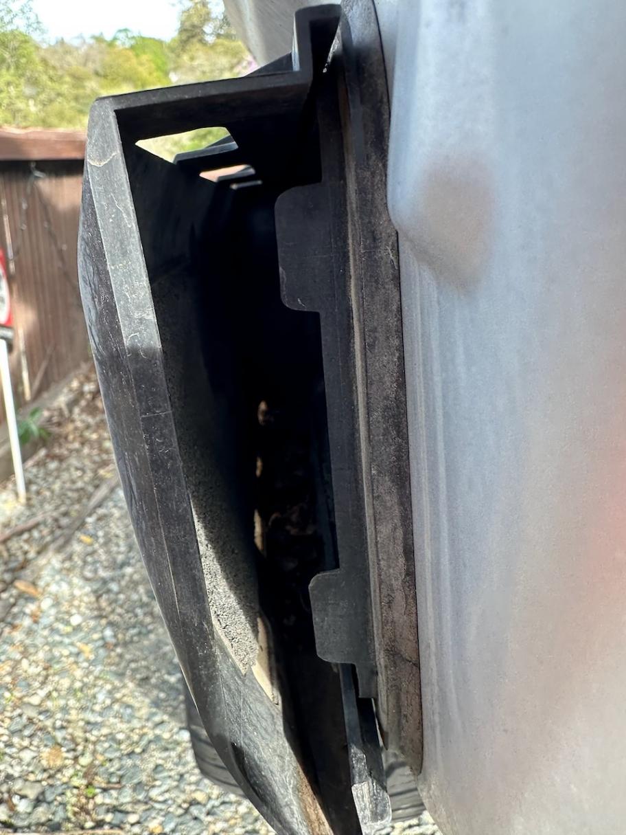

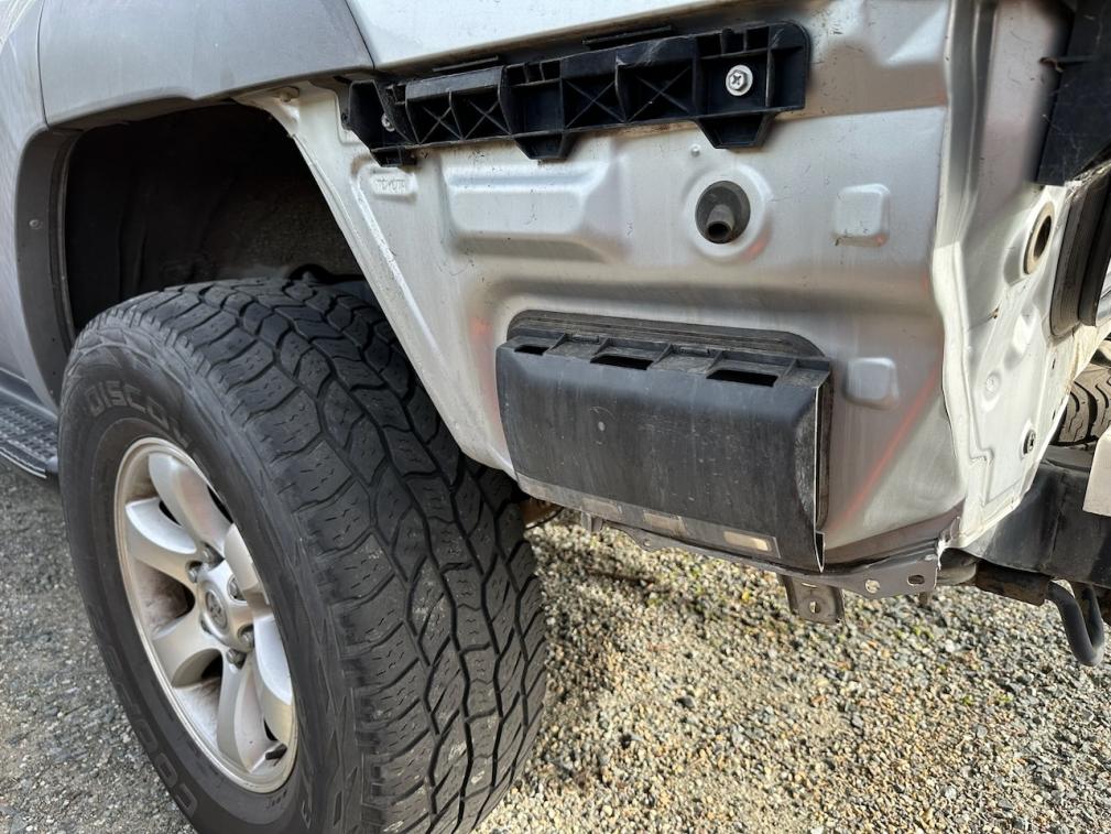

The past winter they've been getting into the car again and i was pretty sure it was those air baffles under the rear bumper. This weekend i pulled the bumper and figured it out. I posted this to a reddit thread about the same. Those baffles - at least on my 4th gen - are wide open to mice. Fortunately they're also pretty easy to seal up.
In case you need to replace them the baffle part numbers for 4th gen are:
(L) 62904-35021 (R) 62903-35020. The new ones would be just as open to rodents and they're pretty expensive parts - i was quotes ~$175 each from my local parts desk.
I was able to clean them both up and secure them for about $10 (i had to buy the right screws). A few scraps of hardware cloth, screws, and silicone did the trick.
If you do this the baffles are really easy to remove, just push down on the top a bit and the clips that hold it in place will release and you can pull it out. It doesn't take much force.
https://www.reddit.com/r/4Runner/comments/1puuccg/4th_gen_cabin_ingress_options_aka_mice/
