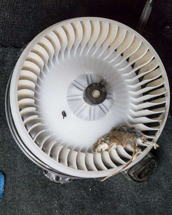

If it chews all the way through the filter, this is what happens next:
