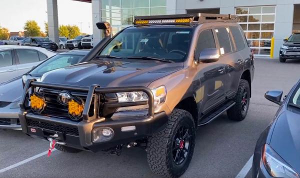

Switch over to my LC is complete (still need to install my skids and a few rear suspension tweaks):

Thanks. I have not written up the modifications this time thru (lost track of how many trucks I've built over the years and I'm building a FJ40 concurrently), but have a fairly extensive photo library/documentation of what I've done. I did a few things different than on my 4Runner:
- went OME instead of Icon (adding Trail Tailor or Total Chaos rear arms)
- trying a Front Runner rack (quicker, cheaper, and more accessories than Gobi)
- dual battery install using Redarc BCDC (might still add a Blue Sea ACR)
- installed/hid switch pro control in overhead sunglass holder
- added a rear fuse box and several accessory plugs in bottle jack location
- re-geared to 4.3's to compensate for the bigger tires and weight
- ARB's front and rear :cool:
- BudBuilt skids and Slee sliders (LC after market products WAY fewer than 4Runner offerings)
- ARB front bumper (aka "deer deflector")
- LRA 12.5g aux tank
Other stuff like tires/wheels get changed like shoes/socks :nod:
Let me know if you have any specific questions.
