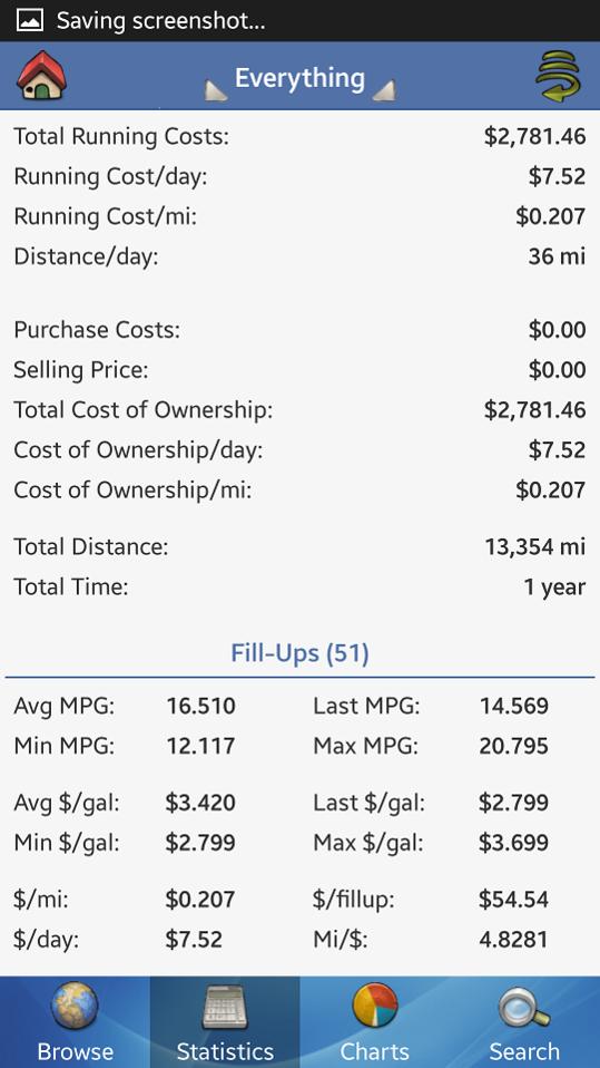

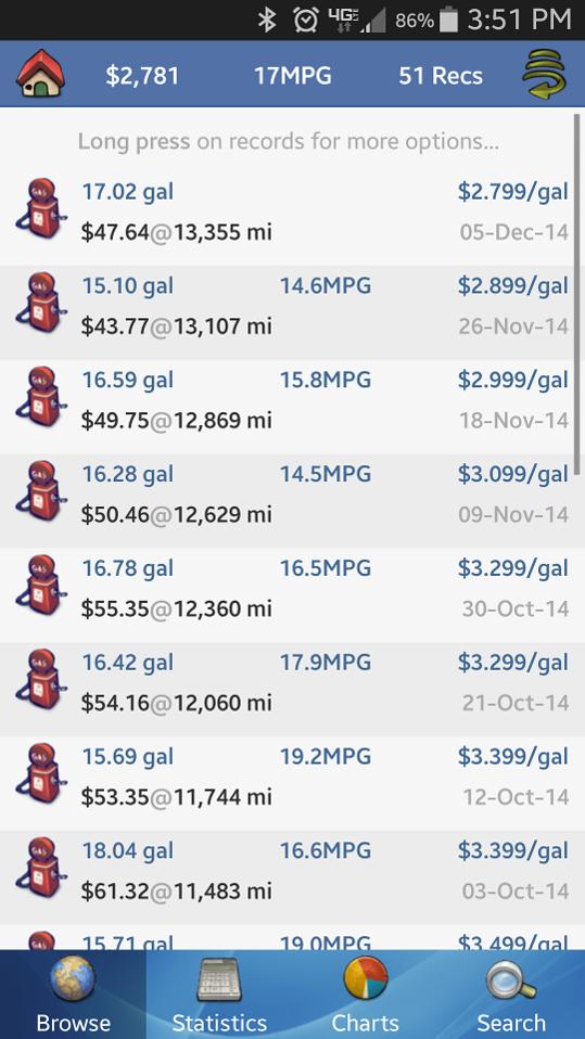

If you're wanting to track MPG have a look at Fuelly if you have a smart phone. There's probably some other free smart phone apps too.
stats
