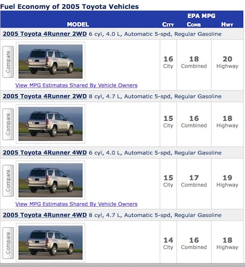

How about the EPA estimates? These are always inflated due to ideal driving conditions etc but give people a starting point.

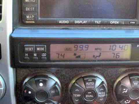

On second thought I think my lie-o-meter is 100% accurate.

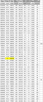

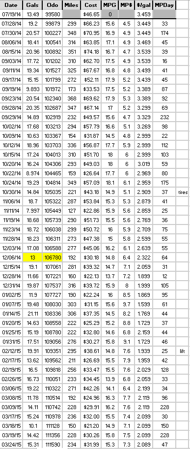

being the engineer i am...i have records from every vehicle i have owned, every fill up since '05! below is a shot of my '05 v8 4runner. notice the tire (265/65/17 street tires to 265/75/16 duratracs) made over a 1.5 mpg difference. the icon lift that replaced the sagging suspension doesnt seem to have changed the MPGs much at all.
i work 3 miles from the house, so if i do not do a lot of field work, i do have lower MPGs.
Also notice i like to look at things at a MP$ (miles per dollar) aspect. yes this is always fluctuating due to gas prices, but it gives me a way to estimate how much a roadtrip will cost in gas, for example.

Do a six point trailing average column and graph it to see the difference in summer versus winter gas. Pretty eye opening. I did it for a few guys over in the 5th gen section. As long as you have lots of good accurate date you can really get some good overviews.

I would have never made it as an engineer! I am OCD but my god, this is next level! Impressive record keeping to say the least.
