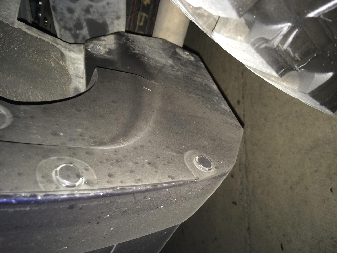

I trimmed mine off and kept the part that covers up the big hole. I bet you could buy a universal flat mud flap and trim it to fit.

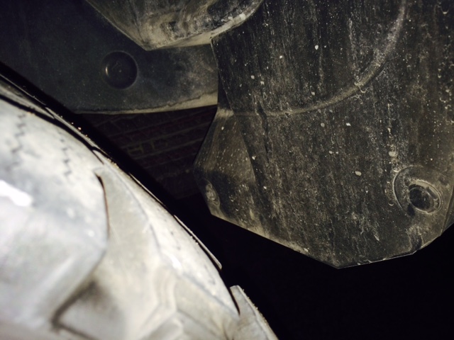

I did it last weekend. And it only cost me my time. Just studied the body lines and mudflap lines and determined the best place to cut. I removed them and put them on my work bench. I used a razor knife and straight edge and made a trace cut and then a final cut. The only watch out is the bottom edge if you want to maintain the same bottom attachment method. It is not a fatal error if you cut too high.

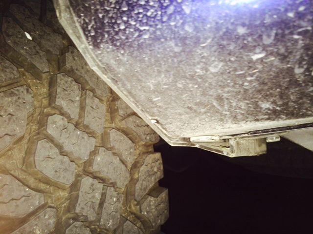

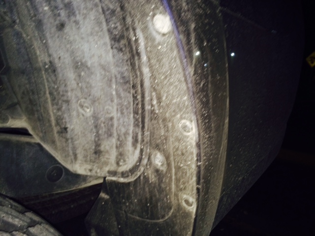

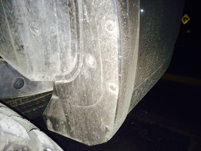

any more pictures?
I did this for free before I knew that you could buy them.

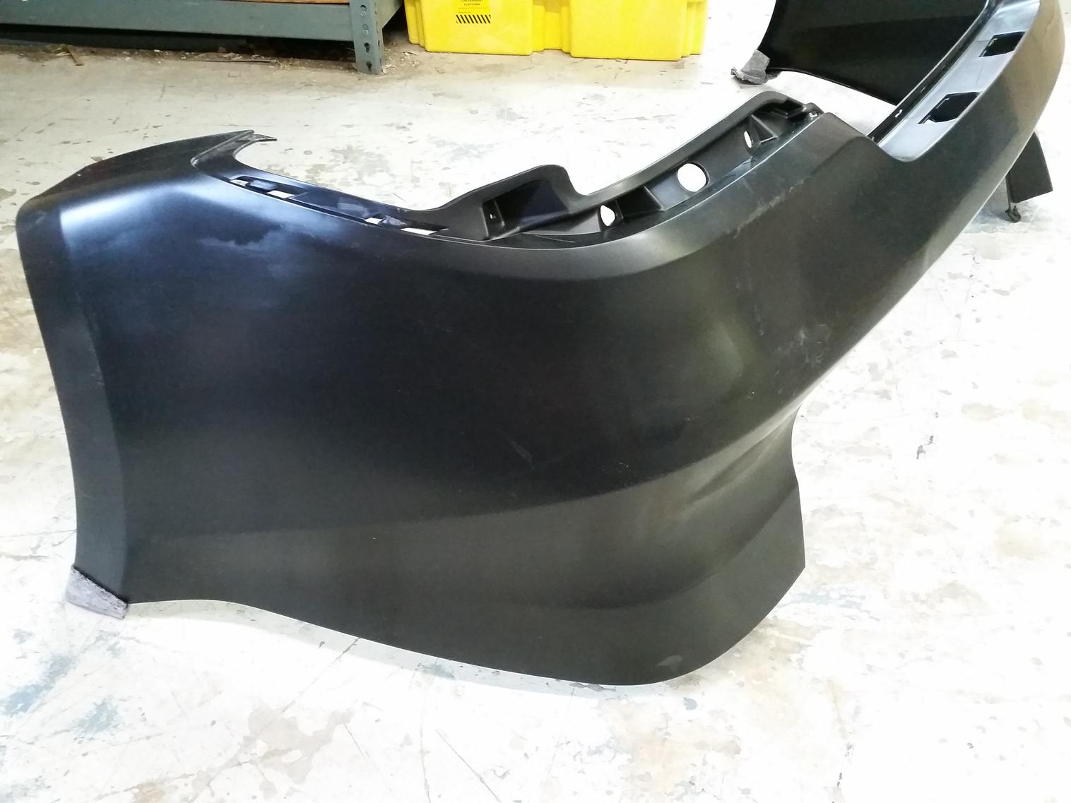

I ordered a replacement this time, but I'm already working on some delete panels that I can use for the next time it happens.... lol
Also, I found the perfect material to make them out of....
It's a defective/damaged bumper cover that was to be scrapped.
At the best price point, Free!!!
(I know not everyone has access to this solution)
The sides should be big enough to make a really nice flap delete panel in the future!
