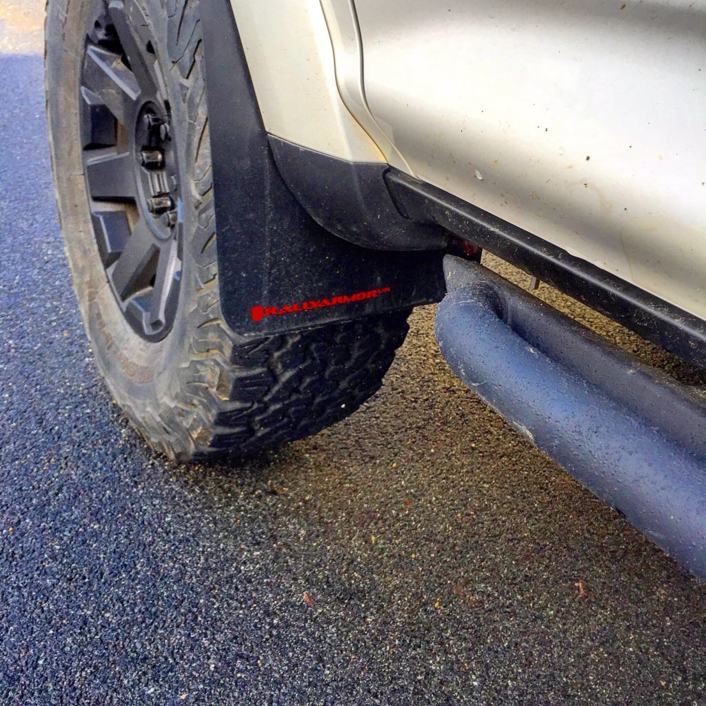

You could get rubber mud flaps. Less likely to get ripped off when off-road and still provide protection for your fenders/rockers from rocks and debris

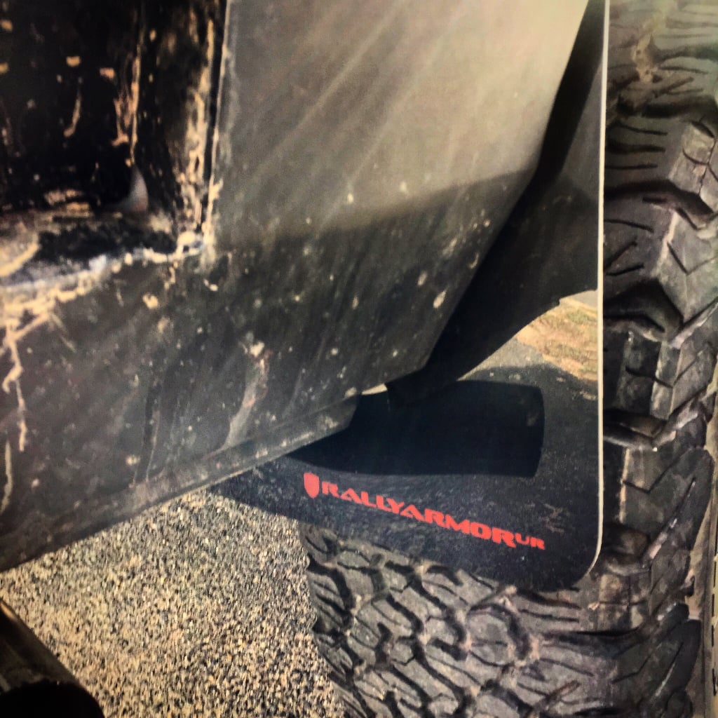

Here is a better picture of the front mud flaps. My stock ones got destroyed off-roading.
The Rally Armor flaps are soft, right? That might be a good compromise for mine. I took the plastic flaps off after a rear one grabbed the ground and pulled my bumper cover off.
The Universal Basic are the lightest ones, but they make heavier ones also.

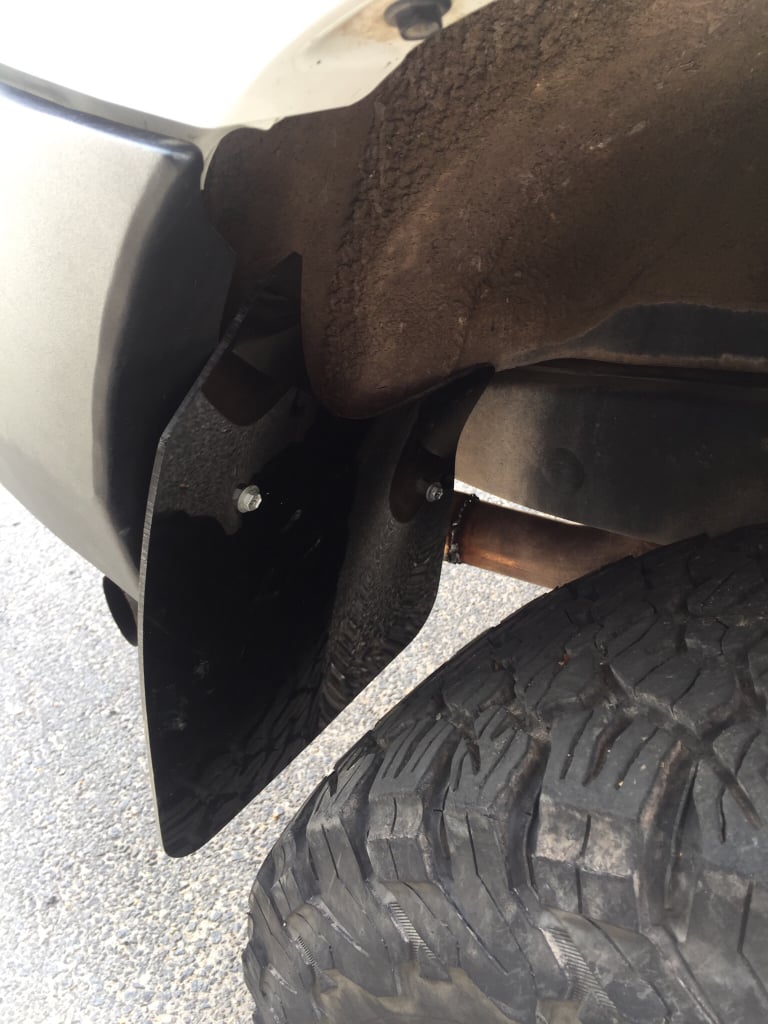

I purchased the fiberglass re-enforced about 5/16inch thick mud guards for the front. reason is the stock ones are 1.5inches too short. also these are about 1 inch wider than toyota ..
made a pattern to properly drill holes in the new mud guard used all the OEM fasteners . then used some sealer so no crap gets behind the guards works really good not much slop on the running boards. cost $25usd..
THESE WILL NOT BREAK ! Toyota toy plastic .
Yes, I like them because they take a beating on the trail and bounce right back to shape.
