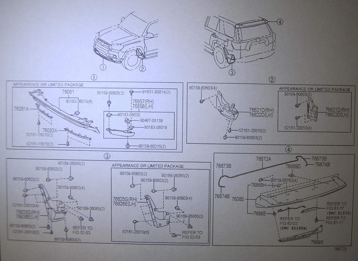

Thanks to SR54RUNNER10.
He e-mailed me a pdf img file of what appears to be the parts catolog page of the factory mudflaps for the Limited/SR5. Not verified but looks very promising.These are different then the sheet and part numbers I have for the TE so they might be them.The pdf file is too big to post on here and I don't know how to shrink it. It's 825kb and the max is 130kb to post.
We need a Adobe pdf expert who I can e-mail it to to post up the pic. Pm me your e-mail address if you can do it or want to try to do it. Or when I get home I can take a photo of it and post it that way.
i wonder if they are color keyed?
OK...This was sent to from a SE Toyota dealer for the mudflaps for Limited/SR5 .Thanks goes to forum member SR54RUNNER10 for those that need them :thumb3:
You will have to verify at you local dealership parts counter but according to this they do exist now.They might be SE Toyota only and then would have to be ordered thru them.
If you want a copy of the pdf.img of it to print for yourself,just pm me your e-mail asking for it.Here is a pic of the print .
