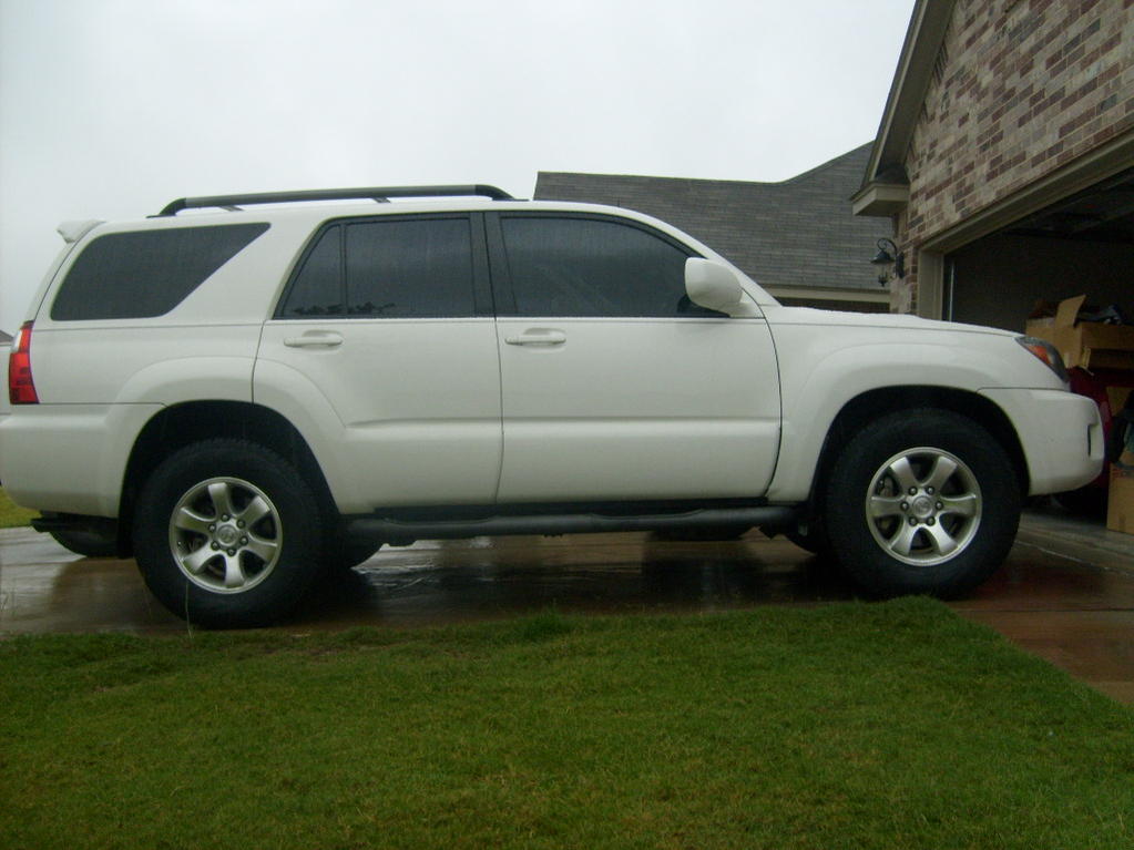

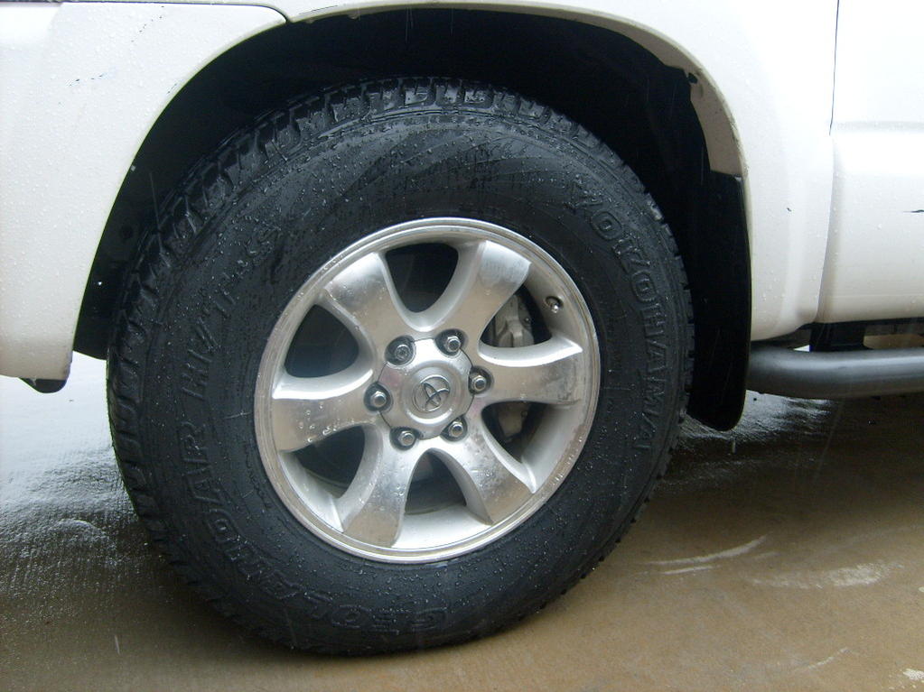

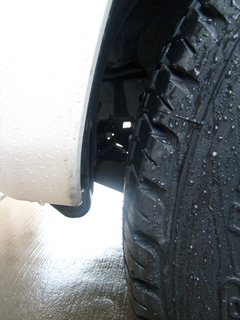

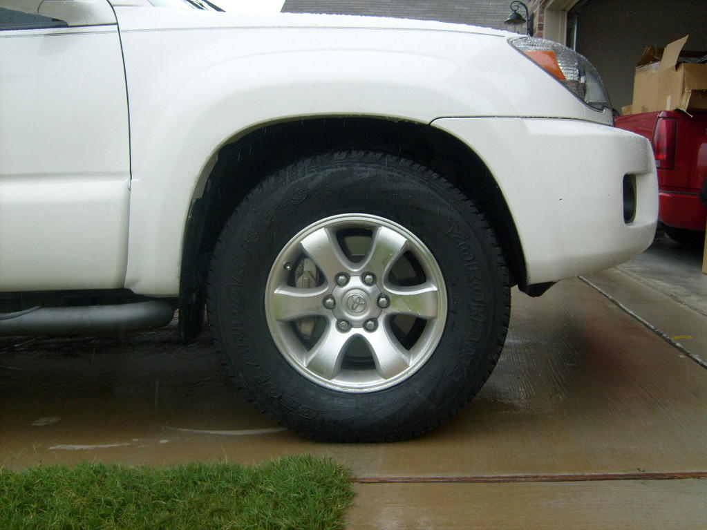

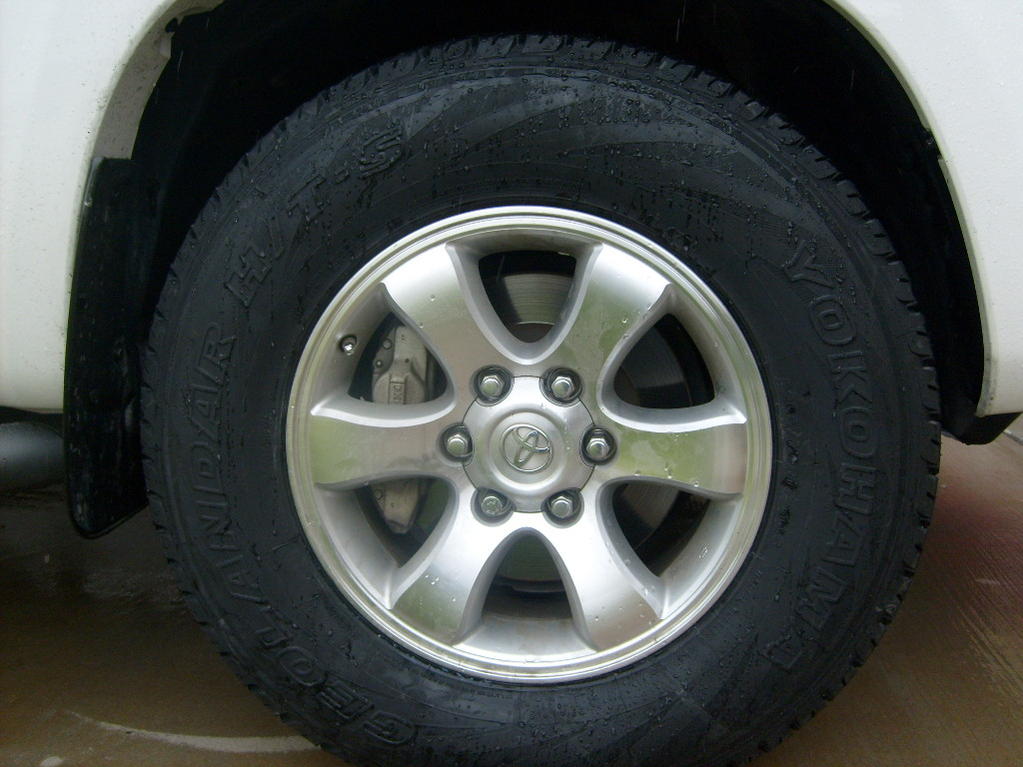

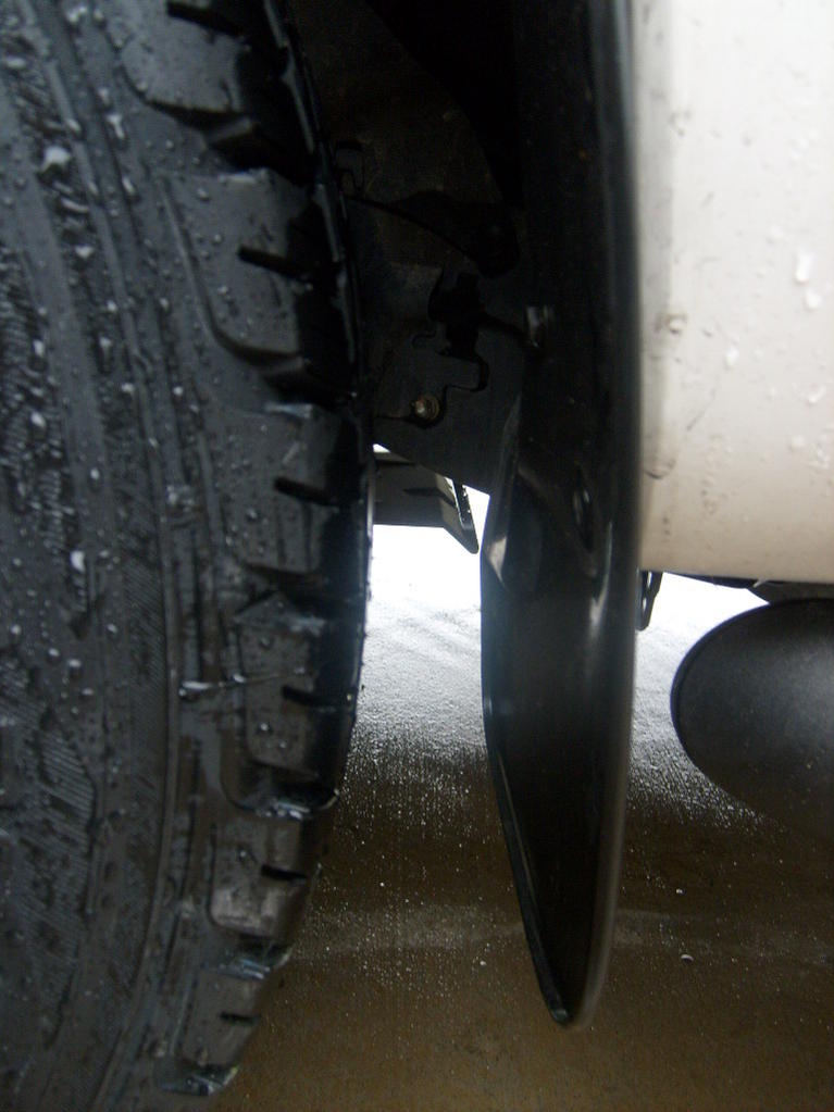

I just got home from Discount Tire and put 265/70/17 Yokohoma Geolanders on with stockwheels 10.7 wide 31.8 tall . No lift no spacers. They look, ride and handle great. I went to an open parking lot and did full turns in all directions and no rubbing what so ever. So you should be good. Sorry the pics are bad its raining like crazy here.
